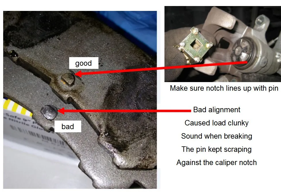

loud metal clunking sound when braking
just a heads up you guys, I didn't properly align the caliper notch with the pin on the rear pads and got a loud metal clunking sound when braking.
I disassembled the brakes and found out what I did wrong, I didn't do the slight adjustment to line the caliper notch with the pad pin..
Is there a visual mark of where the notches have to be ? It's a blind mate when the caliper goes over the pads so there's no visual to make sure they are exactly lined up... thoughts ?
Thanks for posting this, just completed the procedure (the wrong way) so I'm saving this for future use.

my notch did not line up with brake pad pin and I kept hearing a cracking noise when I pressed the brakes as I drove.
It turned out the notch was slightly un-aligned with the pin as you can see in the photos.
No where in the Mazda procedures does it say that you have to press the brakes before disengaging the maintenance mode, but it defintely makes sense to do it..
