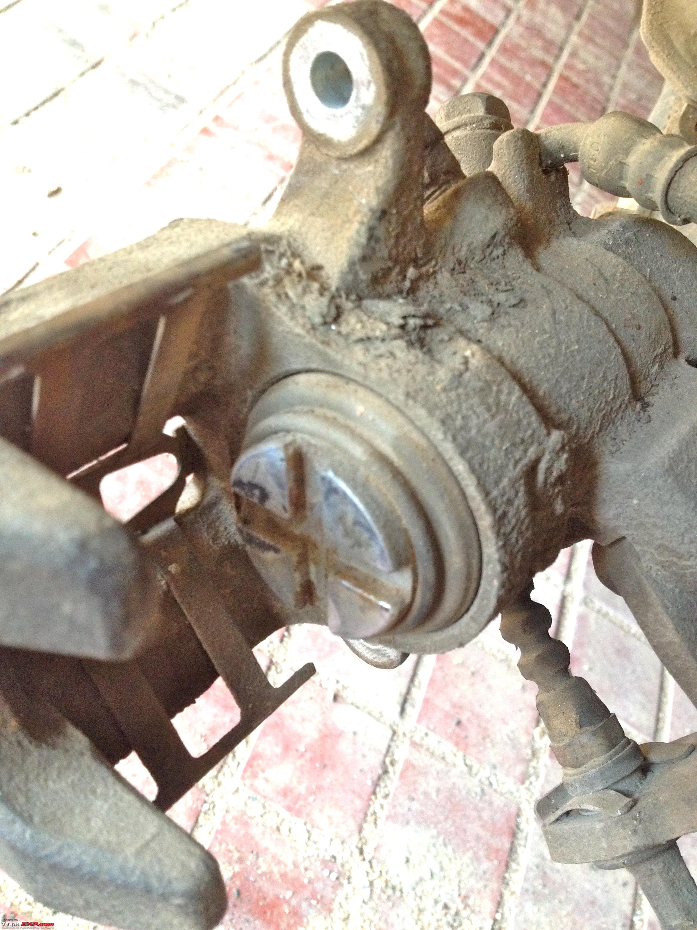

I own a used car, and just start chaning the brake the first time in my hand for this car.
I saw the rear piston plastic ring twisted. Does it mean it was previously pushed back by rotating the piston ? Or the piston will twist in its normally usage but for some reason the plastic part doesn't twist the same time as the piston twist and ending twisted plastic ring?
I want to fix it but not sure if it's ok to twist the piston for the purpose.
"plastic ring" ? do you mean the dust boot around the grooved piston ? this is a picture I got off the internet, it's not the CX-5
but you get the idea

I assume you are refering to the rubber seal (also called dust boot) around the piston. If your's is twisted, the previous owner may have rotated the piston instead of using the maintenance mode to push it straight back, it's best to try to "untwist it" since it may be stretched and causing too much stress that it may rip as the piston gets extended
you can try to un-twist it if you unbolt the caliper assembly and press on the brake pedal to extend the piston out so it's easier to straighten out the dust boot, use a flexible plastic spatula so to work the dust boot back to normal, use the plastic spatula https://tintdepot.com/product/shank/ and be careful not to cut or rip the dust boot rubber OR I think you solution might be better, engage maintenance mode and that will back off the motor and you can rotate the pistion back and "untwist" the boot, this is actually in the manual that once you engage the maintanence mode, you're allowed to rotate the piston. what year is your CX-5 ? only 2016-2019 have maintenance mode.

It's a 2016 CX-5. And yes, I am talking about the piston boot in picture.

It sound like I can enter maintenance mode, rotate the piston in direction to untwist the boot and also keep the notch pointing directly up, then push it back directly without rotate. Feel like it's a safer way without risking cut it.
Thank you for answering my question. Will try to do it later today.
Update - seems it improve braking a bit. Is it possibly the reason ?

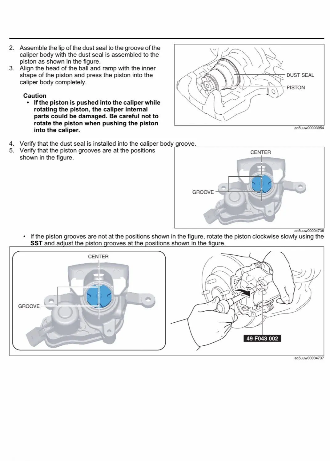

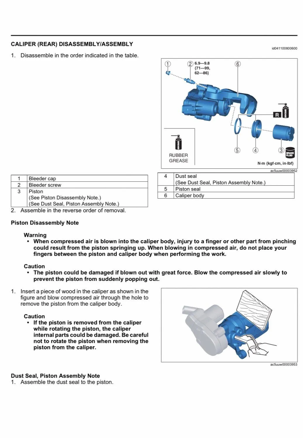

Here are 3 out of 5 files Anchorman had posted in another thread on rear disk brakes with EPB for 2016+ CX-5 from Mazda CX-5 Workshop Manual:
DISC PAD (REAR) REPLACEMENT
CALIPER (REAR) DISASSEMBLY/ASSEMBLY:
ELECTRIC PARKING BRAKE MOTOR GEAR UNIT REMOVAL/INSTALLATION:

The purpose of the maintenance mode is to back off the EPB motor so you can compress the pistons easily (DO NOT TURN THE PISTON)
I can see how it is tempting for someone who doesn't know about these EPB to use the Lisle 28600 tool to try and turn them back in BUT IT WILL NOT WORK, the motor will not allow it, forcing it with a C-clamp will break the EPB motor. The motor must be backed off first with the procedure below.
