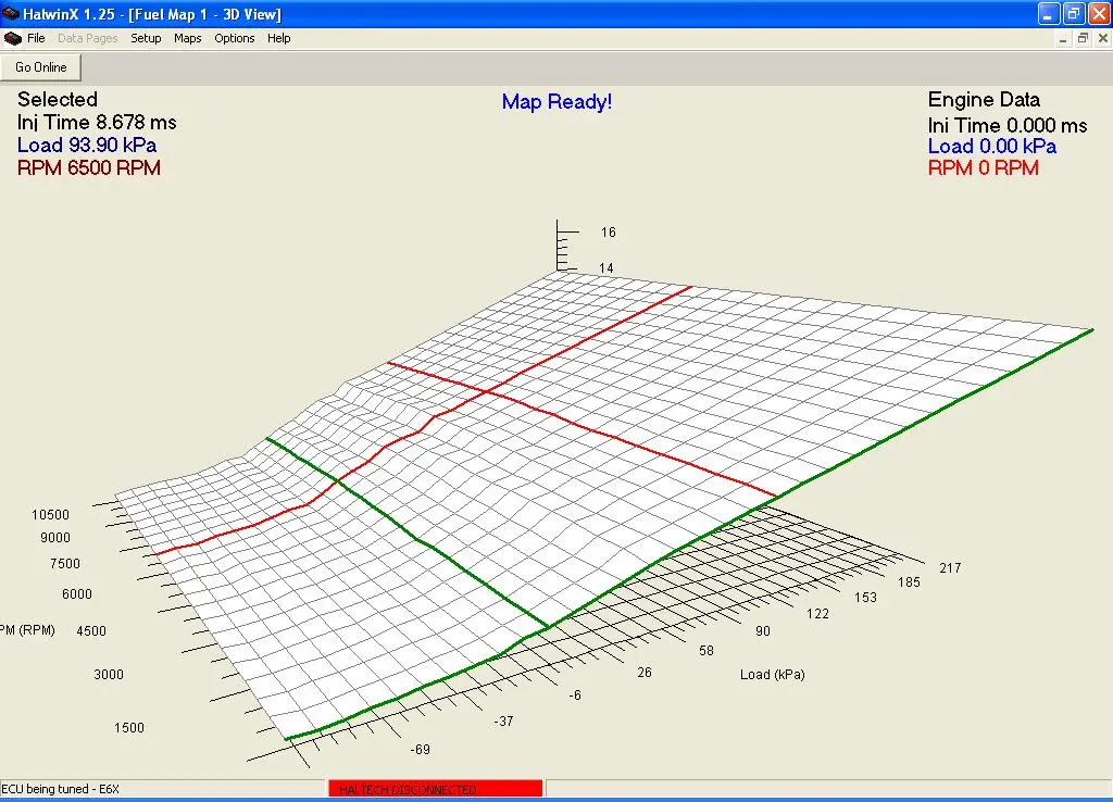

Well, here is the latest update..

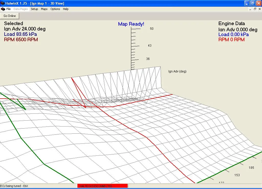

Tonight, I did a few runs around my neighborhood. That ended in me getting my car to rev even better! So what prompted all this? On the way home, just as I was getting into my neighborhood there was this silver V6 Mustang (pre-2005) that was in front of me. I got behind them, and they took off. I would take off too and just catch them without downshifting..lol! So we get to a stoplight, and turn left. He takes off, but slows down as I was speeding up, so I shot past him. I slowed down, and went to 2nd gear. He lined up, and took off, and so did I. He was right next to me. As I shifted to 3rd, he jumped a fender, but as soon as I got into 3rd, I pulled it all back, and when I shifted to 4th, I pulled a car on him before I had to shut it down. If the road had been longer, ownage was emminent for the Mustang...lol! Well, during all this, I noticed at the top of my RPM range, that I had a flat spot where my accelleration would fall off, and my tach needle would get sluggish. I circled back and did a run, and noticed that I got a slight cracle, and my A/F ratio was too rich. Hmmm.. could being too rich be causing me some pre-ignition? You bet! I had spent all that time doing my ignition, that I had neglected to pay attention to the fuel map. So another run was done, and I watched my RPM's, my widband, and felt for the bogg and the cracle. Got it! after 5500, and right before 6000 RPM's, I get way rich, and get the flat spot. At about 63 kPa (9 PSI), I took out 2% of fuel at the 5500 and 6000 RPM ranges, and 1% at 6500 RPM's. Then I took out 1% for 73 kPa at the same RPM ranges. Damn! I went for another run, and it PULLED across the RPM wall it was at previously without a problem. My exhuast actually woke up a little up top! Reminded me of a quiet S2000! Looking at my wideband, I would hit 12.2 on my A/F max, and it would level off just below 12. I'll post up the file and picture later.
I noticed in that range that I had to do a pretty significant decrease in fuel as well. I'm not sure what it is about the engines, but the dyno was showing very clearly that I was getting rich there, too.
The latest..
My timing now drops to 22 degrees at the lowest point IN boost now. My BEGI side mount intercooler can't handle it over 10-11 PSI without detonation. Below are the pictures of my fuel map, two pictures of the ignition (one zoomed in, and the other zoomed out), and the Map file.
I run roughly the same for timing... bit more in a lot of cases... but yeah... mid to high 20's in boost at 10-13 psi.
Hey,
Hit me with your map for comparison if you are so inclined to do so.

Well, I went for another drive last night, and again, my BEGI SMIC is KILLING ME!! The intake temps went up to 55 c (131 F)! (flame) When that happened, *PING!* Steve, what are you intake air temps like. I actually got out and felt the hot side of my IC, and it was HOT! The cold side was pretty warm. This was only at 10-11 PSI.
Pat, your IC sucks... PDH's charge temps are 35C in ambient 95F on the highway, and about 43C while idleing in the same heat
