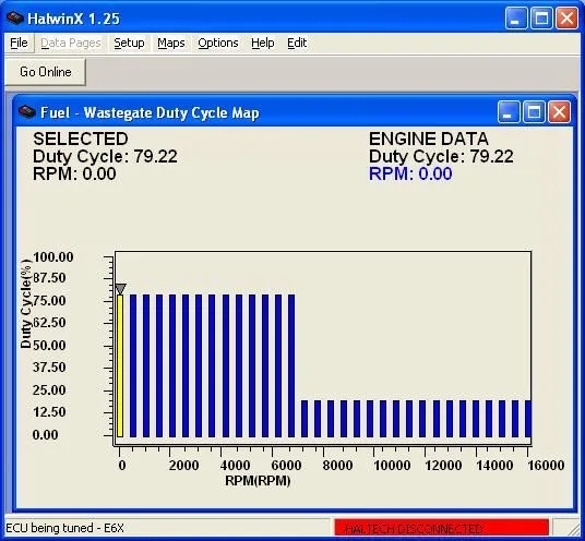

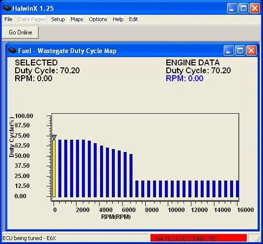

Well tonight it seems my car got slower, or JDM Sam's car got faster. On my old tune, we were even. It also didn't help that he started in 3rd gear, and I started in 4th...but I still hung with him anyhow. We did discover something else, or rather I was actually made to notice that my boost needle kept spiking up and down, and was not steady. Since Sam has experience setting the duty cycle on other boost controllers. So we put a decline trend on the duty cycle towards where my topend is, and I notice the boost holds steadier now. It "feels" slower due to it not spiking up and down giving me that extra push, but that was also counter productive to my engine reving smoothly. Got some ping I guess due to the boost holding steadier now. Making some small adjustments to my map. Here are the pictures of my wastgate map before and after below:
