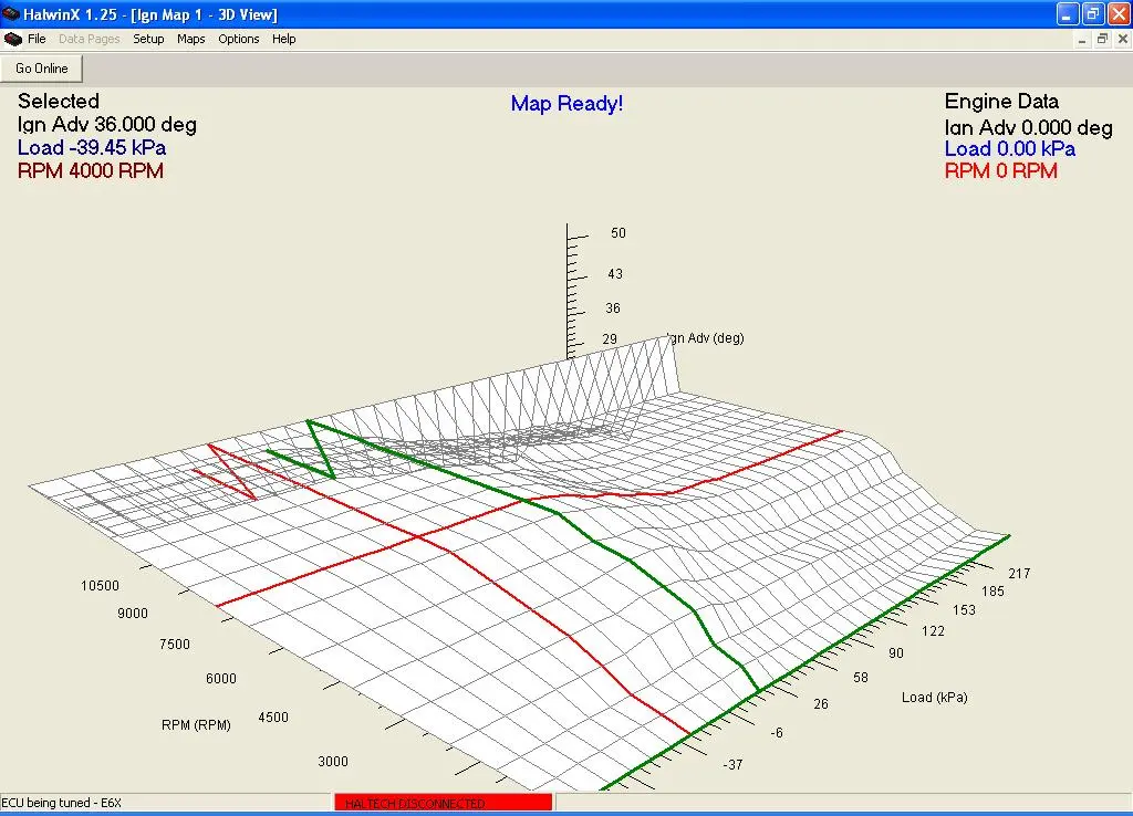

After last night's cooler weather tuning, I decided to do some 100 F degree weather tuning this afternoon. I found some more pining as the temps got hotter. I adjusted the timing down accordingly in the 10-12 PSI range, and around 4000-5000 RPM. You will notice a small "creator" in that range. I also changed my max timing from 35 degrees to 36 down low, out of boost. So now the map is a degree taller. Here is the result:

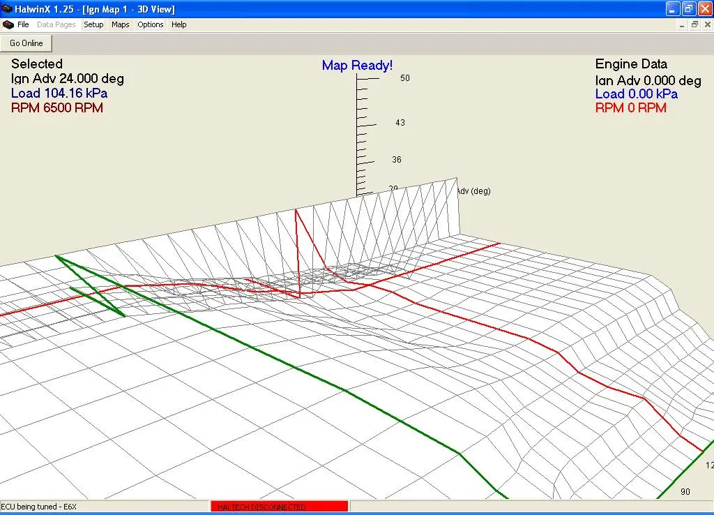

Ok, so this morning on the way back from Plano, I decided to take a detour down Preston, and into the heart of Dallas to test some low-gear timing. As a result, I once again modified my timing, and pulled a little fuel out, but oh man, THE TORQUE!!! It is smoother, and better than ever before. My current turbo kit is good for about 250-270 HP (efficiently) I found after research (phonecall to Corky Bell), so I may turn the boost up on the T3 while am waiting to kick ass with my version 1 Mental Addiction Sleeper Kit which will be capable of the 300 HP I seek. Until then, here is my current map:

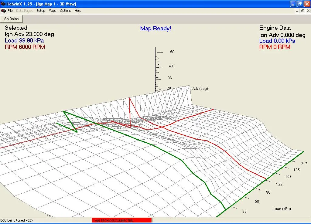

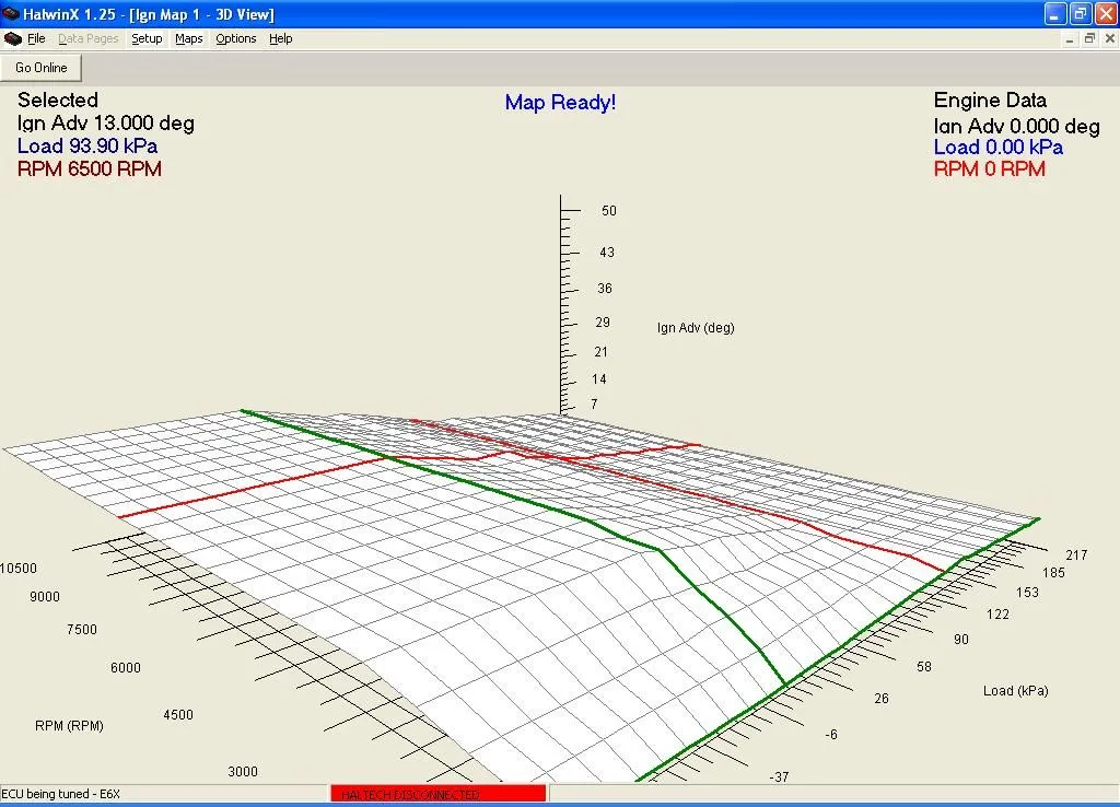

Let's compare this to my previous map, and you will see why I had to retune this biatch. Now click the picture of the map in the previous post, and then click the picture below. You will notice with the picture below, that the high plateau is at 21 degrees! THAT'S LOW! (eek2). You will also note at the top left the point where I am on the map shows 6500 RPM's, and 93.90 kPa (13.61 PSI). So what that means is at redline, and at my highest boost, I was at 13 degrees of timing!! OMGWTFBBKMMMMMMBYE!!! (eek2)(eek2)
More changes tonight. At 6000-6500 RPM and 13.6 PSI, I am at 23 degrees of timing. I also smoothed out the map in the lower RPM ranges into boost (where I'll never drive). I got some rave reviews tonight about the way it pulls now.
(alright)
