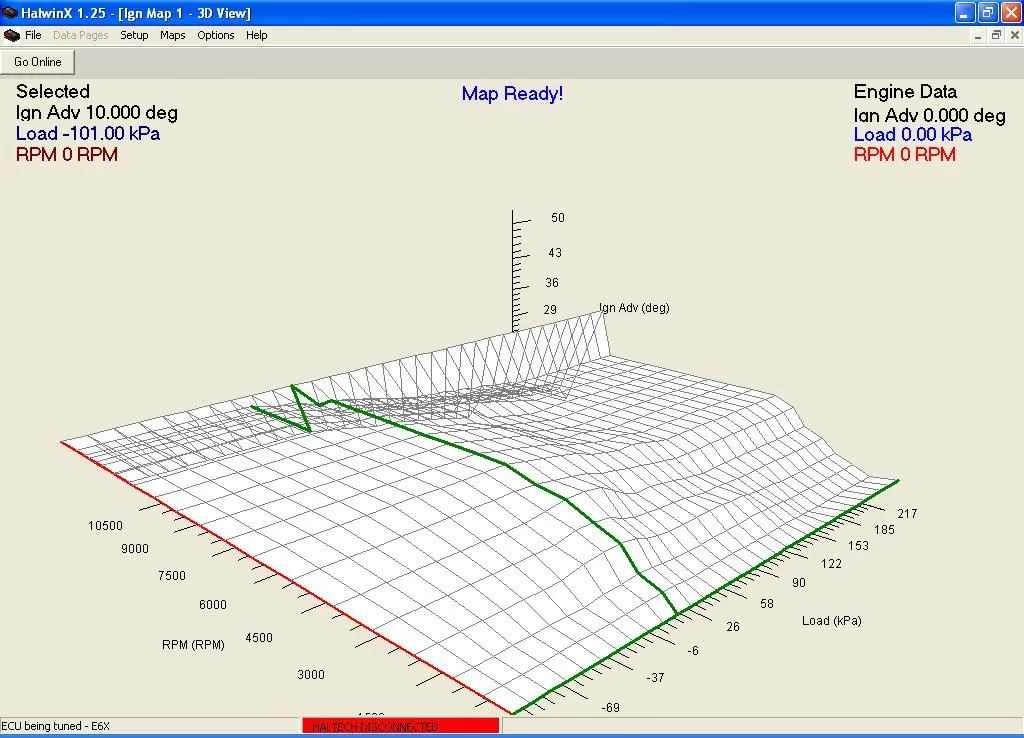

Good luck on that exhaust leak. After I made the previous post, I went outside to start retuning. I suspected a vaccum leak, so I hunted that down and found that. The nipple on the manifold that would be connected to the cruise control if I had it had a vaccum cap on it. It split, so it was leaking. I went to AutoZone, and got a new cap, and a vaccum clamp and fixed it. After the tuning started, I found that I got better response by bringing up the lower end timing (outa boost). After taking care of that, I found that when I punched it, I got ping in the 4500-5500 RPM area. The timing was brought down in that area, and the pinging stopped. I then pulled over and smoothed out the map some. Tunning in 3D is SO much easier!! Below is what the result in the form of the file, and a picture of the ignition map:
Agreed on 3d tuning. It's a little weird at first getting the hang of it, but it works well. I strongly suggest studying the hotkeys via the help menu to find out what keys do what. The Home key, for instance, will align the center of however many points you have selected, to the actual conditions of your engine, which makes it handy for quick tune adjustments at cruise and such. It can also be used to target a specific point whether you are accelerating or whatever, just hit Home, and when you pull over you can make the adjustments.
I'll do ya one better. The space bar key does the same thing as the home key. I learned this while watching Steve Kan do my initial tune. It is a lot easier than reaching for the home key. That's what I used last night, and every other time. (thumb)
