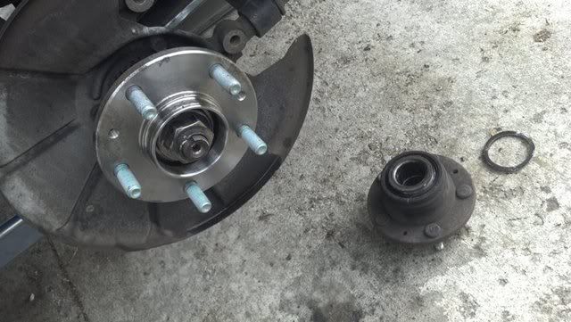

Replaced the drivers side rear wheel bearing/hub assembly. It was definitely grinding when I pulled wheel and caliper off. Everything really is a pretty easy job. Bad news, I think the other rear side is shot. I know these tires are noisy but I'll have to check it. And I know the passengers side rear caliper is sticking just. When I get the new pads in I'll see if I'll need to rebuild the caliper or not. I hate P5 rear calipers...
I also replaced the pass side motor mount so I can ship mine to Cres so he can fill it. I got some AWR mounts from Steve (UCMP3) about a month ago so now I have all four full AWR motor mounts. I didn't expect the side to give me this many more vibes, but I don't mind at all. I might do the trans mount tomorrow or just wait until July for the swap.
Anywho, some quick pics;
New and old.

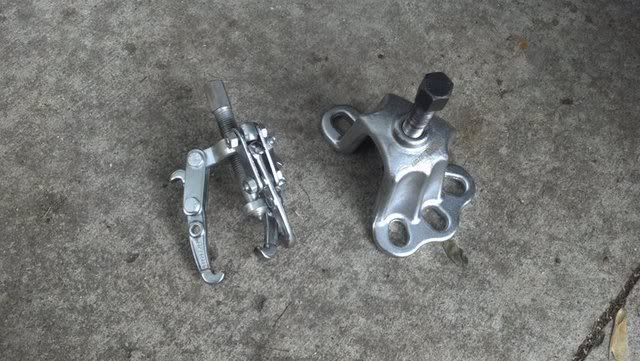

And I strongly suggest renting a hub puller and 3 claw puller to get the hub and bearing off. Made it so much easier. :)
So... I have a 3 jaw puller of various sizes in my tool box... I've been meaning to buy one of the axle pushers.
passenger side rear bearing is relatively new, however the passenger front has never been changed. I believe i also swapped the right rear caliper out because the original had a leak.
