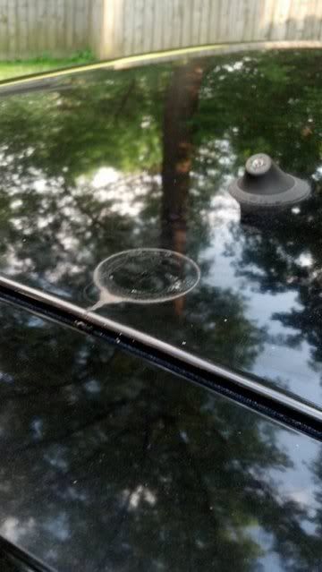

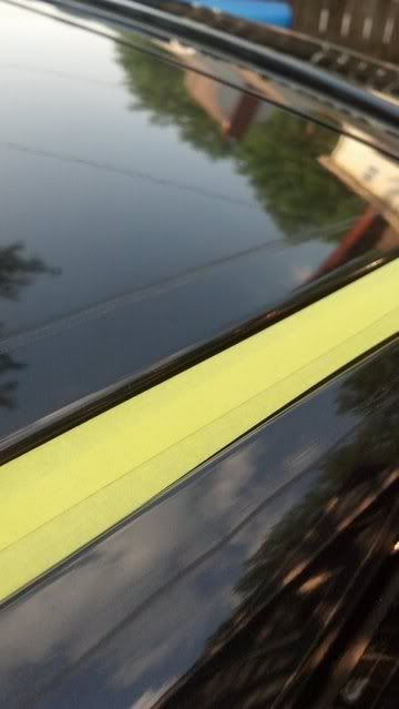

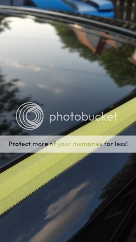

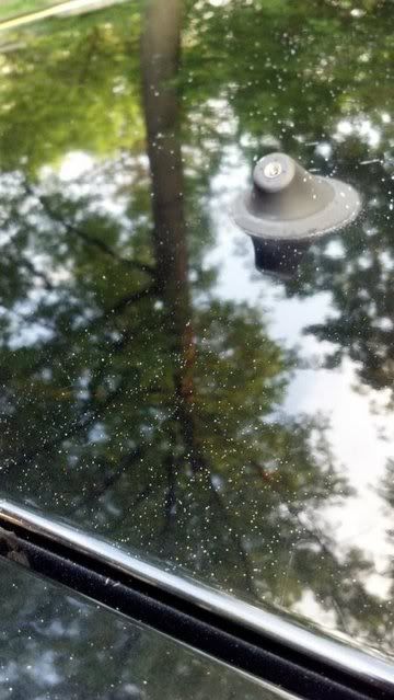

I asked Josh to buff out the roof rack and Sirious radio antennea blemishes today. He did a splendid job, as always. Thanks again, guy! (2thumbs)
Apollo helped. Kinda...
Before;
After;
Before;
After;
