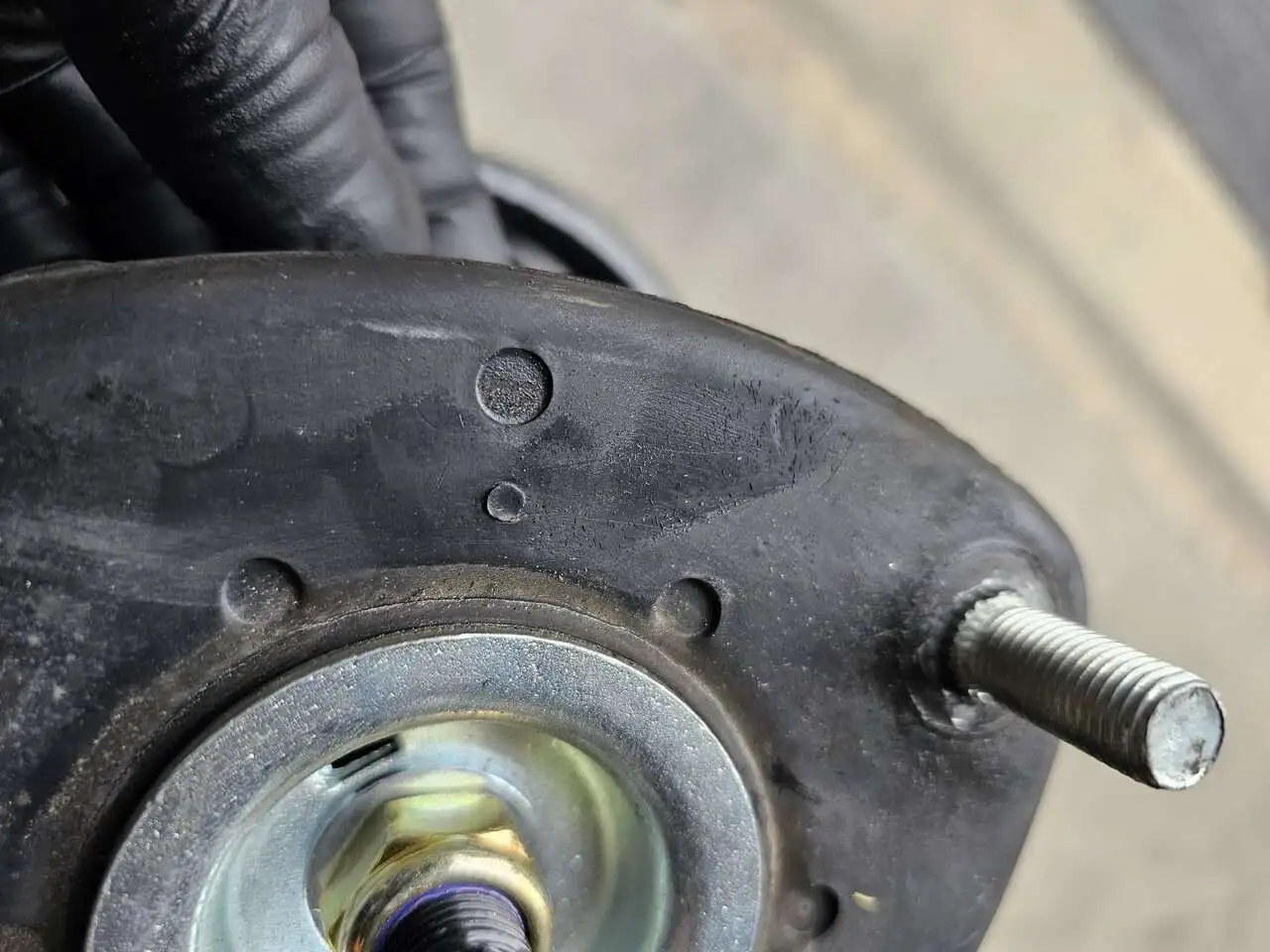

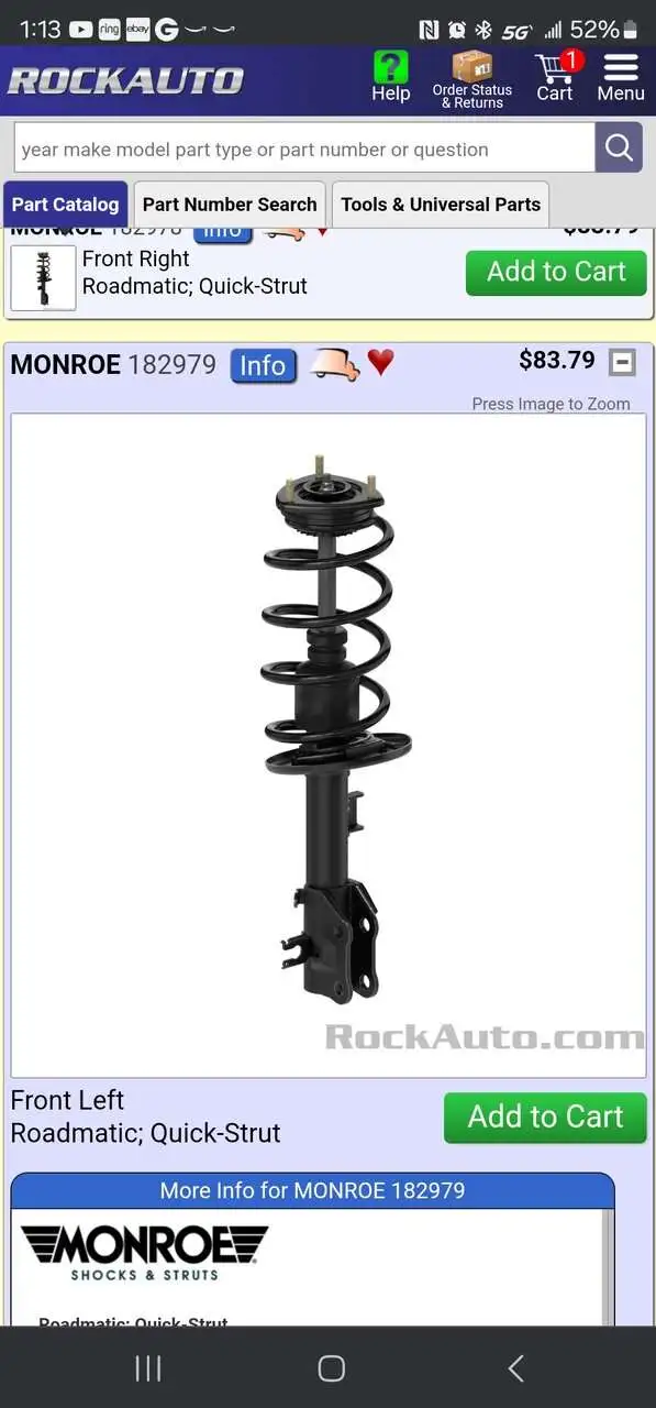

Anyone figure this out? I've been searching on the Internet for some information that I haven't thought of.
I've replaced ball joint, sway bar bushings and links (Moog, but I don't even trust those as the grease is just coming out and not staying in) inner and outer tie rod ends (Moog) and struts from Monroe.
I've replaced the struts twice (warranty). And there is still noise. Everything is tight as I checked multiple times. All my motor mounts are also replaced too. I can't not figure this out and it's driving me crazy.
If you look closely you can see the top hat rubbing against the bare metal chassis.

Have heard nothing but bad things about the Monroe quick struts.
I opted to just go with OE Mazda struts for mine. Still waiting for them to arrive.
Were the strut mounts replaced when the struts were replaced. Although I wouldn't go back to Monroe, I've had their Quikstruts twice on prior cars and their included strut mounts never made noise.
Yes it's the quick struts. Both times (rock auto). They come as one piece. But yes.
I'm just running out of options. Everything that connects to each other, is tight.
Top 3 bolts to strut tight.
Below that, the 2 lower bolts to strut.
The sway bar links, and bushings.
The inner and outer tie rods.
Then the ball joints.
Even brand new tires from Sam's.
And the knock is still there.
Sorry forgot to post.
187k
2014 CX-5 GT
