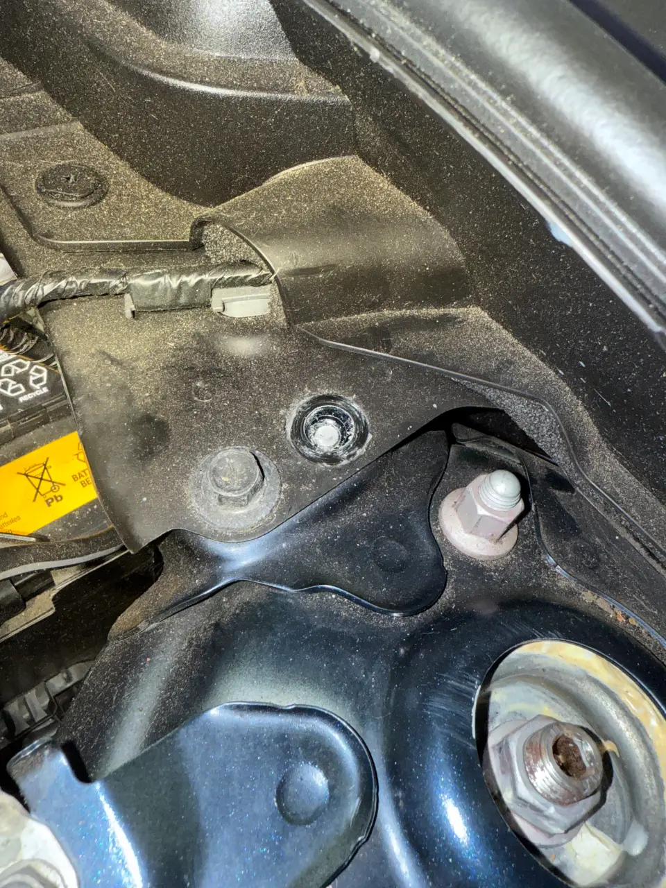

UPDATE: MY KNOCKING/CLUNKING IS FIXED. IT WAS THE CROSSBAR UNDER THE WINDSHIELD/next to strut mount bolts.
Scroll up to my previous comments/video for the sound/issue, I was 2 seconds from ordering new struts thinking it was the struts. I tightened the crossbar bolts as some others have noted and the knocking has gone away, so anyone else with similar sound, please try this. I can’t believe the number of hours I spent trying to diagnose and fiddling around with my strut (threw bunch of lithium grease at it) only for it to be the crossbar.
BAD NEWS: I snapped off one of the bolt while tightening it and the one next to it seems to keep turning and I’m afraid to cross thread/snap it too, so I’ve got more work to do.
Anyone know the proper torque spec for these 4x12mm bolts for the crossbar?

Thank you so much, crossbar/brace was the issue, can’t believe that being loose can make so much noise.

The snapped one hasn’t been replace, I snapped it but the thread part is still in the groove, so technically it’s tight right now, but obviously I’m gonna have to devise a plan to take that out and put in a new bolt.
The stripped one is just my speculation, I hand tightened and am not tightening it more.
As of now all 4 bolts are tight and no knock/noise. I’m planning to fix the snapped one and then also unbolt the other 3 and add loctite and retighten to torque spec (if I can find it).
All I did was tighten the 4 bolts and it fixed it, do try it to see if those bolts are loose, it takes 30 seconds. 12mm socket.

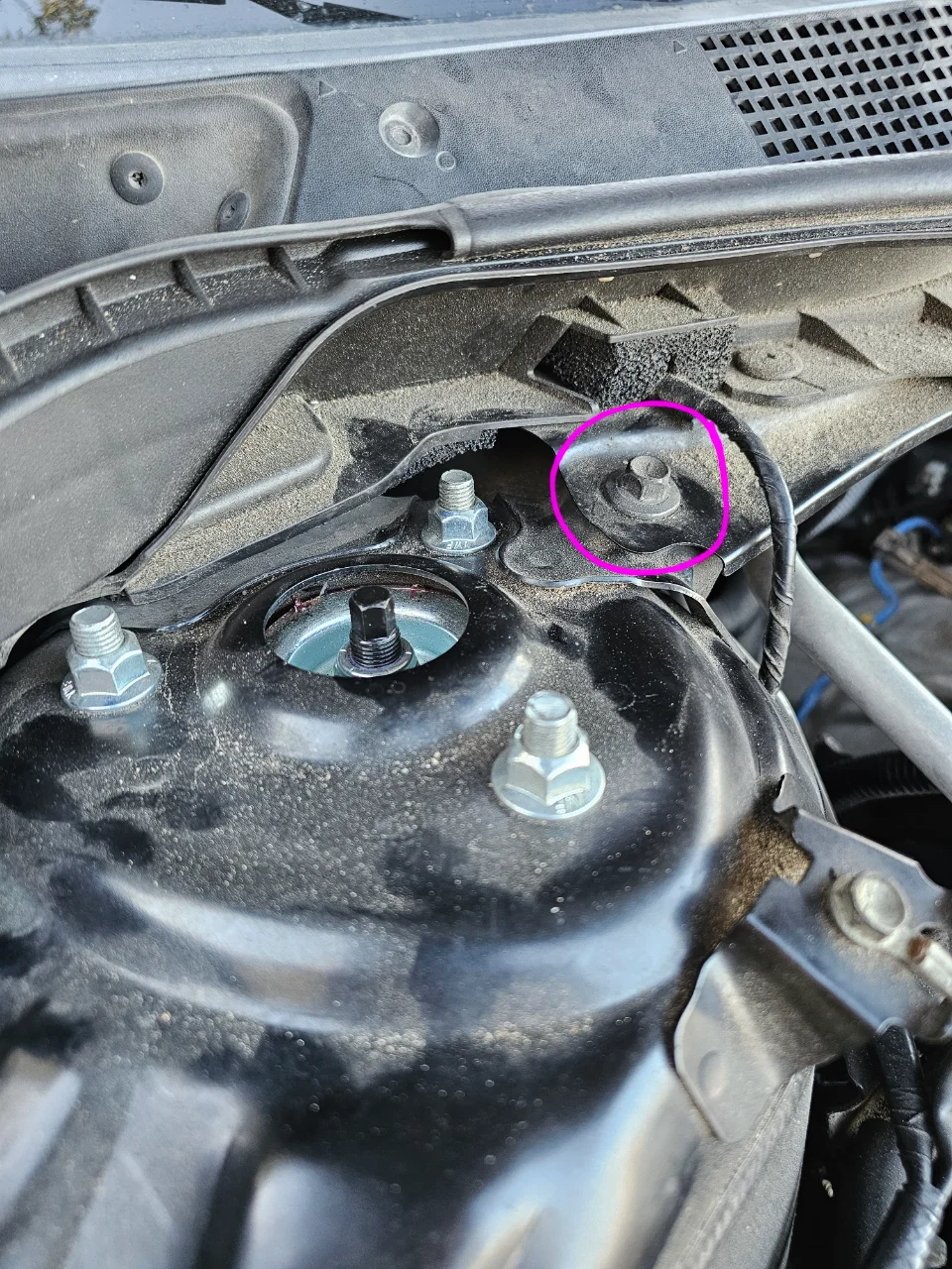

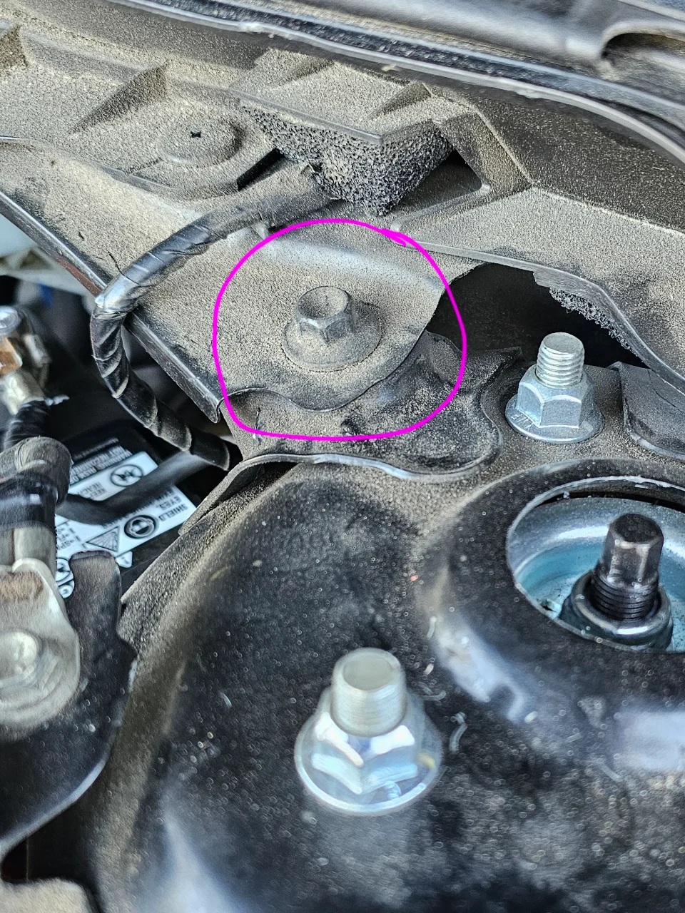

Well there you go.
So the driver side was tight but not tightened down it did like 3/4 maybe 1/2 a turn.
But the passenger side was loose. It took about 2-3 turns. I made sure not to over tighten it. But I got it tight.
I only have one bolt on each side.
I have a 2014 Cx-5 Grand Touring 2WD 190k.
Once I tightened them, I got in and took the route I normally take to work, but that route has fixed pot holes and dips small and big. I went over man holes. Basically the spots I know where the car did make that sound..
I did this twice. (I didn't go all the way to work, just out of the neighborhood).
It worked! I don't have the sound anymore.
200955 was correct. All the way.
