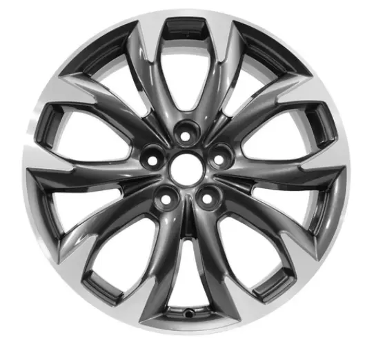

Just want to comment on the confusion about 16.5 - the changes were so ridiculously minor on the .5 it truly surprises me that Mazda chose to differentiate it.
It was just a few items that were moved to STANDARD instead of OPTIONS.
Example a 2016.5 Sport is different from a 2016: because it had a backup camera standard.
The Touring is the same....but got heated seats as standard. The GT...got Navigation as Standard.
I think the rims are different as well. I think some TSBs were solved also.
2016.5 GT Rims:
