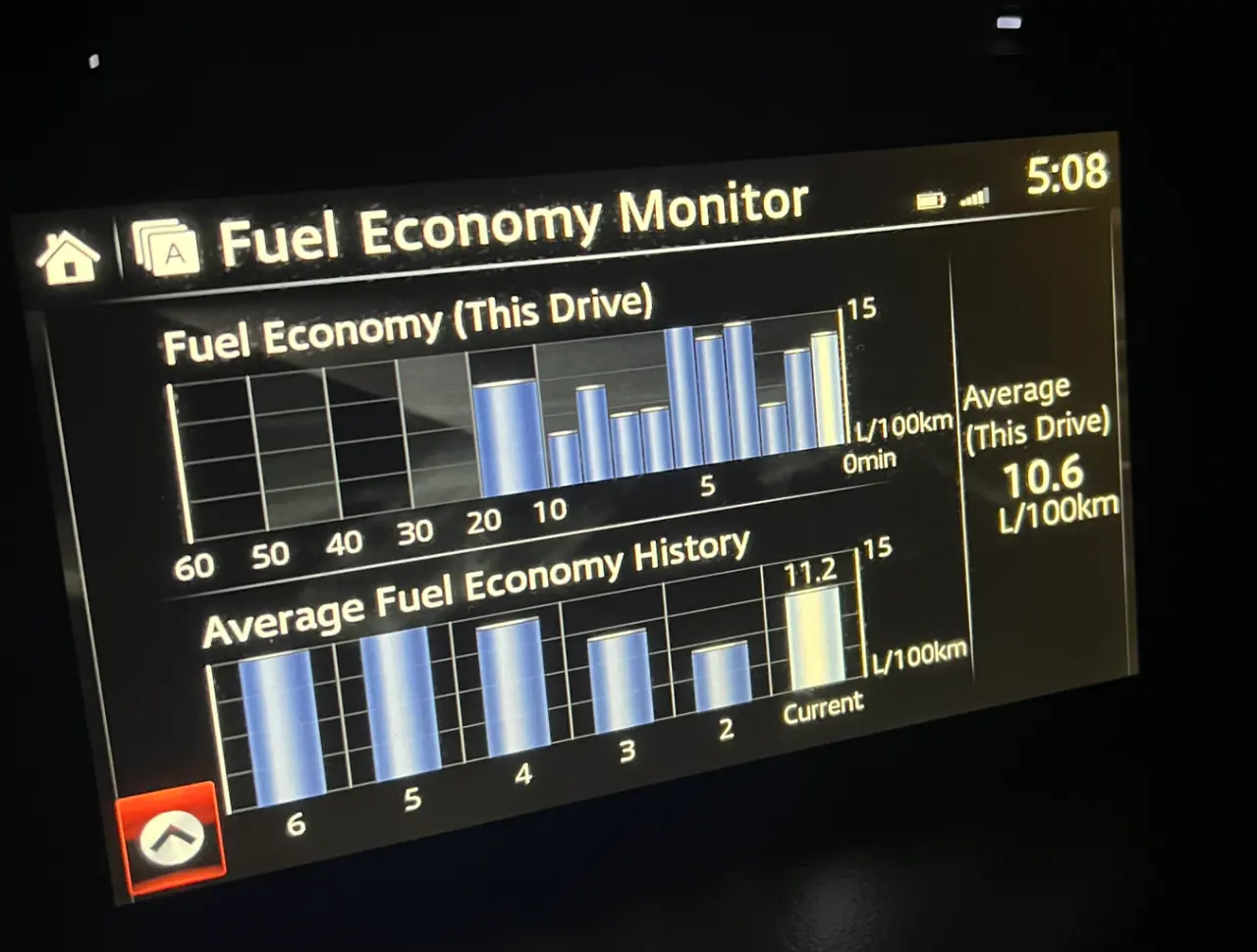

Can anyone tell me how to make sense of this? I’ve been running my own calculations of course but I don’t quite get the bottom lines. Also very hard to see the exact L/100km
The charts represent data points.
The top one is intervals of the current drive in minutes, from the last 5 minutes to the last 60.
The bottom one shows fuel economy history for your last six drives. One drive is from ignition on to ignition off. I agree that the y-axis could be more detailed.
Fair enough. Thanks.
Regardless the data is pretty bad for fuel efficiency.... lol

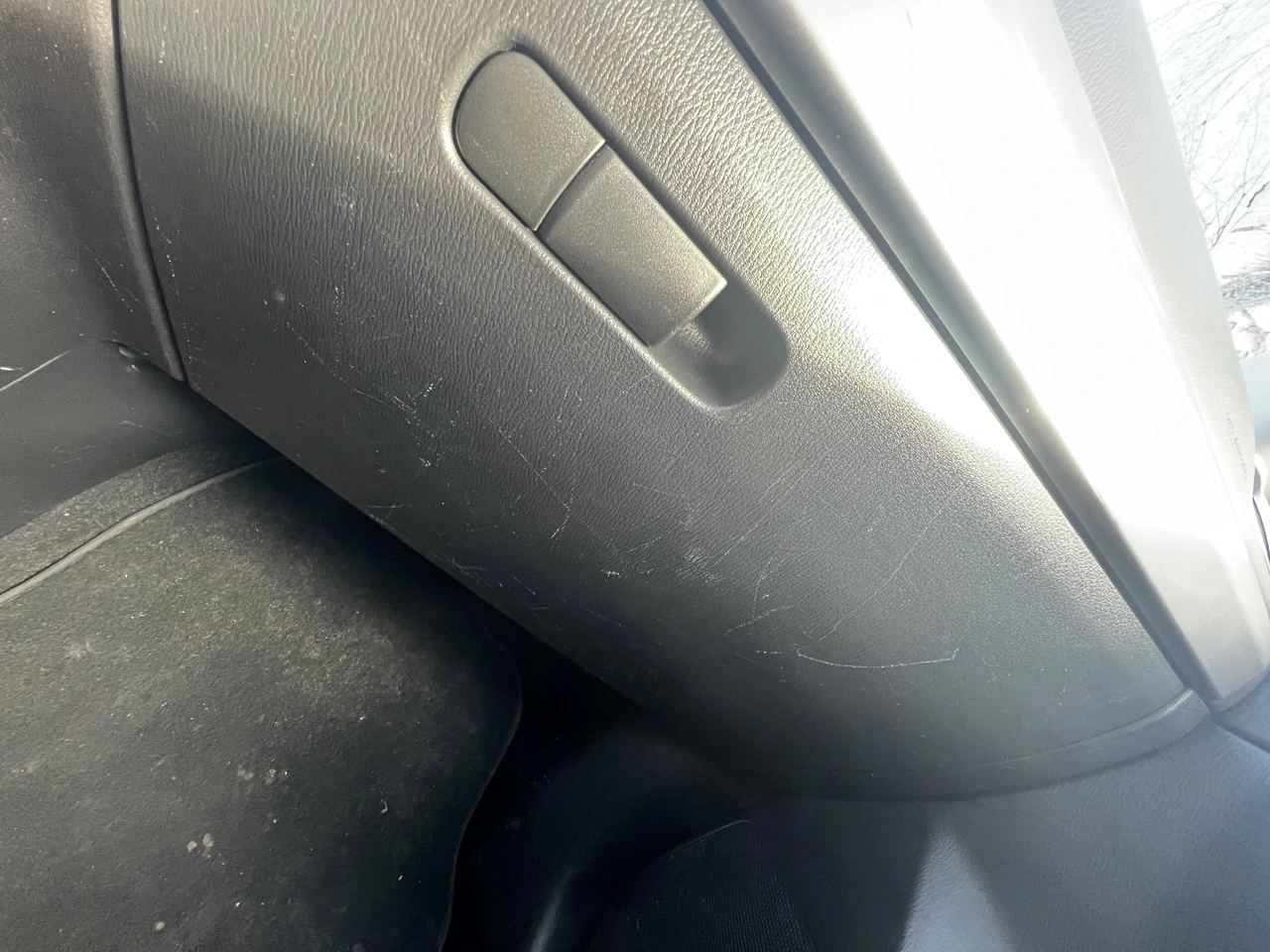

Any tips for getting scratches out of the plastic or cleaning the black plastic in general? I've tried cleaning it multiple times but it still feels dirty everywhere on the interior. Also looking for tips on cleaning the headboard. Previous owner had some messy ass kids/dogs in here lol
