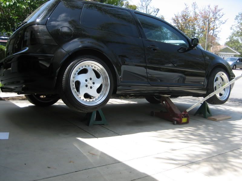

I believe original poster's intent is to jack up WHOLE side at once using just one jack , I've never seen that done before.
The jack point arrows shown in the owner's manual for the cheapo OEM jack that came with the CX-9 is to jack up one wheel at a time not the whole side of the CX-9.
I think OP is trying to do this, picture shown is a small car so it can be done; but not sure if it's possible with the huge CX-9 :
I wouldn't suggest trying that with a 4400lb unibody CX-9, or really any unibody car/suv. You're putting way too much stress on a point near the middle of the vehicle that was never engineered to handle it.
Exactly. But if you lift at the jack point you can lift the entire side of the vehicle to rotate the tires. Although really you should do a cross-rotation with non-directional tires, not just front to back. Another reason just to take it to discount.
There is a spot under the radiator support that has a slight bulge to it that is the spot to lift the front end. For the back use the bracket that would house your rear diff of you had one. I have lifted mine from them points and it is very stable, also the jack stand points are the same like any other vehicle on the pinch welds.
Eh... I'd have no hangups about jacking directly under the B-pillar. It may not be strictly designed for it, but in a static situation, there'd be a very robust loadpath straight to other substantial structure.
Couldn't you just buy another jack and use the two jacks on the actual jack points? chock the wheels well and it seems like it would be stable enough.
