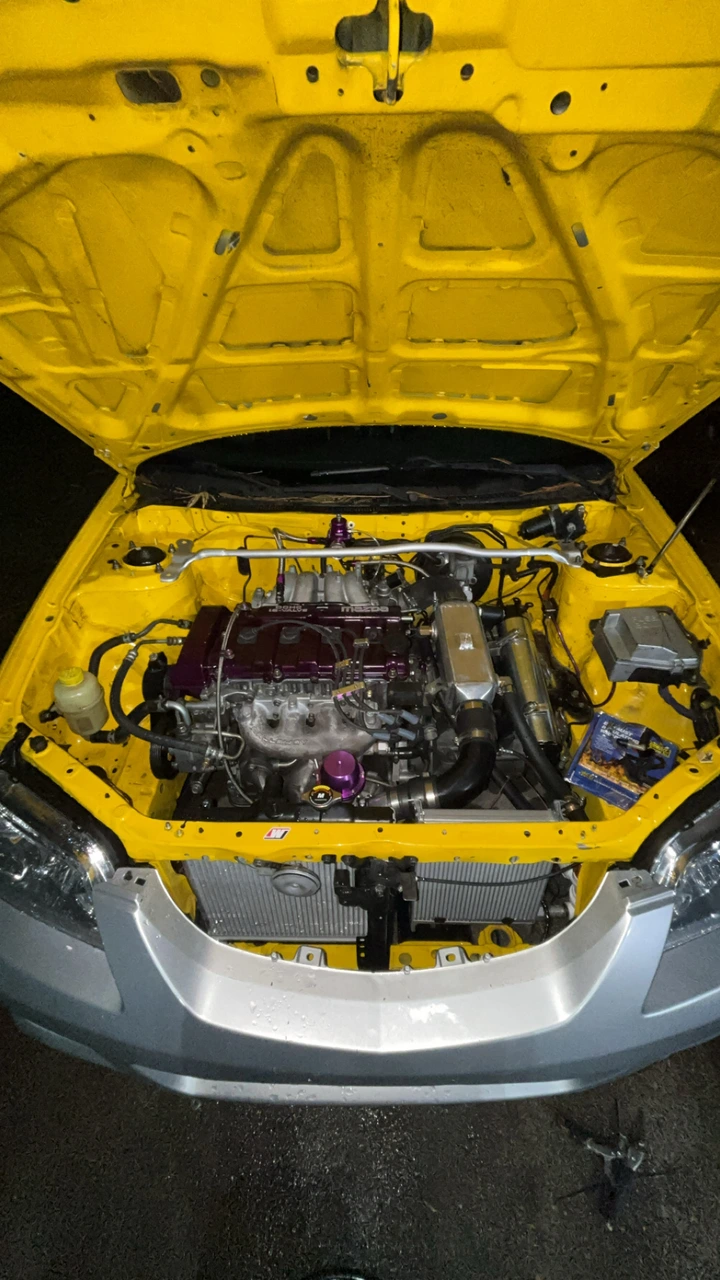

Here’s a pic of my engine bay as it sits right now. Air to water intercooler and a oil accumulator are those two shiny things above the transmission. Great pieces of kit for sure.

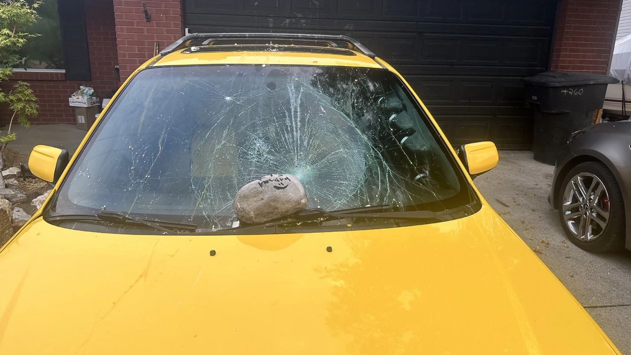

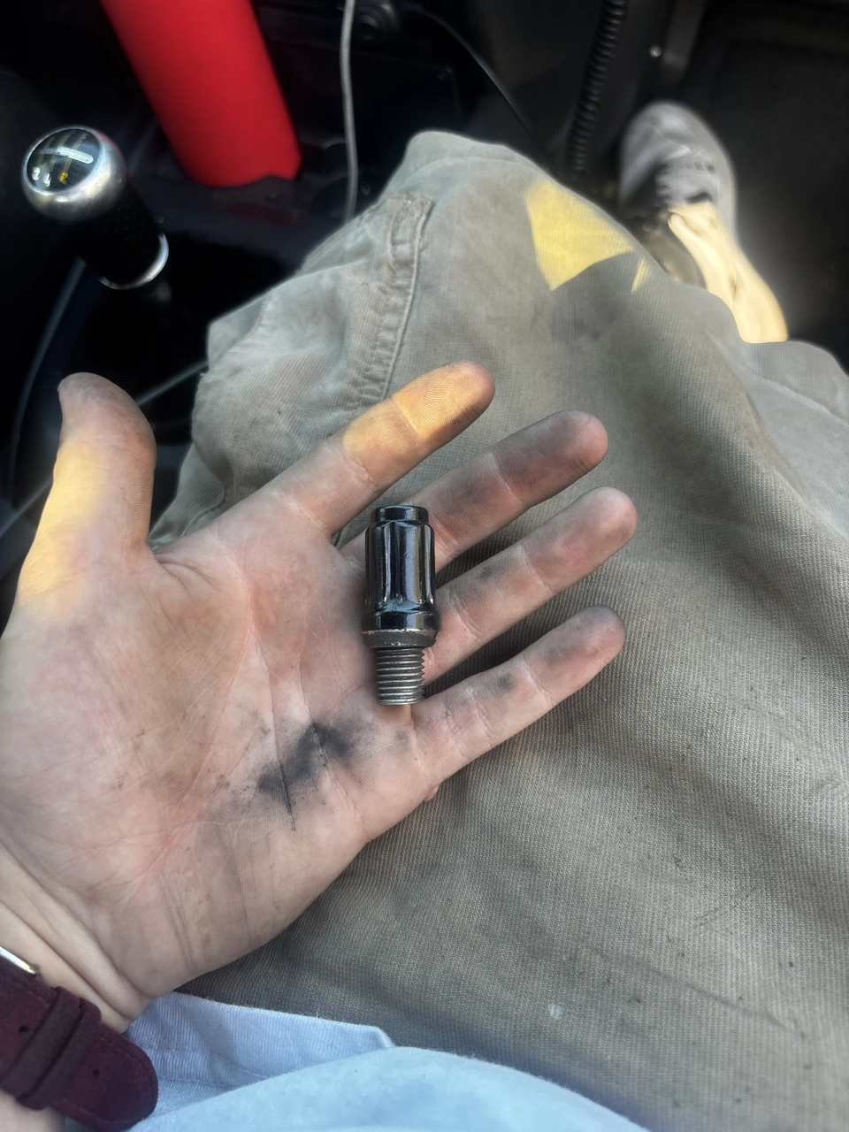

Gonna post soon, maybe tonight. Cars been running goodish in on eBay injectors so that’s my biggest issue rn since all my genuine injectors are dirty and they’re being cleaned and I might just sell them to buy some 1000ccs. B series turbo kit is done and it’s doing alright. Keeps overheating even if I drive like a grandma and I think it’s just the utah heat. It drives great once the sun is down. Had an issue two days ago where all my wheel lugs but 2 broke off on the highway. I have honestly no idea but I assume it’s from how much I take the wheels off lmao. Then last night someone because of what I assume is year old high school drama decided to throw a boulder from my neighbors yard about 50 feet into the windshield of my car. They egged it too and wrote something funny on the rock. Right after I ceramic coated so the eggs didn’t even stick but somehow the rock didn’t touch any of the bodywork. Lucked out. But yeah still having issues with piston slap even when hot and it’s been a crappy car but a fun project and learning experience so I’m still happy with it. Sorry for the unstructured mess of text that I’ve typed out but Ive got a lot to do today. I want to start posting consistently again, its fun and I have no one else to share stuff with.
I hope you filed a police report because that glass is going to cost you money that you could've used for more go fast bits.
