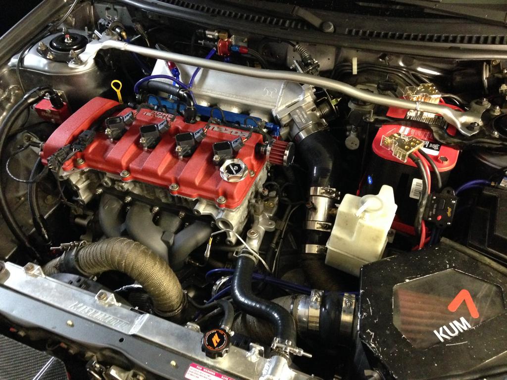

Highlights include fully built block and head, GT28RS turbo, Haltech ems, Mfactory gears + many, many supporting mods. It's gone 12.8 @ 112mph in the quarter mile and my goal is to break 11.99 one day.

Oh man man a sub 12 second msp would be sweet. I see you have a fancy airbox, what intake mani is that? I love the red on the valve cover, kinda makes me wish I did mine in red.

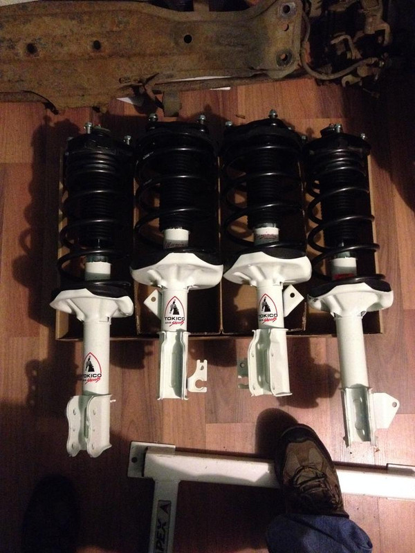

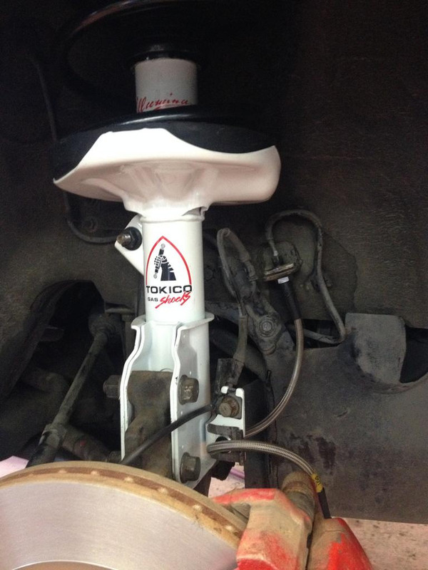

Tokico Illumina struts with Eibach Springs, Stoptech brake lines

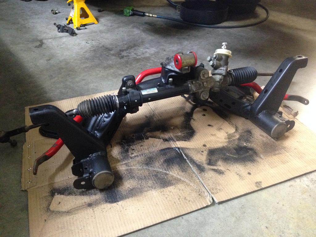

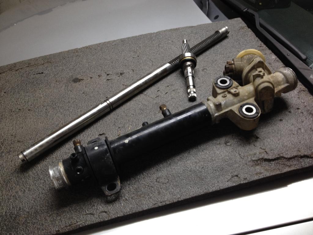

De-powered steering rack, new sway bar bushings and undercoated the subframe.

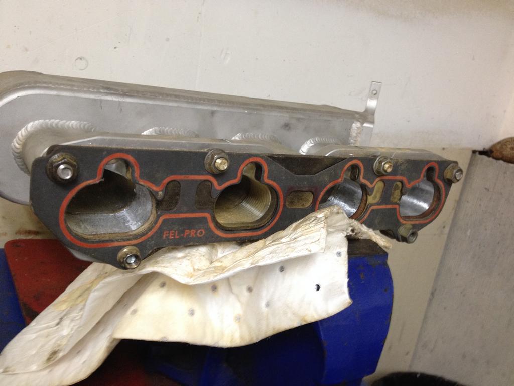

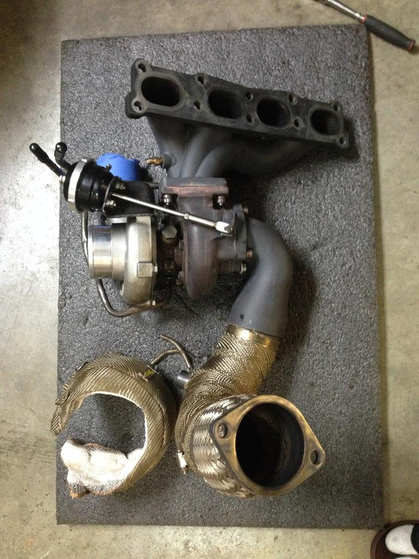

Turbosmart dual port wastegate, DEI turbo blanket, port matched 505 intake runners

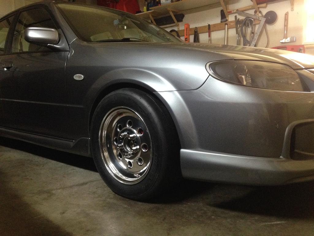

Re-finished oem wheels wrapped in Bridgestone RE71R tires

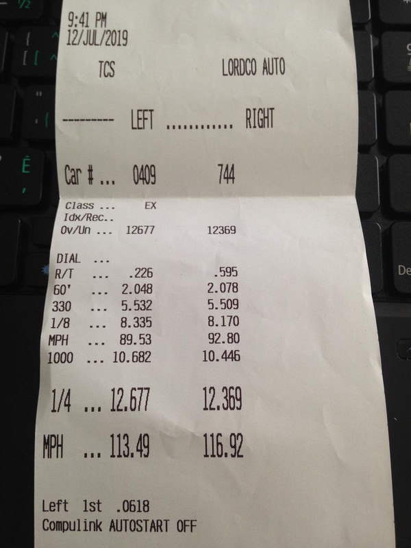

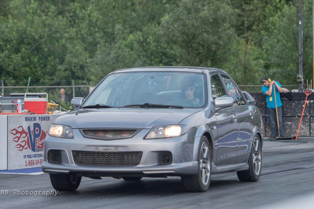

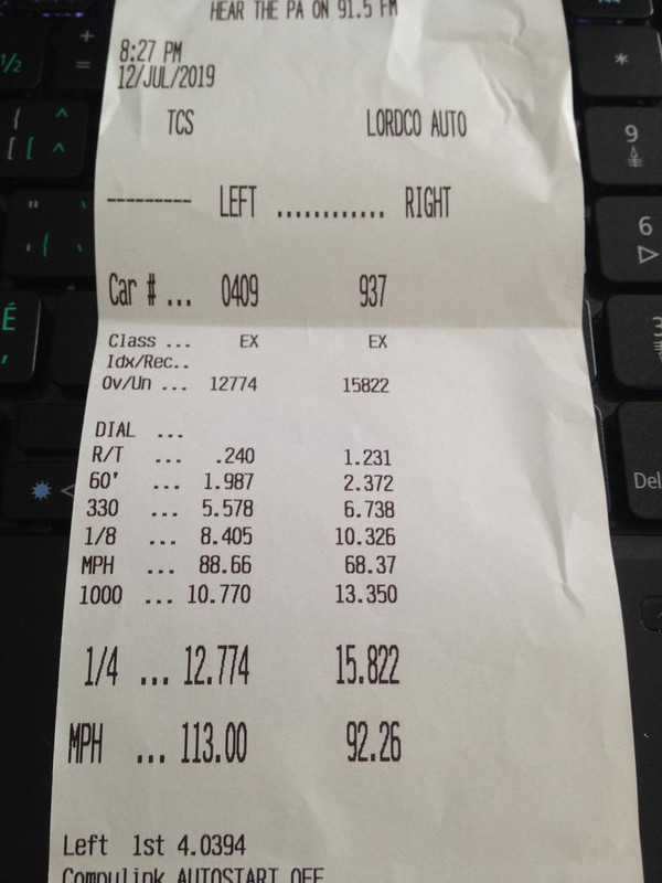

Went to the track on Friday, first time out with slicks too. I got some 225/50R15 Mickey Thompson et street drag radials and they hook up really well.
Made 7 passes and was able to get good numbers on 2 of them. One had a 1.9 60ft and the other was my best et/mph so far, 12.6 @ 113mph
Left lane - 1.9 60ft
Left lane - 12.6 @ 113mph. This run was fun because I was up against a twin turbo BMW M5, He's a bit faster but I got him off the line and he almost caught me by the finish.

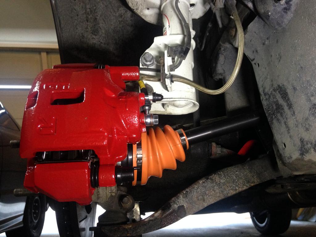

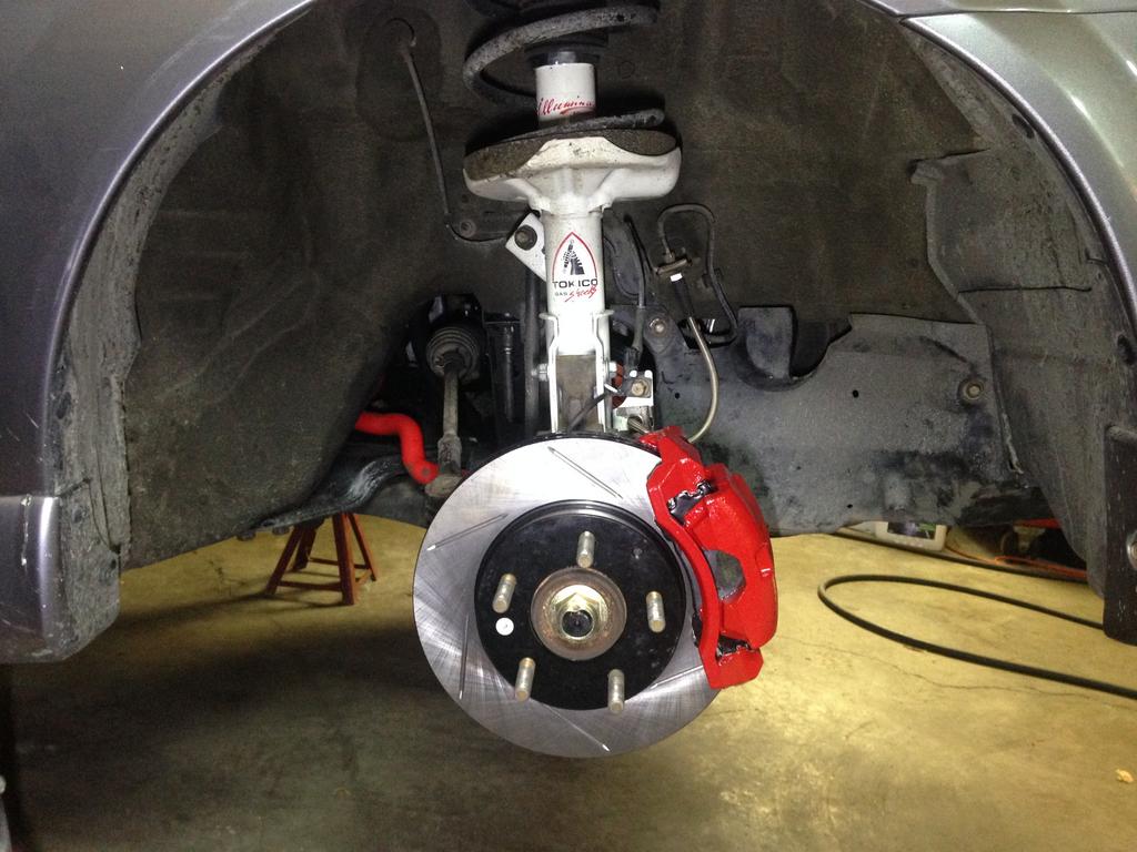

To make the 15" weld wheels fit, I had to use protege 5 brakes. Rotors are Stoptech and pads are Hawk HPS

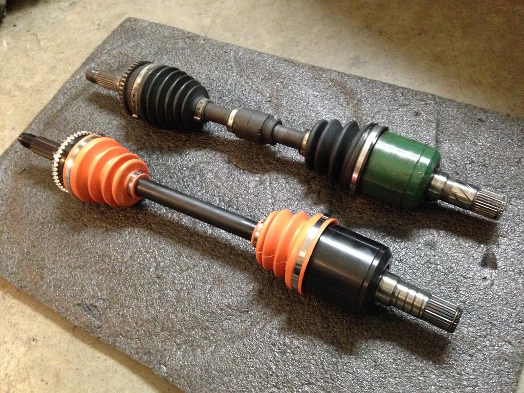

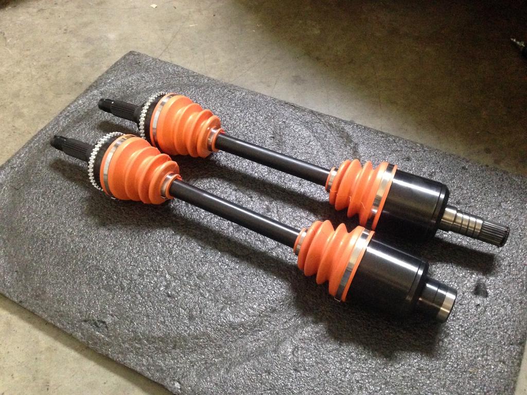

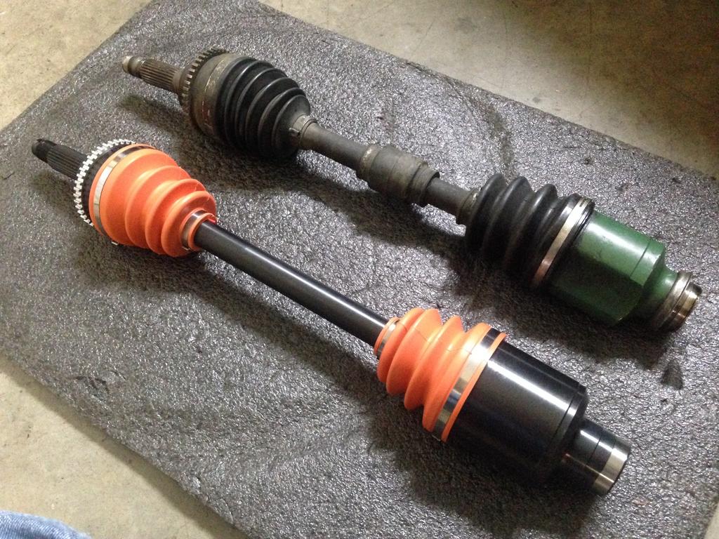

I also installed some mFactory axles. They're beefy, my only gripe is the boot clamps. They leaked grease and broke when i tried to tighten them. I installed some crimp style clamps and the problem was solved.

If i may ask- the axles and gears were they pricey? Also for the gearing- did you change up the ratios for highway driving?
This is such an exciting thing to see!! glad to see it making good power and times at the track.
Thanks :)
Mfactory axles and gears are pricey but well worth it in my opinion.
The escort 3.85 final drive and Mfactory gear combo made highway cruising more comfortable, less droney. I always found the stock protege gear ratios to be too short for my taste, rpms too high for cruising. Long pulls and less shifting is nice in a high powered protege!

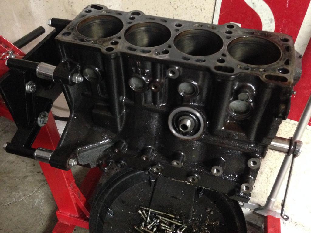

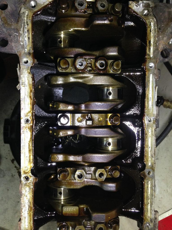

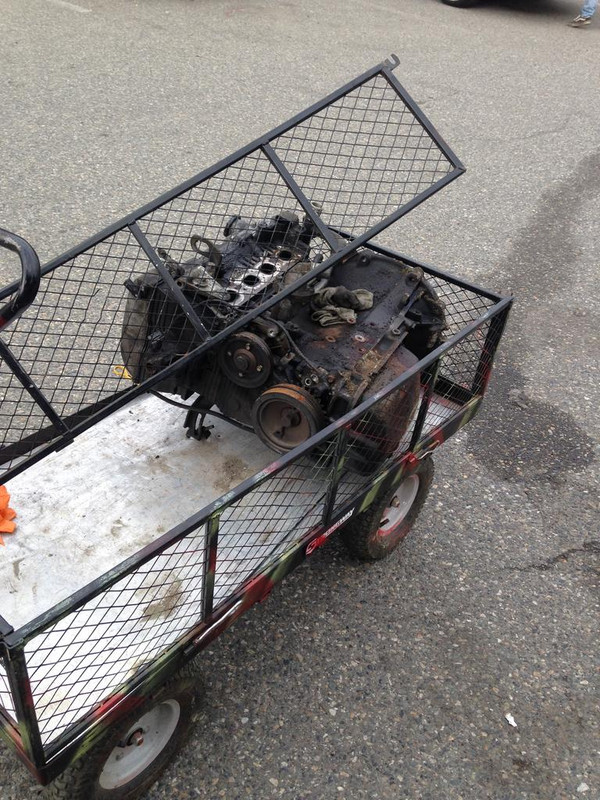

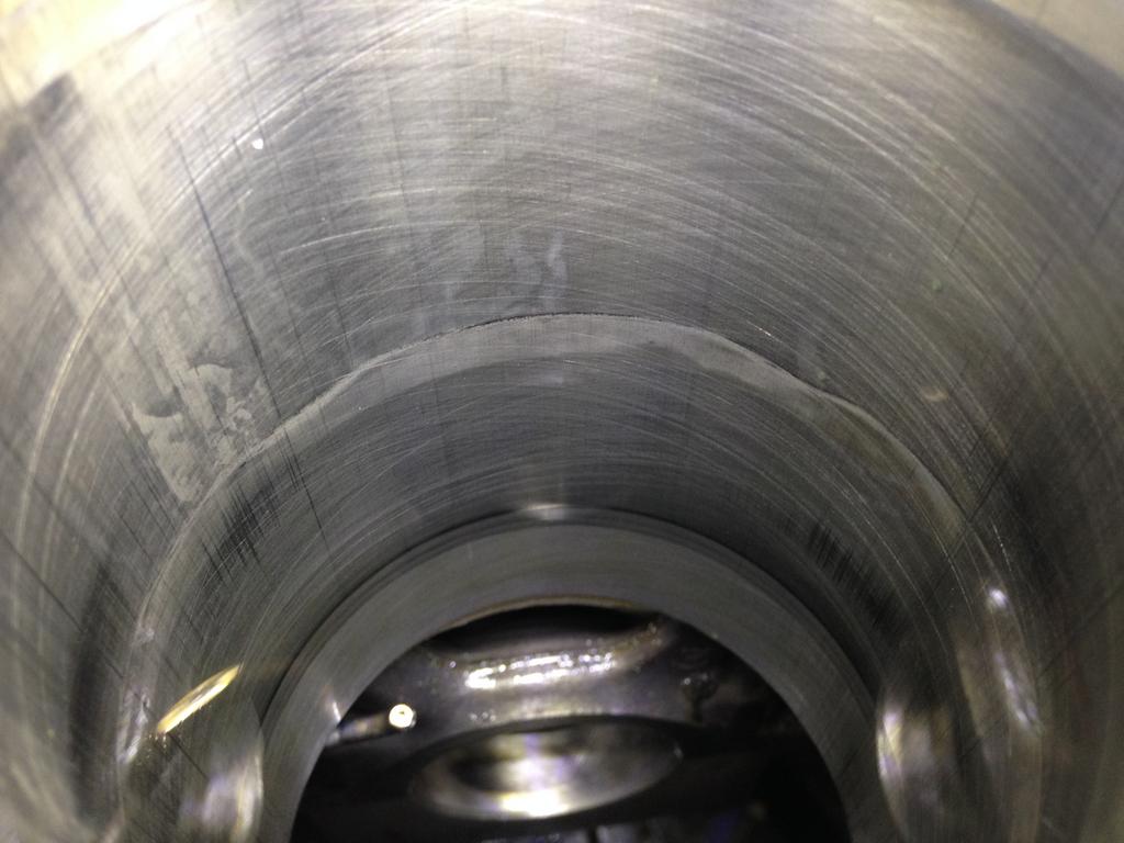

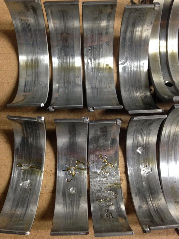

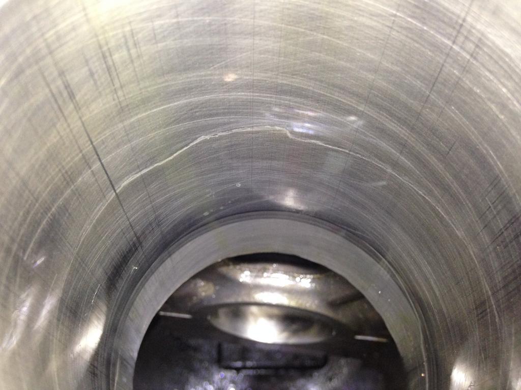

Tore down my engine this weekend after a compression test yielded poor results. I thought it was just gonna be a basic rebuild but once the bottom end came apart, things got expensive! I can't complain, this motor lasted 70,000 hard boosting kilometers with 60+ passes down the strip.

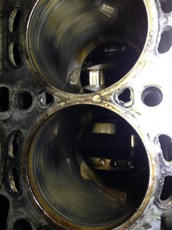

Looks like detonation got the better of my block and rod bearings :( I didn't notice any rod knock and the engine still made great oil pressure.
Cracks found in the bottom of cylinders #2 and #3
Rod bearings destroyed.
Went to the wreckers and got a core to rebuild. It looks to be a good candidate.
Also ordered new pistons and bearings. I'm going to have the rods checked and re-use if they're ok.

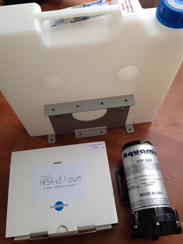

Water/meth injection will be used from now on. I should have done this a long time ago haha.
