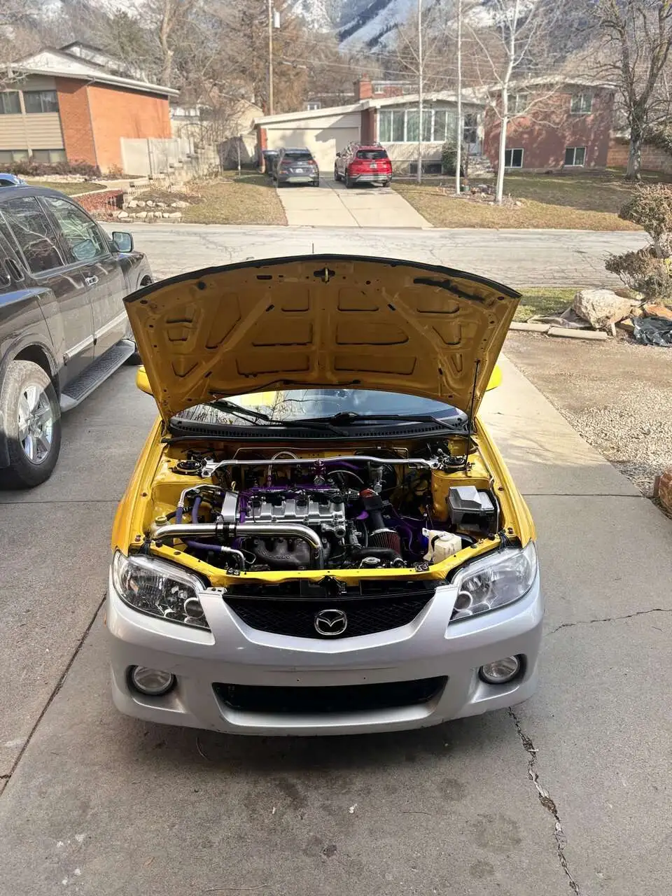

i got a cheap ebay turbo💪 1 year warranty, what could go wrong? it’s a gt2860 im installing it right now. it’s running way worse than before but im going to be figuring out most of the problems today

Try tying your wastegate open while the ecu gets used to the new system and progressively close it to let it acclimate if possible. Also use drilled-out spark plug non-foulers to space out the second o2 sensor so it doesnt throw a code and make it less likely to flood the engine. This is probably the best documented turbo/auto build on this site. It’s all experimental and I wish you luck.
thanks! i’m gonna try to find a 4psi wastegate but for now it’s tied open. fixing an oil leak and going for a drive today. when all is said and done i’ll do a write up on everything ive done, there’s a lot that i haven’t talked about but nothing that should make a big difference to the build
