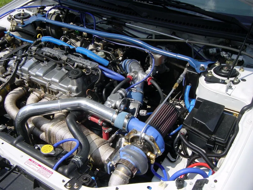

The port on my T-25 is 2" and the Throttle body on the P5 is 2.5"
You might notice that the IC has 2" on 1 side and 2.5" on the other side. It was purchased with this in mind so I did not need to step up to the IC. The intake before the IC is all 2" Aluminum and 2.5 after past the IC. The plumbing scheme was really ****** up. I attacked the task of installing the IC then worried about the plumbing. Custom means "More work" in Latin, I am sure of it...
It's a hard place to see but the MAS is on the pressure side before the two extra fuel injectors...(Red). The BOV is a Turbo X/S RFL. It's right next to the T-25 on the 2". This was done so the car does not stall every time the BOV opens. Ask if you need a better explanation..
Later...Brian

The placement of the BOV is by the book supposed to be at the TB. When I designed mine, I used the stock Mass Air and wanted it to far from the BOV so it would cause as little problems as possible. I put mine there as well because it is supposed to release the surge of pressure that builds before the turbo. There are pros and cons to both.

By the book it is supposed to be close to the throttle body. That did not work for me, the BOV was creating a massive turbulence and the air was venting backwards through the Mass Air.
The new setup is slick and ******* loud. I wish I had put it there first. It would have saved about $200 In Plumbing.
Read More about it in Maximum Boost by Corkey Bell. He Is A God.
I haven't had a check engine light or a stall since the change.

If you look on the picture of the engine, you might notice a set of blue vacuum hoses against the firewall. The first from the right is for the gauge the second is the BOV and the third goes to my EIC. It is harder for you because you do not have cruse control. Look for a place on your manifold to hook into. It has to be on the side closest to the engine after the throttle body to work.
