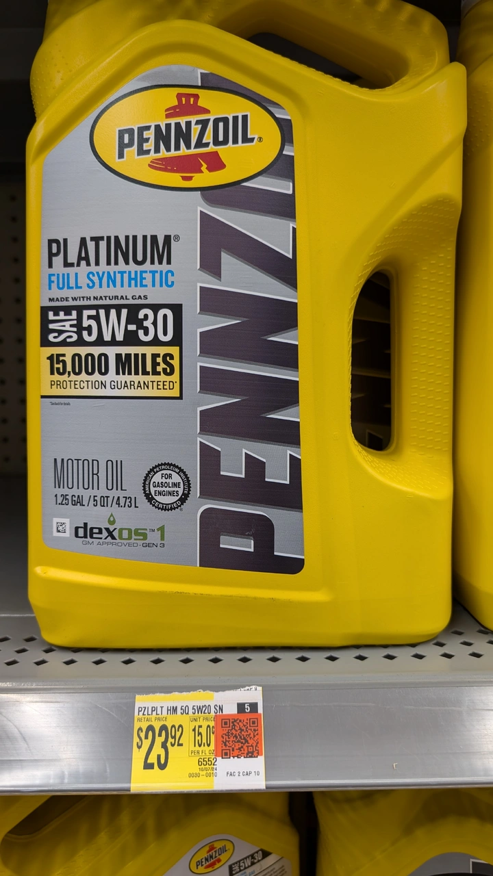

It will soon be time for me to do an oil change and I haven't bought any oil yet. I never see that Pennzoil ULTRA platinum at walmrt, just the regular Platinum, which I've used for a number of years now with good results.

amazon has been my go to for PUP
I bought there last time, but right now Walmart is cheaper. Picking up some now for the Miata.
