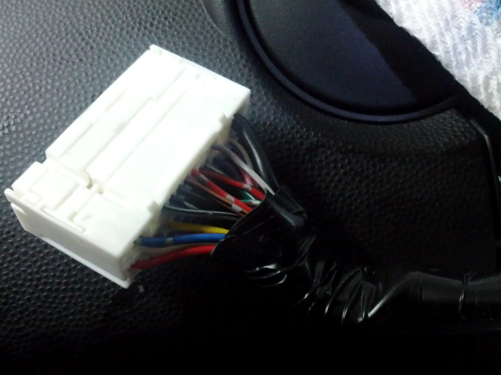

I just tried to look into the stock stereo, are those pins assignments standard? so I can put the stock plug into an aftermarket stereo?

no, you need an adapter harness, then you will need to swap a few pins to differnt spots if you want the steering wheel controls to work
Sorry I'm totally newbie. How do I know the function of each pin? are the color code standard? Someone said the VSS wire is already in the stock harness, how do I know mine is the same? by looking at the color of the wire?
