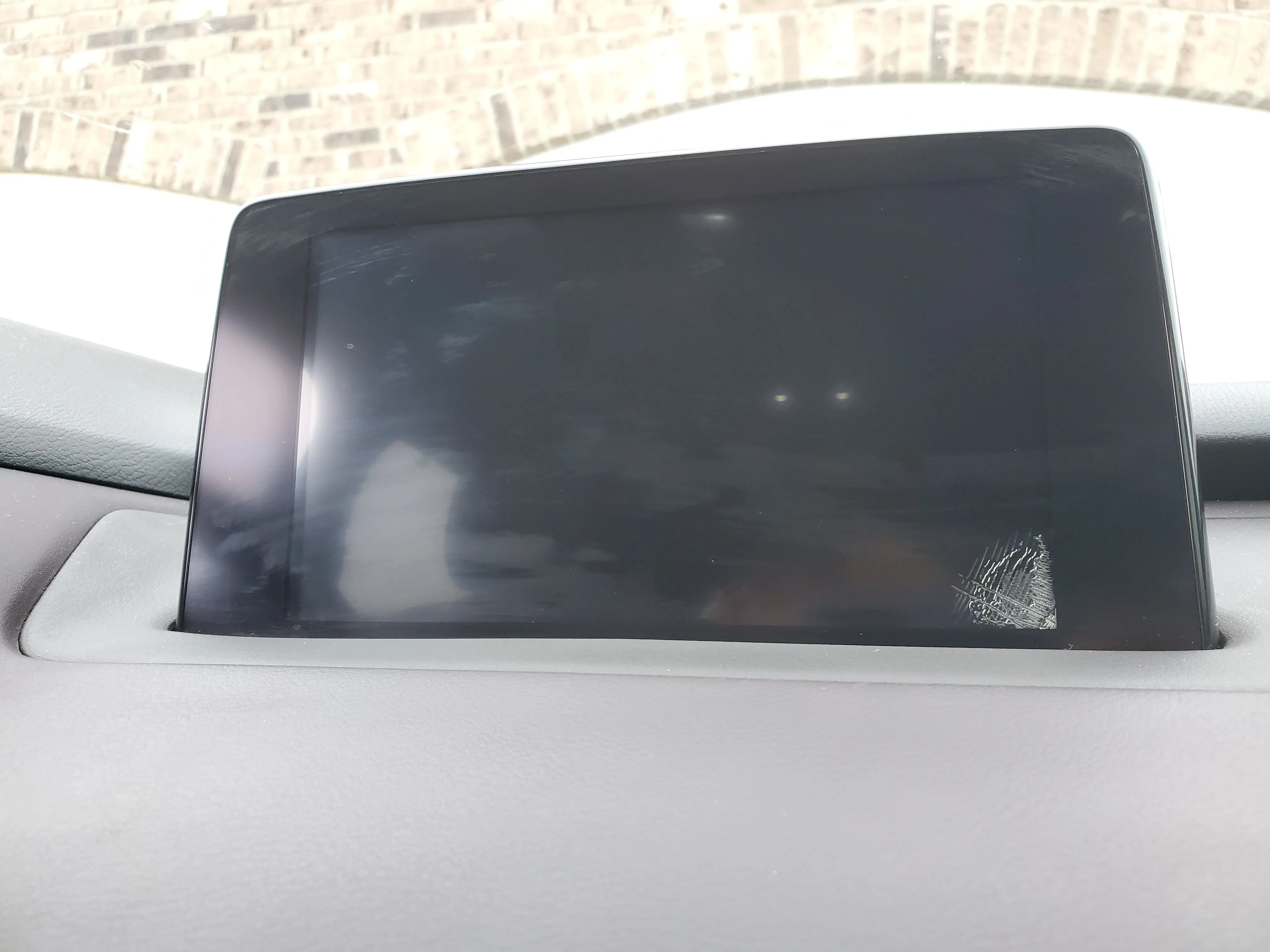

Infotainment Screen cracking (spider cracks)
Just saw the first evidence of cracks on bottom left/right of my CX-9 Touring (2016.5 model, purchased new in early 2017, 55K miles). The car has never been in a cold climate, only tropical. Not spider cracks but clearly something going on in those corners. Dealer agreed to replace free of charge as soon as the part comes in, in a few days. Thanks to those who posted the service bulletin!
Also saw one or two posts saying their dealer was charging them a $100 "deductible" or "deposit". What's up with that? Is that basically a dealer charging a fee for something covered by the manufacturer?
I started experiencing this same issue in my 2019 CX-9 in April 2022. Of course it began 5 months after the basic warranty expired. Efforts to get some assistance have gone nowhere.
My local dealership and Mazda have both said they can't do anything because I am out of warranty and my vehicle is not included in the extended warranty coverage.
Mazda said if I repair it out-of-pocket I should get the dealer to submit a flash ticket and if enough customers do this then it will increase the chance more vehicles are added to the coverage and if that happened I could apply for reimbursement. My local dealer quoted ~$3000+tax to replace the screen!
The Mazda customer service rep also said that my reporting of the issue on the phone doesn't get registered with the technical department at all. For that I would need to pay for the dealer to do an inspection and then they would submit a ticket noting the issue.
So basically Mazda can ignore this defect unless owners pay for the repair out-of-pocket or pay for an inspection. This is absurd.

I got mine replaced free of charge, outside the guarantee on my Mazda cx9 2016, you should check with your dealer, Mazda made an extension to the warranty to have these fixed out of the original warranty up to six years gap. Saved me thousands of dollars
Same here. Just had mine replaced on my 2016 Saturday under Mazda's extension warranty for the screen.

I've been in constant communication with the service manager of one of my local dealerships regarding my screen. He's told me that they have been waiting for "service exchange kits" for this issue. My understanding is that these kits contain replacement components for owners experiencing this specific issue. I was told they should start receiving them in 4-6 weeks, but who really knows. He also mentioned that they're waiting on 5 or 6 of these kits to come in, which means that their dealership will be replacing the screens for at least 5 other people who have this issue.
My screen did get worse during the cold snap we had about a month ago. I now have 3 corners of the screen showing the spider cracking, but its really only visible when the screen is off. As such, I don't really care how long it takes for them to replace my screen, lol

Hi, @sm1ke. You're correct. I mistaken the SSP as a recall. I revised the letter I got from Mazda and indeed is a SSPB9. I'm attaching the letter as promised. I redacted my personal information for privacy purposes but the rest of the letter is valid for the vehicles under this SSP. The document is in Spanish because I'm at Puerto Rico. Puerto Rico distributor reports to Mazda USA Operations so this SSPB9 is known by Mazda USA Operations.
In summary this particular SSP is covering CX-9 2016-2017 with manufactured dates between February 11, 2016 and April 29, 2017 and is extending warranty coverage for the Mazda Connect Screen for 7 years (84 months) from purchase date, unlimited millage.
