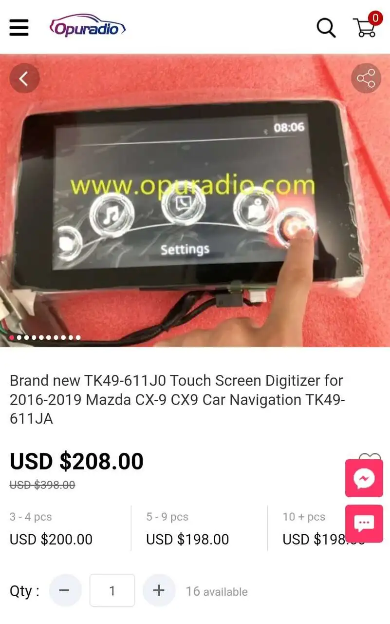

I bit the bullet and found a supplier that sends the whole glass (touch panel) and frame unit. Cost just over $200USD plus deliver. Have installed it and replaced the old and it looks like new.
just googled how to remove the unit and all in all took about an hour to casually take it apart. Just needed a screw driver and a star key

Hi @caredes, would you happen to have any photos or video of it working in your car? Is the new unit compatible with the existing infotainment software, or does it use it's own? All touch functionality still works?
they supply simply the touch glass and outer casing at the front, not the actual screen which is inside and was unaffected. The issue is the glue and quality of the glass used by Mazda, not the actual infotainment unit.
all touch functionality was as per the original casing

Is this the one you've ordered?
