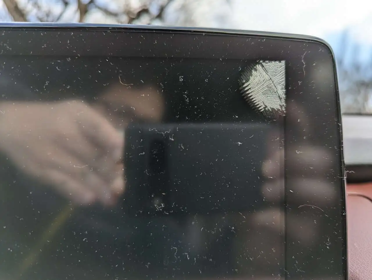

Just got the crack on my 2019 CX-9 after the extremely cold weekend in NJ. There was nothing on it last week. Going to reach out to the dealer now...any body had any luck with the 2019+?

Yes. my Cx-9 is 2017 and dealer had replaced the screen twice so far because of cracking...
Just came back from dealership. They said my car is out of warranty and nothing they can do. Advised me to call Mazda corporate.

That's one lazy dealer. They should have been able to find the TSB related to the issue, then contacted Mazda Corporate directly to open a case on your behalf.

Mazda corp responded and they said nothing they can do as TSB doesn't include 2019 with the same defect part and I'm out of warranty. He's so kind to offer me $150 credit toward the fix.

I've been in constant communication with the service manager of one of my local dealerships regarding my screen. He's told me that they have been waiting for "service exchange kits" for this issue. My understanding is that these kits contain replacement components for owners experiencing this specific issue. I was told they should start receiving them in 4-6 weeks, but who really knows. He also mentioned that they're waiting on 5 or 6 of these kits to come in, which means that their dealership will be replacing the screens for at least 5 other people who have this issue.
My screen did get worse during the cold snap we had about a month ago. I now have 3 corners of the screen showing the spider cracking, but its really only visible when the screen is off. As such, I don't really care how long it takes for them to replace my screen, lol
Just a follow up to this. Screen was replaced today, in and out in less than an hour.

It doesn't work like that, the original screen can crack at 10 miles or 100000 miles. If you read the TSB on the first page, it states that some (not all) of the screens are faulty. I think I read somewhere that the internal screws may have been overtorqued, and temperature swings can cause those stress cracks to appear. I'm not 100% sure, but in any case, getting a replacement screen from a used vehicle from 2018 and before means that you could get the issue again down the road.

I just got off the phone with Mazda corporate for my 2018 cx9 GT and they will not cover my screen. I just filed with BBB.
I also have the 2018 GT. I've been blowing up the phones at corporate. No one gets back to me. I told them that I will be calling them as my morning routine as I sip my coffee. How do you admit that it's a faulty screen in 2016-17, proceed to install the same faulty screen into the 2018-19, but say "Oh no, that's not covered." When it's a newer car?! Infuriating. We need to blow them up non stop with emails and phone calls. Someone had to do some legwork to get the 2016-17 covered under the extended warranty. So let's do the same thing. Bug the crap out of them so they're forced to listen. Also leave a review on mazda dealership with pics to pressure the dealer to fight on our behalf. My whole family drives mazda, but if they refuse to do the right thing with this, then we're done. Never getting mazda again if they care so little for the products and customers.
Also going to try the NHTSA route and make a complaint as well. It's a safety hazard when you need to strain to see your maps, taking your eyes off the road. They were the ones who seemed to have pushed through the last bulletin for the 2016-17. So stay on them! Don't just leave the complaint and forget about it.

My 2018 CX-9 now has two spider screen cracks. Upper right corner two years ago and then this year the lower left happened right in front of me. Both occured during below 0 F temps. I am going to check with dealer to see if they will replace and will post back here.
Did you report it to the dealer two years ago? You might have been within warranty or close enough that they would have replaced the screen for you back then. For sure check with the dealer and provide the TSB so they have something to reference.
