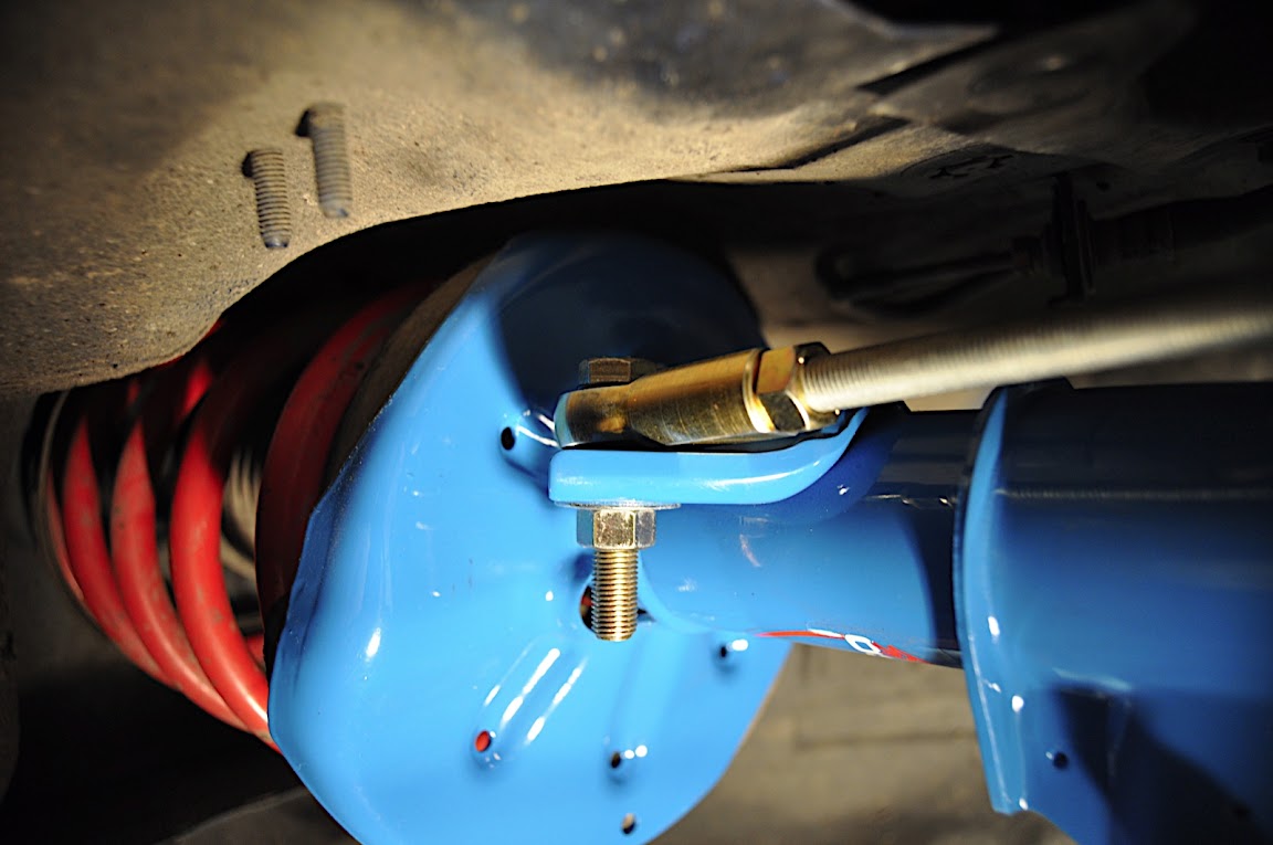

Progress Rear Sway bar with Progress Greasable bushings and brackets. Other than the ocassional squeak fixed with some white lithium grease, I think I'm set :D
Just ordered some threaded rod and the rod ends from mcmaster. Along with the nuts and bolts and o-rings from the hardware store and the new MSP rear cross-member Chris ordered for me today, I should have a reliable and worry free rear suspension setup. Can't wait till next weekend now.

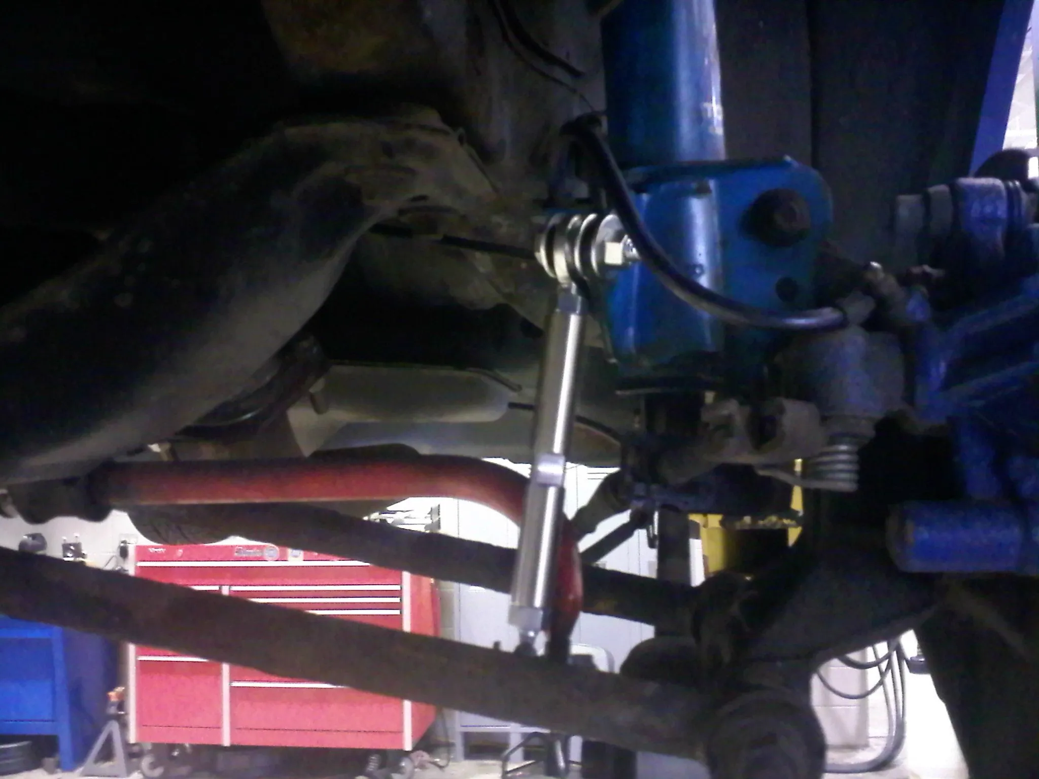

yeah i hear ya Ivan, i can finally bolt on the sway bar and put the endlinks on the car now...
got them installed today.

$80, but these are stainless bars with chrome moly endlinks. much stronger and more weather resistant.

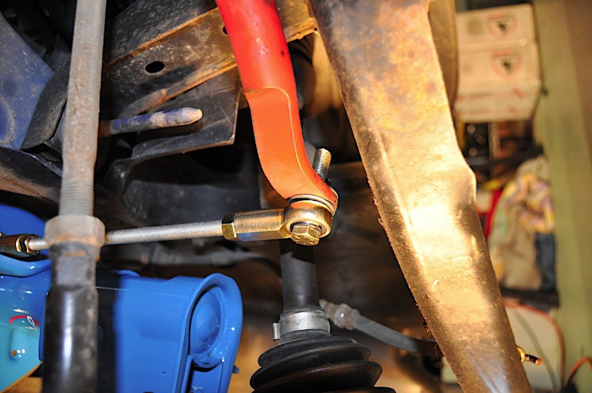

so i ordered 8 of the joints from the first post.(for all the way around)
now shoud i stick with the rubber orings or the metal washers? any suggestions?
No orings...lol Just washers.. Post pics when you are done! lol
no rubber?

Not Nice.... I don't like the clearance over the lip of the stock tokico mounting tab and the rubber o-rings I'm using are just flattening and squshing out. :( I need to change something.
I told you the AWR O-rings were much heavier duty than the ones you picked out. Also, I think that that funnel thing you asked me about is 1) a spacer and 2) the funnel end keeps the o-ring in position. Still looks nice though...
I contacted AWR to see if I could buy just the funnel spacer and o-ring and have yet to hear back. If I can that would be hot :)
EDIT Just talked to Tony at AWR and they are getting me a set of the funnel washers and heavy duty o-rings. The washers are 4 something a pop so with shipping that came to 45 bucks. So in the end I've maybe saved 20 bucks over just buying a set of AWR ones of the the shelf. Not super happy about that. But I do like having something that I made.
