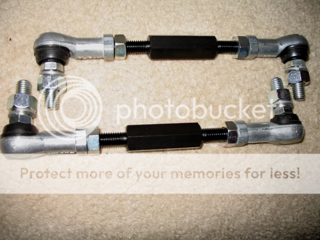

Actually I found a better place with better parts. I can get the metric ball joint rod ends, with both left hand thread and right hand thread, with a hex rod coupling in between (left and right thread ends). This allows adjustablitity with the end links connected.
Like the Powergrid links, only it doesn't cost nearly as much:

Here's what mine look like:
Turning the hex with the link installed can lengthen or shorten the link.
those are nice,
