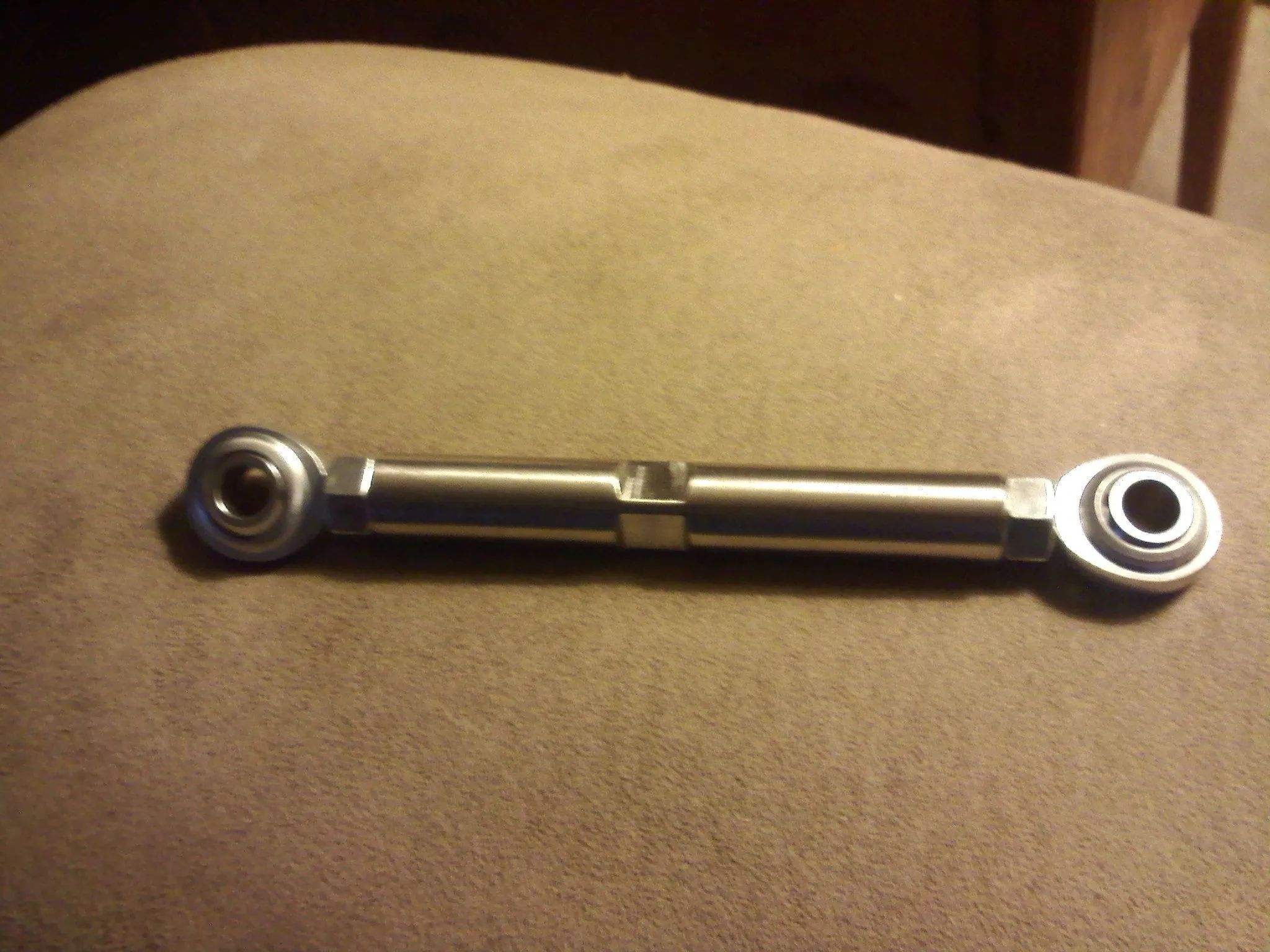

Stopped by Jegs and these are perfect!!!! Much stronger than all-thread and should last longer for a DD.
yep, whole assembly $45. I just was worried about using all-thread. I wasn't impressed with how it would hold up to the weather. with these the whole assembly is stainless. and if something happens you can just change out the end links.
