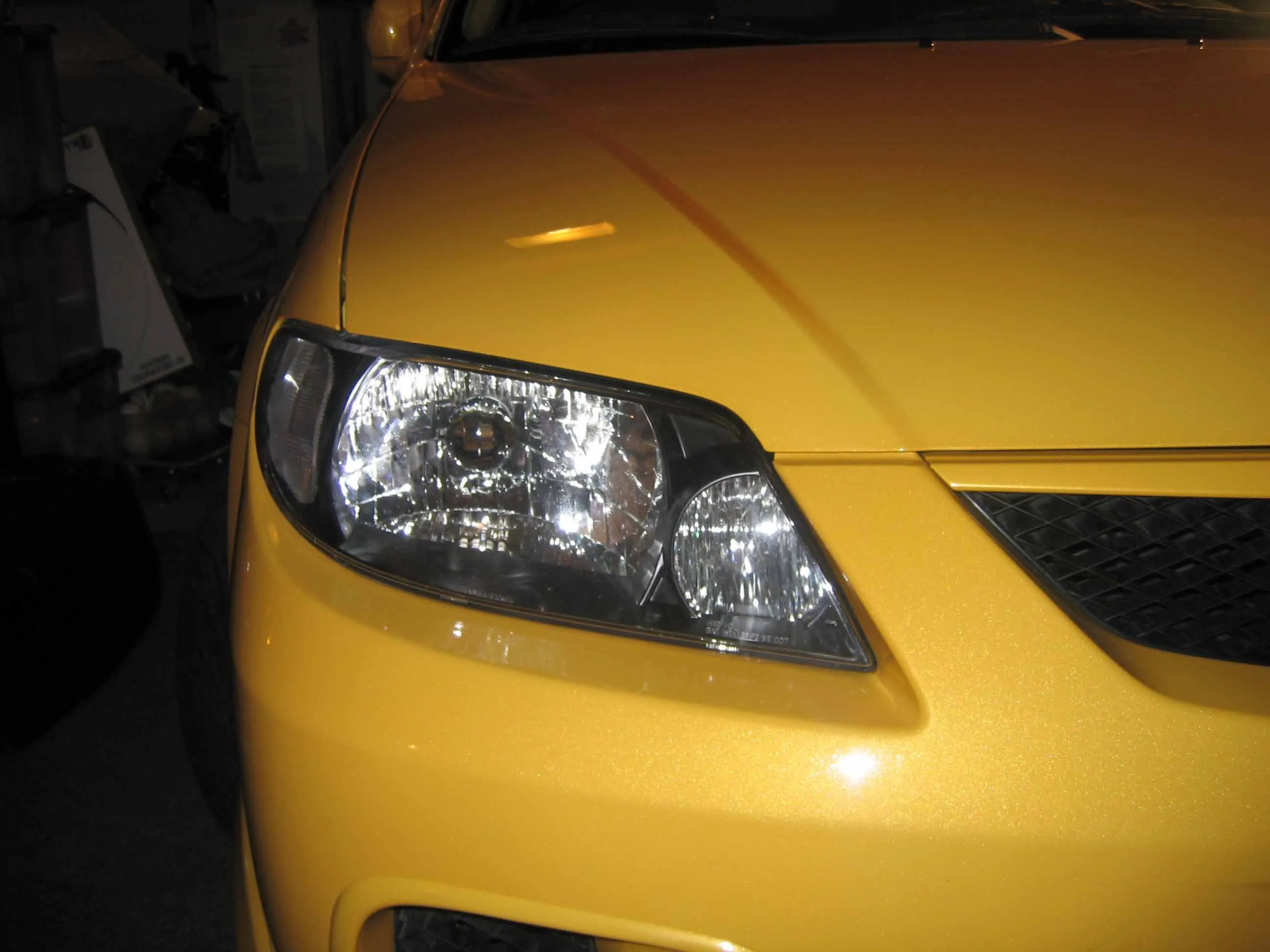

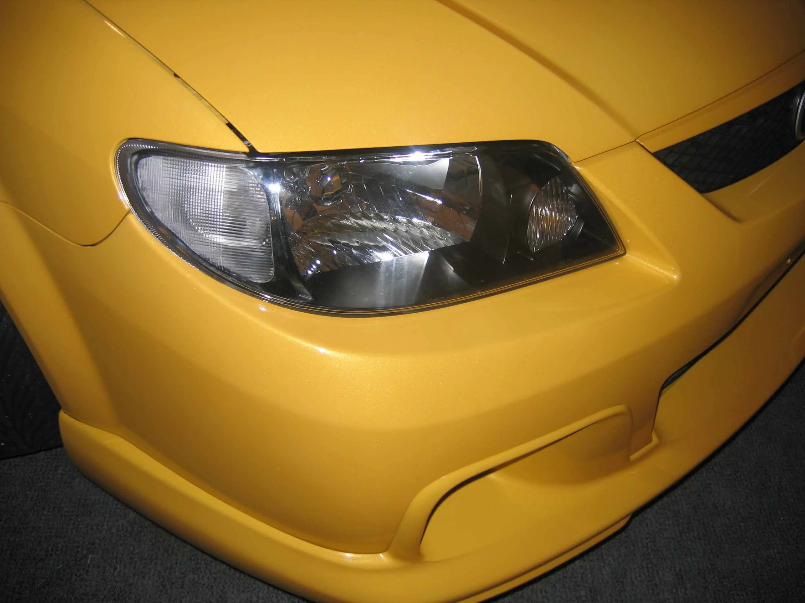

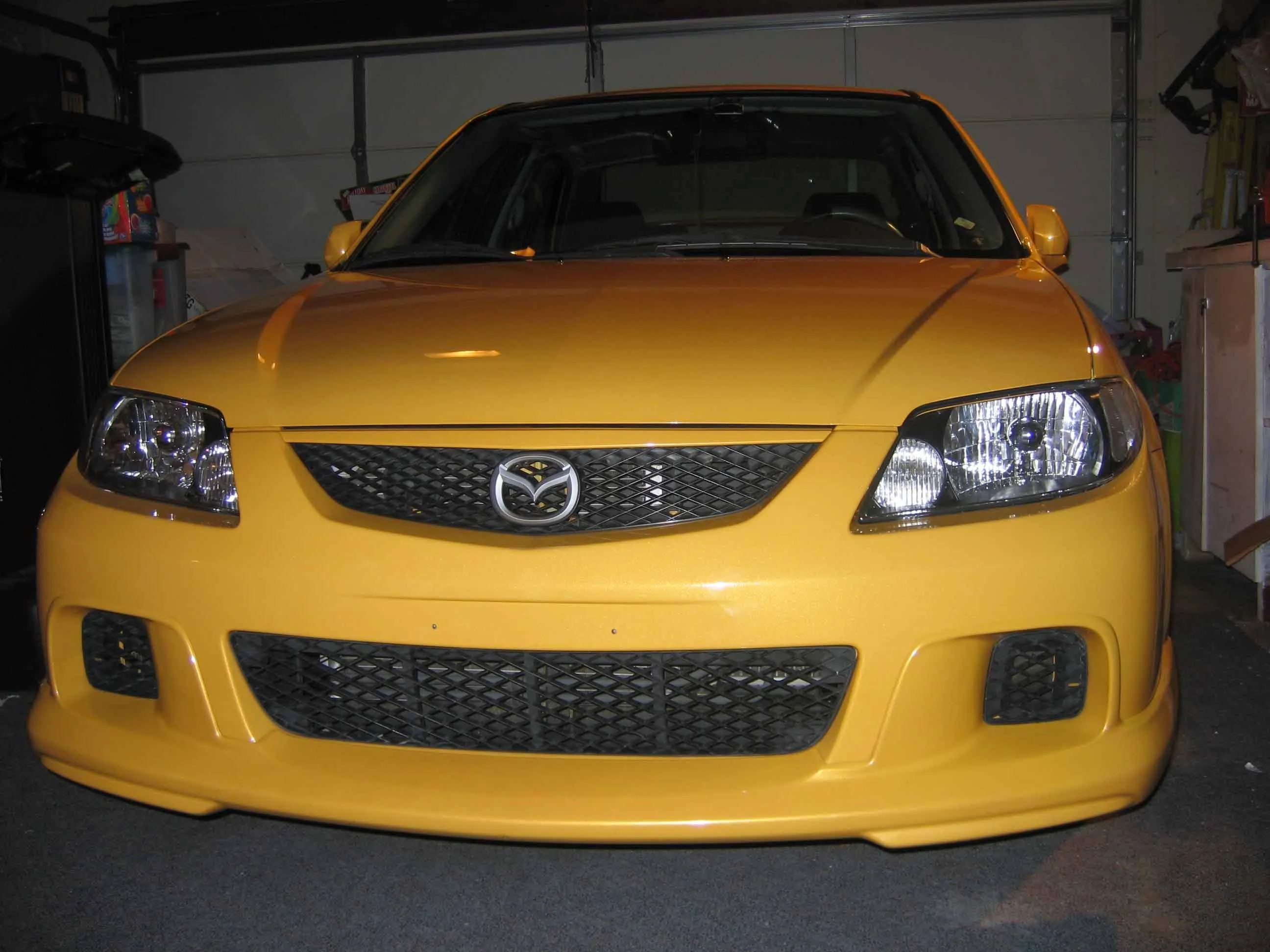

yeah i definatly utilized the service manuel for my bumper removal, i only broke one clip (on the grill). my car looks way good, i used HondaBond HT to help reseal my lights when I was all done, I also shaped, molded, and installed a tytanium clear corner kit. It took me over 18 hours to do but man is it worth it, check out the pics, tell me what u you think
should have blacked out the sides
