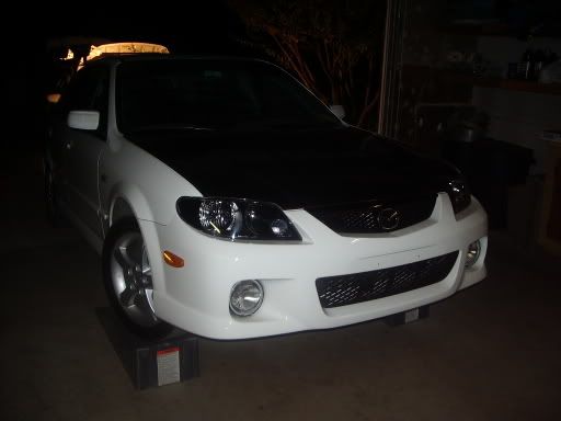

wow i just did this diy and followed xswimordiex's how-to step by step, and i have to say i love the outcome. if anybody's contemplatin on whether to do it or not, i say definitely do it. the only pita was takin off the front bumper, but once that's off it shouldnt be all that bad. theres a pic of it in my sig. just my two cents :)

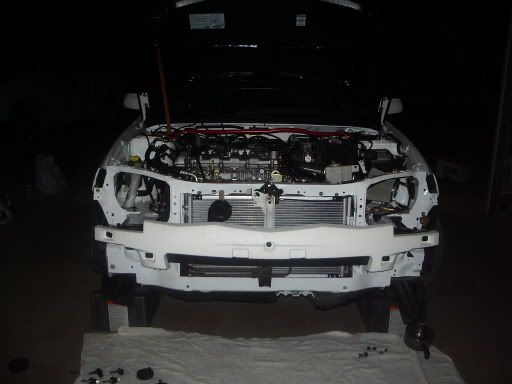

The hardest part was trying to get the bumper off. I was looking for the mystery screws to drop the bumper. I was looking for them more towards the front of the car, but then I found them hiding in the fender at towards the top of it. I ended up breaking the secrete lock under the light though, but it went together and was unnoticable so if you break them, its not the end of the world. Great write up, I would have been stuck w\ chrome lights forever w\out it. I dont have the balls to venture out and do it myself. I needed the reassurance of directions

What's up, Thanks for the great write up on this....It looks freakin hot on the midnight blue....It took me a while to get the bumper off, but after that it was smooth...Sanding and painting took me a loooong time, but I'm a perfectionist and got the results I needed to be happy. 3 coats of primer and 3 coats of paint later and I'm satisfied...at 3:30 in the morning took them for a ride. The first day it rained I got freaked with a little vapor in the light near the turn signal, but it hasn't come back and it's rained buckets since then.
