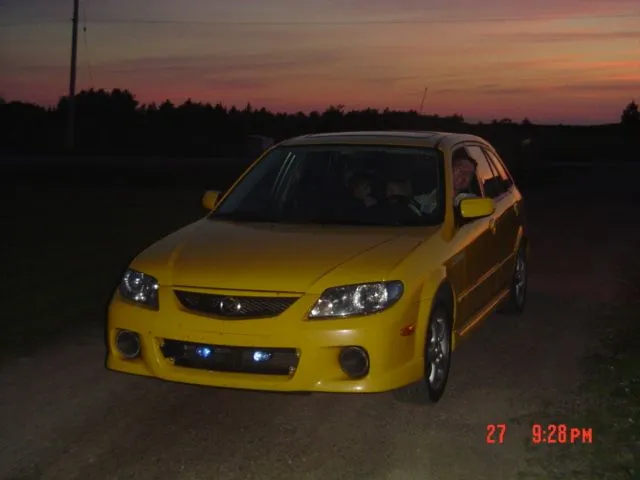

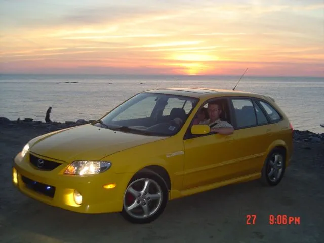

someday im gonna do that one....... i did the same thing to my fogs.....doesnt look to bad....i think i have a pic somewhere
as you can see blacked out and still not to bad...imo
