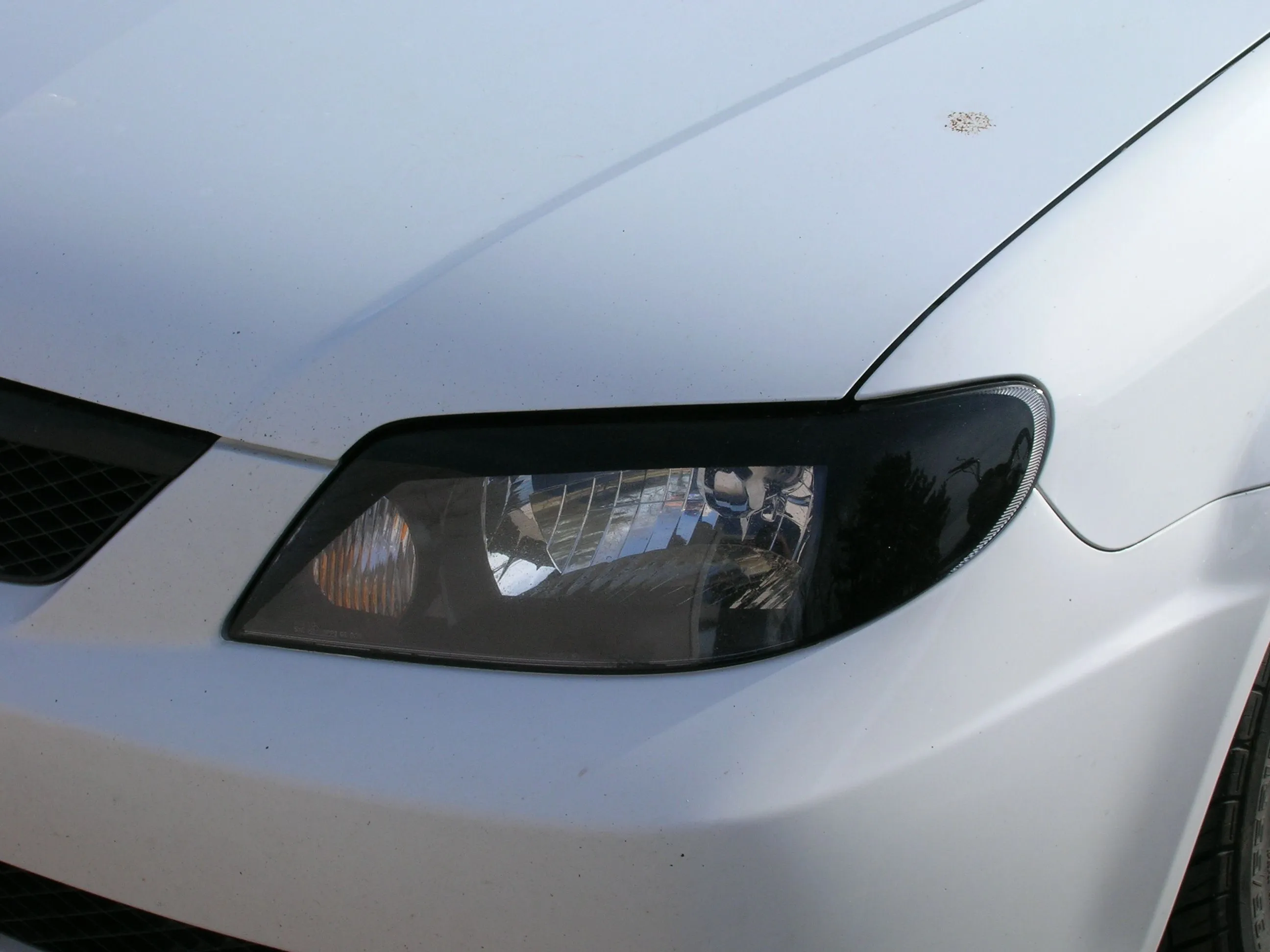

here are some pics of mine I did a few days ago.

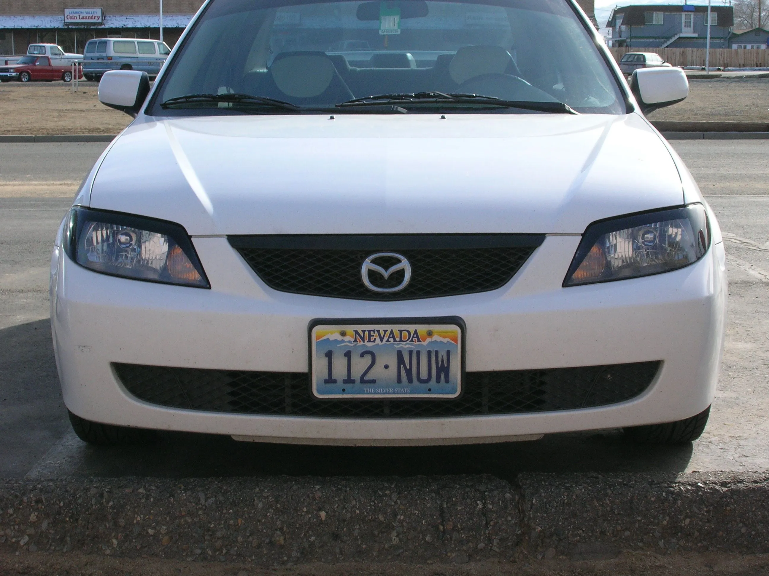

I painted my Headlights even though my car is not a P5, it still looks good and the procedure is pretty much the same

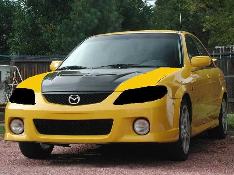

I want to do this mod very soon, but was wondering if Automotive exterior paint would work? I have some left over from the body shop, and was thinking about thinning it way out and using an airbrush to do the headlights, giving it more of that C6 Corvette headlight fixture look. Until then, I'll just black them out like this...
