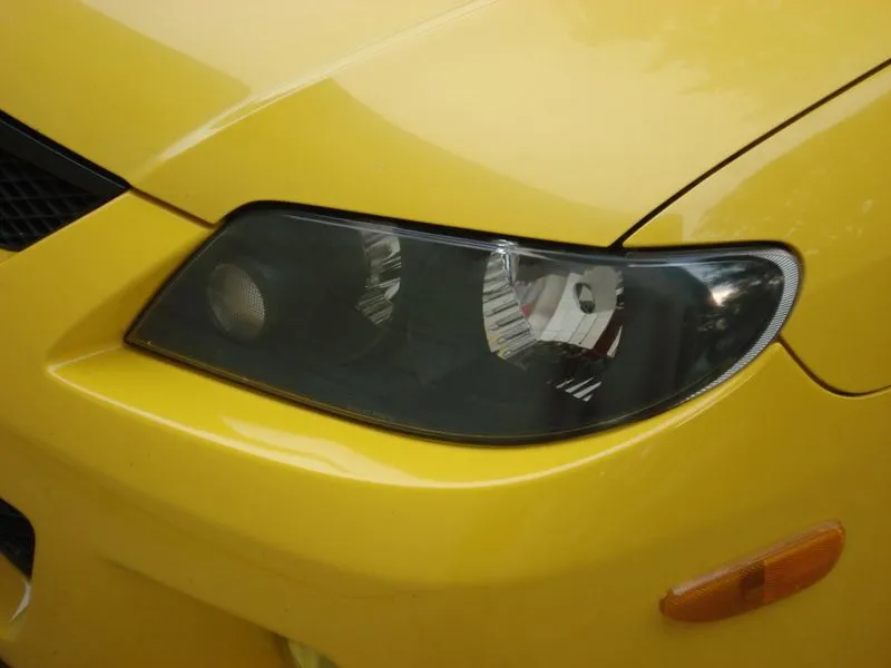

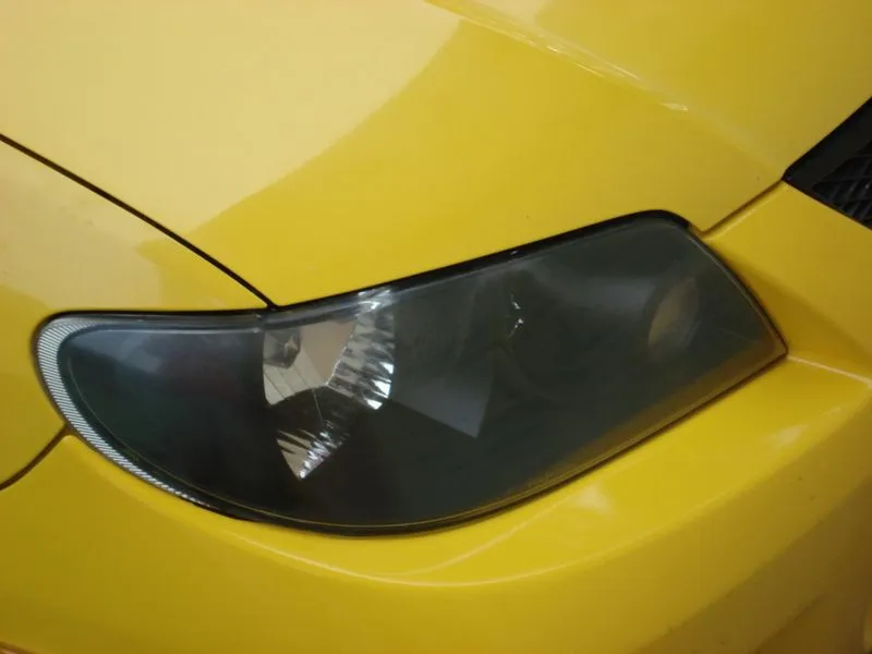

done painting! gonna let it dry for 45 more minutes then stick it all back together...minus that screw i lost :(
well i'm done, waiting a few more minutes for the silicone sealant i added to dry a little more then I'll put them back on the car
i couldnt get my housings apart... did you use 200 for temp or higher?
We did 200, but definitely not for very long... We had it in there for 1-3 minutes, tops.
When you're prying it apart, it helps to have a utility knife handy to cut away at the silicon.
I use 200 degrees for 6-8 min, I also baked the painted piece seperate to make sure paint was dry. The silcone is way overkill and not needed, unless you pulled all the glue of yours they'll seal perfect, I dont think anyones ever had leaks that stuck them back together tight.
