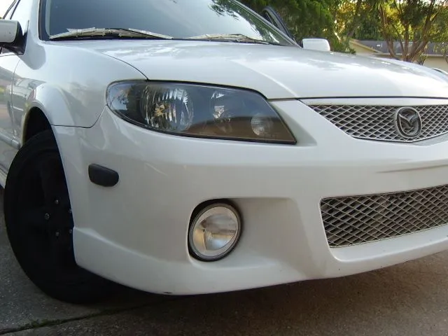

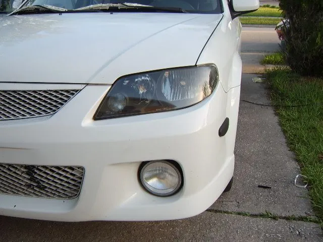

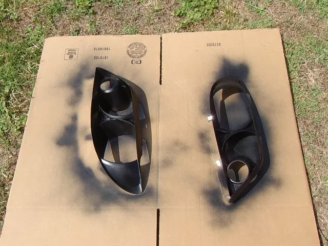

ok i just did this, and i found a helpful hint for everybody who hasnt done it yet,
when u take it out of the oven and ur trying to pry it apart; it cools down fast so use a hairdryer or a heatgun, because i used it and the silicon or w/e they used to seal it together just literally spread apart with out any effort at all, really easy with a hairdryer, REALLLLLY EASY
and my headlights looked a little sandblasted so i sanded them down with 1200 grit sand paper and cleared them, looks better then originally but not as good as it did the first day i bought it
oh i actually used some stuff from autozone that costs 20 bucks and it came in a kit
it actually worked really good and both of my headlights are actually crystal clear now

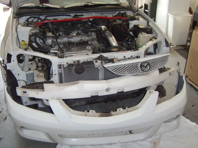

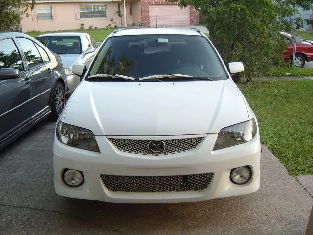

Followed this thread step by step. Thank you!! only trouble i had was after baking the head light being able to open it up. I found the trick was right after 10 min take it out and start prying the top edge with a flat head and do the whole top. Once you see it start to seperate just pry it with your hands and the bottom should come apart as well. GOOD LUCK TO ANYONE WHO ELSE TRYS THIS! PICS!!!
