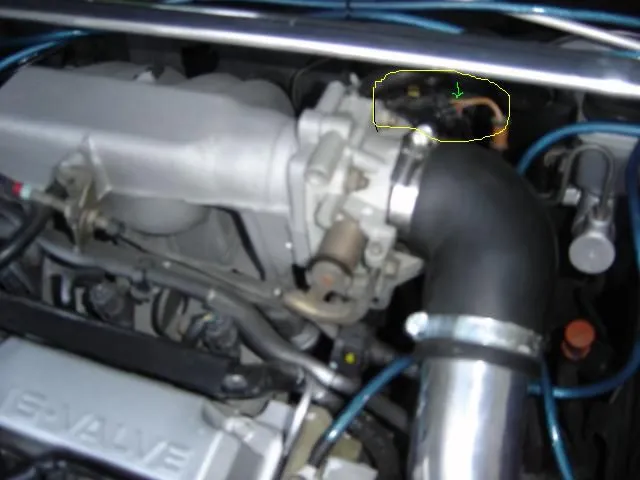

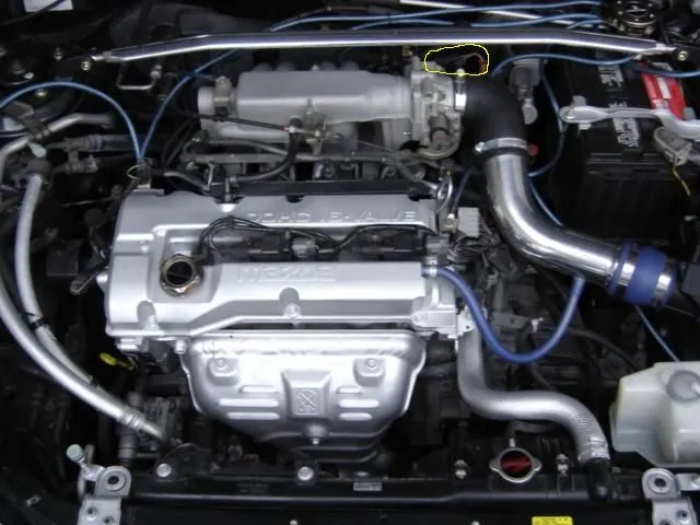

well as u haave seem in the pics i don't have any wire with foil going to my ecu so (shrug) duno what to do and ther is no o2 sensor for sure the problem is that my car in no american version it is a japanes one so would that be de problem??? but it doesn't have any o2 sensor for sure i looked and nothing,i also wanna know the air fuel ratio gauge how does it light up starting from one side green light right? and when the car is just on the first green light stays lighted just one led or should it turn on more leds?!?!??!?!

Hey !!!
well i connected to where the pics show and it is working great !!!
dominoy2k1 said:
it should show numbers on the ends of the wiring harness. . it should be like 1-40,41-80/81-120. something like that. check the picture.
