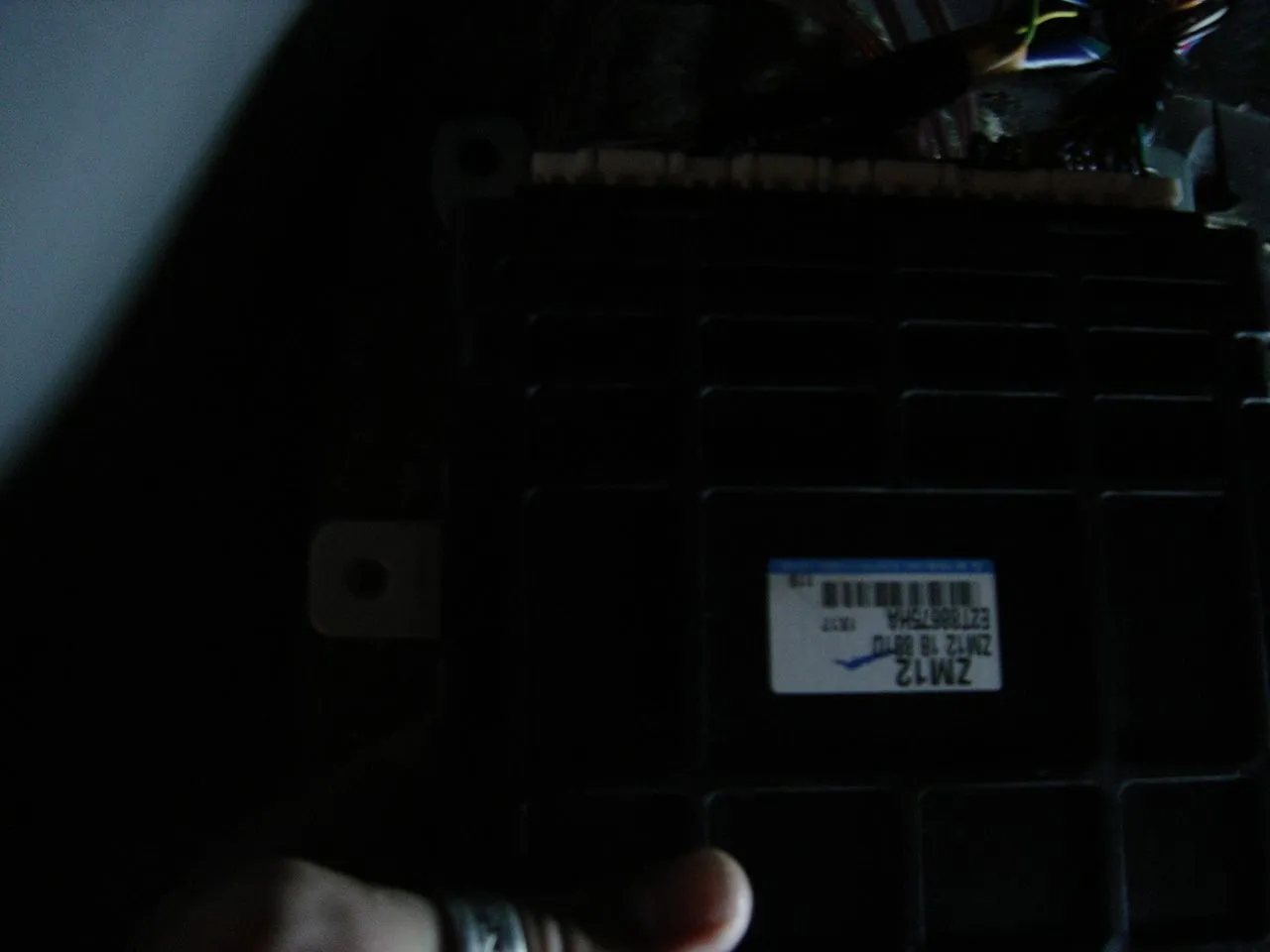

Hey how are ya man well i want to install an air/fuel ratio gauge i tried to find the o2 sensor but it seems that my car doesn't havethem cause here in santo domingo there is no pollution restrict so i just have to go to the ecu i got some pics of it and tried the pink bule wirte one but nothing and also how to count the pin so u can see the pin #60 thanks.

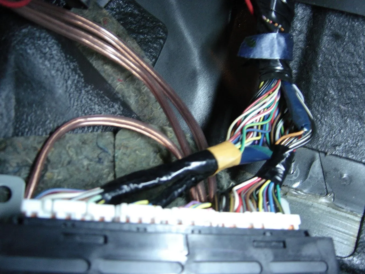

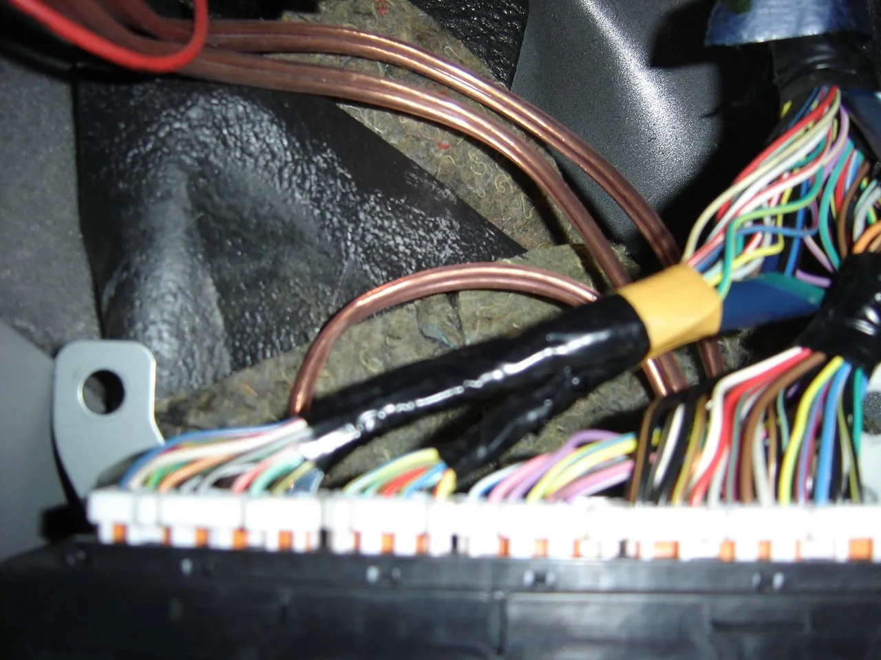

Pick a place. If you splice in at the ECU, the wire you need is coming from ECU PIN # 60. This is the signal wire. It is a Pink Wire with a Blue stripe (P/L).
The ECU is located on the passengerside, under the carpet. You will need to remove the doorsill, and the passengerside kick pannel to pull back the carpet. The ECU aluminum cover plate will then be visible. This is where you will need the 10mm socket, as there are 4 nuts holding it in place. After removing the nuts, you will need to flip the metal cover over. I advise use of leather gloves, or a cloth to handle the edges of the cover. THEY WILL CUT YOU!! After fliping over the cover, the ECU will be visible. The ECU harness connector has a bolt holding it to the ECU. Time for the 10mm socket again. Looking at the top of the ECU harness connector, you can see that the pin holes are numbered. Find wire number 60 and splice in there.
Here is a picture of the location of the ECU:
Here are some pictures of where I spliced into my 1st O2 sensor to give you an Idea of the underhood location:
And here is the entire album:

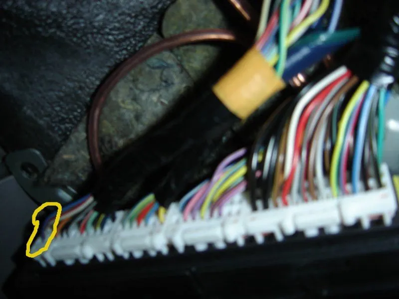

how to caunt the pins to #60!!!
dominoy2k1 said:
dude i think he is refering to emissions. maybe their cars do not use o2 sensors. its weird though
from where to begin counting thanks!!!! or how to know which is pin #60
The blue/pink wire is real easy to get to on the o2 sensor. I would assume the wire is blue/pink on the ecu also.
well i will have to try it but i was afraid to do something wrong i was thinking to try each wire in the ecu to see but would that affect the gauge or something?!?!?
it should show numbers on the ends of the wiring harness. . it should be like 1-40,41-80/81-120. something like that. check the picture.
