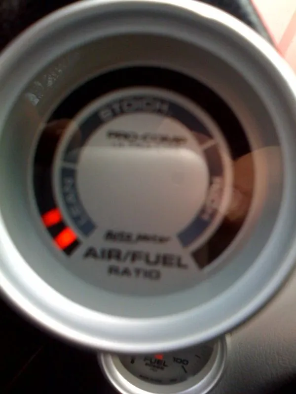

OK so the gauge works now but....its just showing red the bottom light is constant and the second light is flickering. Right now i have the 12v hooked straight to the battery and the ground hooked to a wire connected to the battery. and the purple wire is on the first O2 sensor spliced with the pink and blue wire. Any ideas? And yes i did wait for it to warm up.

hmmm.... does it move at all when you tap on the throttle?
i know EVADE (effren) hooked this same gauge in his car... he might have some knowledge to share with you
Nothing happens when I press on throttle. I also have very poor idle when I'm sitting at a light. (less than 500 rpm)

I used this guide and went straight to the ECU pin out. Worked fine. Pretty worthless though. Narrowband AF gauges are just a light show. Not sure why they still sell these.
