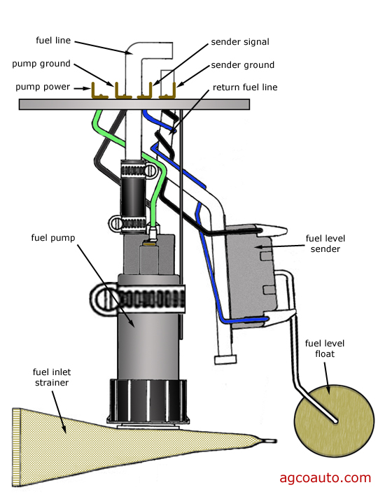

interesting...I did not know that. How does the fuel cool the pump? via the pump's exterior surface (if the pump is submerged) or via interior flow? In the latter case, the cooling should be independent of fuel level. the intake tube of the fuel pump obviously needs to be submerged.
The ones I've seen look like this. (totally submerged) I have no idea if Mazda's are the same.
gotcha, thanks! if Mazda is similar, then it make sense - 1/4 tank gas would help fuel pump cooling.
The theory is that fuel is used to cool the in tank fuel pump. As the tank get's real close to empty there's simply not enough fuel to cool the pump at peak efficiency. That's why the rule of thumb is to refuel at around 1/4 tank.
No, the 1/4 tank fill-up recommendation is good because you are unlikely to run out of gas that way. The in-tank fuel pump doesn't consume enough electricity to ever get hot enough to worry about - it's the fuel running through the pump that's critical (primarily for lubrication of seals) but there is some heat transfer there. The fuel pump will not overheat when not submerged. No worries there.
