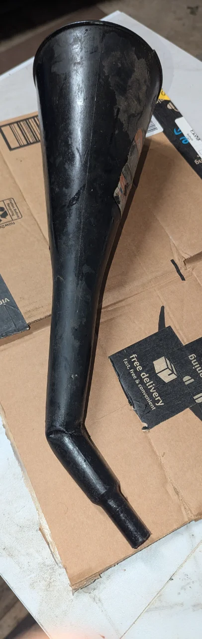

There is a dipstick, but it can be hard to access. The hole for the dipstick is also the fill hole, but because of the location, you'd need a very long funnel or two to pour the ATF without spilling it everywhere.

I have a transmission funnel that I heated with my heat gun, and bent it at a 45 degree angle. Man, that thing is PERFECT for working on Mazdas!
I use the bottom of a turkey basket with the rubber ball slid off and run that into the fill hole then put a funnel on top of that and it works great

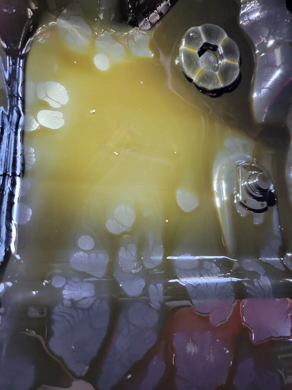

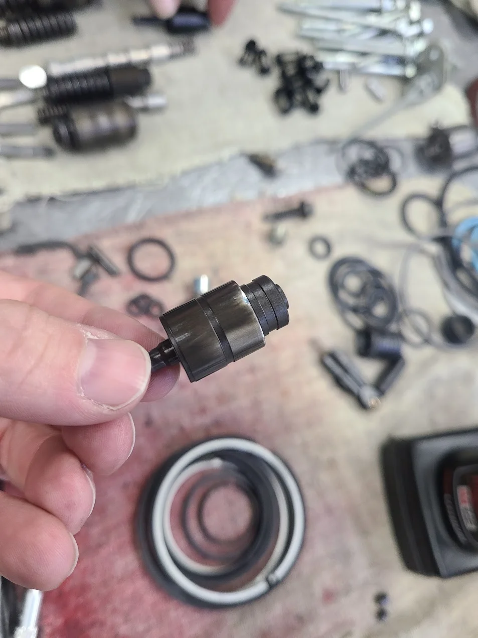

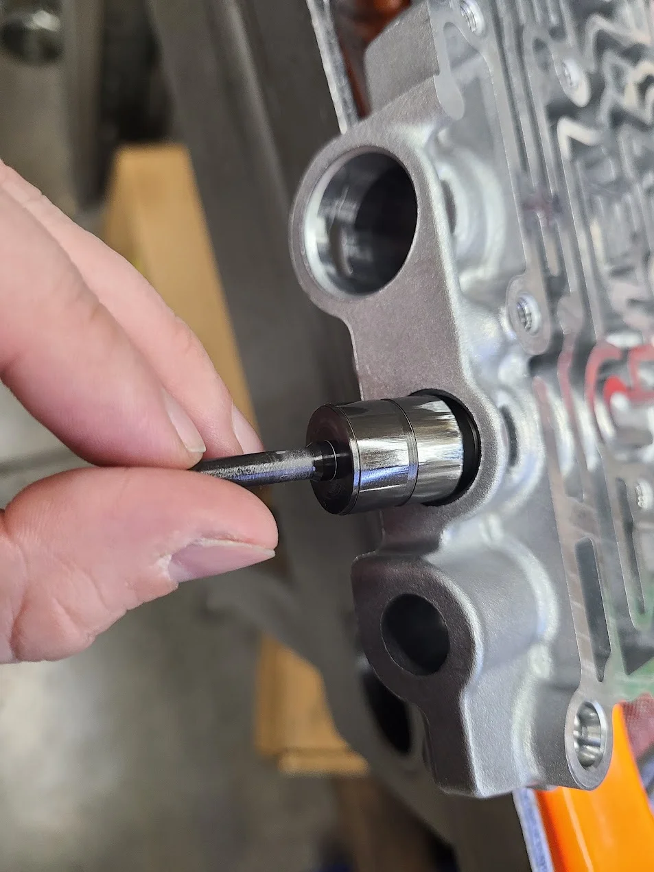

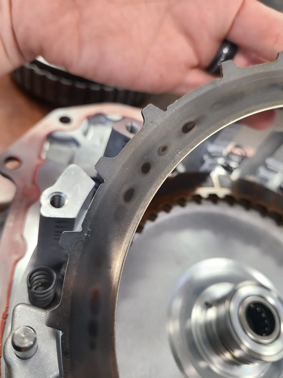

I recommend 30k~ miles for any planetary automatic if it is something you plan on keeping. The valve body is made of aluminum and has anodized accumulators, they move very quickly and begin to wear. That wear gets ground up into very fine particles suspended in the fluid that will pass through the filter. This then gets into the accumulator bores and can accelerate wear. This is not specific to Mazda but any OEM that uses a setup like this. First 2 pics are a worn R-3-5 accumulator in a Sky that failed at ~90k miles, this caused a bad clutch apply especially in Reverse and it scored the steels. It held very poor vacuum. 4th is a typical Sky pan around 30k miles. Using oil testing services will also not show this type of wear generally, this unit came back with no elevated numbers at all.
