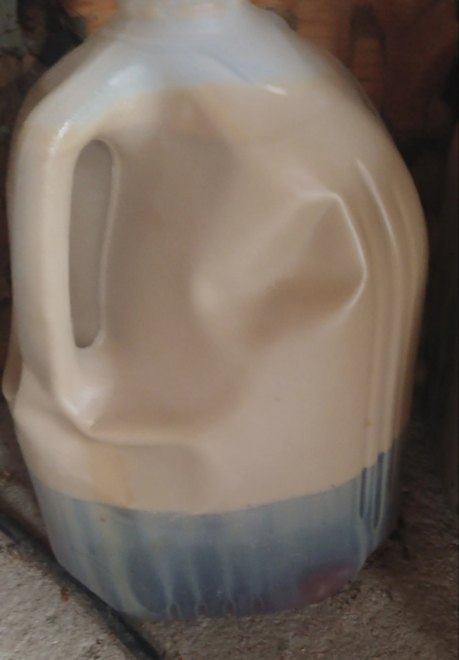

Head gasket blown? 2014 2.5l CX-5
Absolutely do a compression test if you have the ability. Sounds like a blown head gasket. I'm actually surprised a lot more of this problem hasn't cropped up with the high compression and all.
I'm going to check the compression later today but in the meantime drain the coolant doesn't look good.

I still think it's not a head gasket. Too much coolant in the oil.
You say it's still running? I would just replace what's wrong and roll the dice to see how far she'll go. That all depends if you continued to run it after you detected the problem.

If there's coolant in the engine oil then you have this slime for a lubricant between your piston rings and the cylinder walls and everything else, I wouldn't trust it. Another engine isn't far off base...
Car is fixed. In the end replaced the engine. It was a crack in the cylinder head (less cost for replacement engine from a salvage yard than new head). Best guess on what happened is had a small coolant leak that went unnoticed finally got low enough and caused engine to overheat and cracked the head (I had heat working on previous drive). My fault for not regularly checking coolant level lesson learned and should have pulled over immediately and not driven several miles to the next exit (but stopping on the side of highway in freezing temperatures was a good excuse not too) . Also learned to appreciate more the cars with low coolant and oil sensors as well as a functioning temperature gauge. The temperature warning light does not come on until it sees 250F (120C) maybe it was running hot for a long time just don't know. May move on from the CX-5 after this experience but will still be in the Mazda family still love my MX5.
