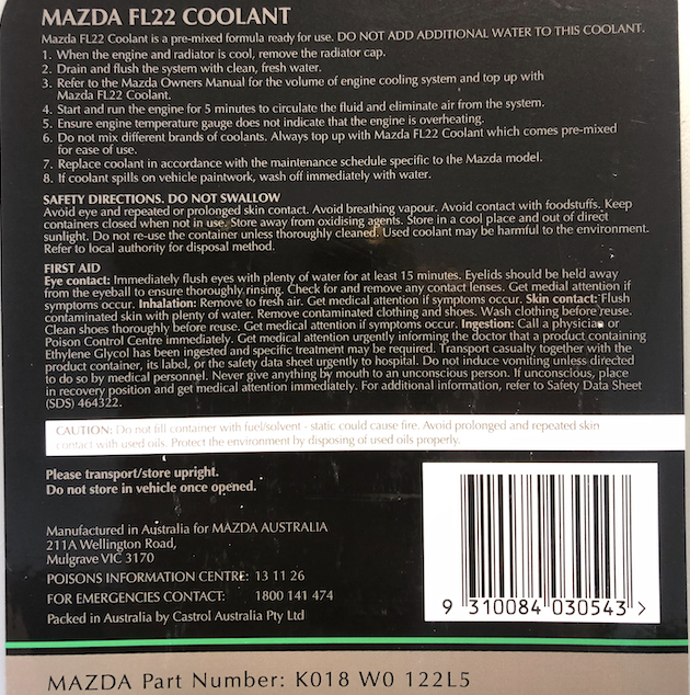

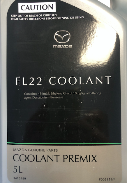

Detail from the FL22 5Litre Container Labelling & MSDS
Refer to SDS 464322
Bar Code 9310084030543
P002159/F
3415489
Contains: 451ml/L Ethylene Glycol 10mg/kg of bittering agent Denatonium Benzoate
Mazda FL22 is a premixed formula ready to use. Do not add additional water to this coolant
Do not store in vehicle once opened
Keep out of Reach of Children....& Muppets
Manufactured in Australia for MAZDA AUSTRALIA
Packed in Australia by Castrol Australia Pty Ltd
MAZDA Part No: K018 W0 122L5 5lt 55/45 Premix: AUD$180
Fig[1] Mazda Genuine FL22 Oz Front
Fig[2] Mazda Genuine FL22 Oz Rear
Refer to SDS 464322
P002159/F
3415489
