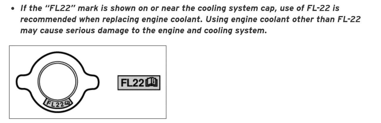

My 2016 and 2020 came with green coolant. You should use the Mazda specified coolant as the formulas impact water pump seals and all gaskets.
Per 2017 CX-5 owner's manual, FL22 coolant is recommended.

On the other hand, in CX-5 owner’s manual:
The engine coolant change schedule is:
Replace at first 192,000 km (120,000 miles) or 10 years; after that, every 96,000 km (60,000 miles) or 5 years.
And the remark:
*2 Use of FL-22 is recommended when replacing engine coolant. Using engine coolant other than FL-22 may cause serious damage to the engine and cooling system.
The key to me is you don’t “mix” the factory FL-22 coolant with different types. Without knowing the maintenance history, who knows if the cooling system of that CX-5 had been properly “flushed” before refilling with the “bright” green coolant? Especially there’s no cylinder block coolant drain on the engine, mixing the much cheaper “bright” green coolant with plenty of old FL-22 which is not easy to flush out is highly likely. Then the question remains, why the previous owner would bother to replace the factory coolant before 80K miles?
Mazda recommends FL22; they do not require it. That you may cause serious damage using something else is kind of obvious since you could use a non-compatible product. There are compatible products that don't say FL22 on the label. Mazda is more direct in talking about using Mazda branded motor oil and (almost) nobody buys that recommendation: "Mazda Genuine Oil is used in your Mazda vehicle. Mazda Genuine 0W-20 Oil is required to achieve optimum fuel economy."
