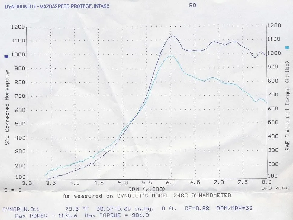

By the way, attached is a dyno of my car with just a short-ram intake. Beat ya. (nana)
