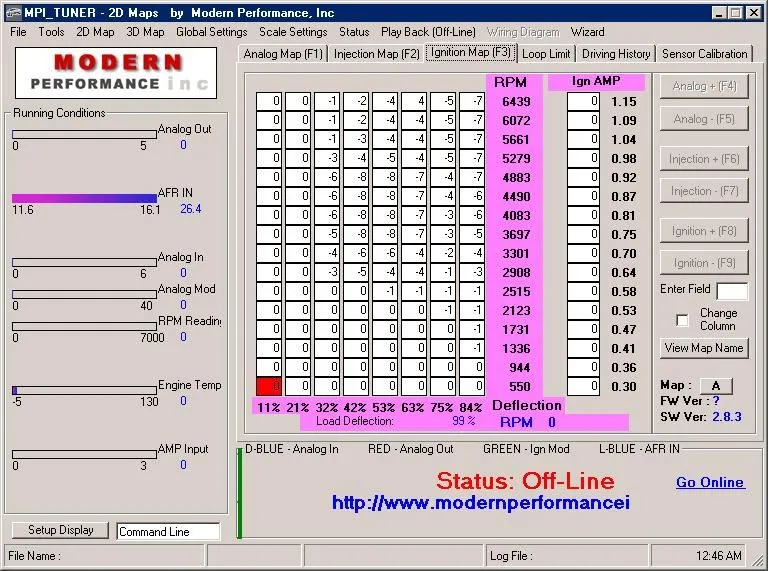

This setup is working pretty damn well. I drove to work again tonight, and did some tuning on the timing map. I had to add some retard on the real on the midrange area. Tim, I think you would be interested in my new map, so I will post an attachment. Even with the new retard values, I still have some work to do up top, but everything is looking up!
