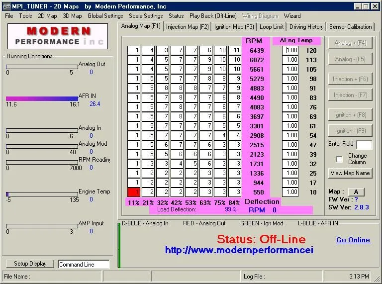

Well, I just finished removing this from the ride:
I must say that my off-throttle response is a little more responsive, and I was still able to hit 4 PSI of boost with the analog fuel map attached below. One thing I did notice when I 1st started it up is that my vaccum reading on my boost gauge was below 20 inch AFTER warm up. :wtf: Well, I started checking for vaccum leaks, and could find none! So I started driving around and realized something. The needle eventually settled where it was supposed to at idle right below (between 20 & 21 in vac) the 20. I guess when something that uses a vaccum signal is taken out of the system, the car has to recompensate, and adjust. I wonder if that is what that solenoid that the stock FPR goes to does? Well, later I will be adding some fuel, and relocating my Air Temp Sensor to a cooler place than where it is now. Mayby I will snap a shot later of where it is located for those who do not know!

Ok, my car is officially doing the same s*** it was before. Maybe I haven't added enough fuel yet, but I'm already up to 19's!!! The clamp IS still clamping the voltage at 350-365 mv. My fuel filter stuff is here, but I have to wait till next Friday to pay for it. :( I still haven't gotten the other injectors from my friend yet, so no testing there yet either!
Well, after examining the playback logs from my drive home from work yesterday was that even thought the Nology PDA Dyno is telling me that the 02 sensor voltage is being clamped at 350-365 mv, the MPI software is telling me that when I'm hitting boost, my voltage is closer to 1 v. I know this because I added the AFR Input Voltage to my list of Running Conditions in the MPI software tonight. If this is happening, this is not good. That would explain why I am still leaning out, and having to raise numbers in the analog map. I find it interesting that even though my OBDII logger is telling me the voltage is clamped, the MPI is still seeing a higher voltage under boost.
