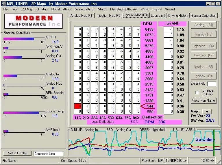

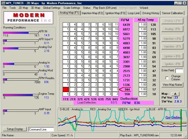

Tonight on the way to work was really interesting. Remember last, I changed my values to 8's and 9's for high values? Well, I changed my numbers in the 2nd column to mostly 3's from 4's, and things seemed to flow better. Midway thru my drive to work tonight, I downshifted to 4th gear, instead of hitting it in 5th, and I got riatch biatch!!!! (eekdance) Well, from then on when I hit it in 5th gear, it seemed like my whole fuel curve had moved down, and I was able to boost 5-6 PSI no problem. Well, I just watched the playback logs, and noticed A/F ratio in the MPI software was showing 13.7 at the lowest point which means that the FM voltage clamp was doing it's job well again. I wonder if I got a new FM voltage clamp, would this be a more consistant result? It would suck to buy a new FM clamp, and it not do what I want.
My current Analog and Ignition maps after tonight:
Analog and Ignition:
