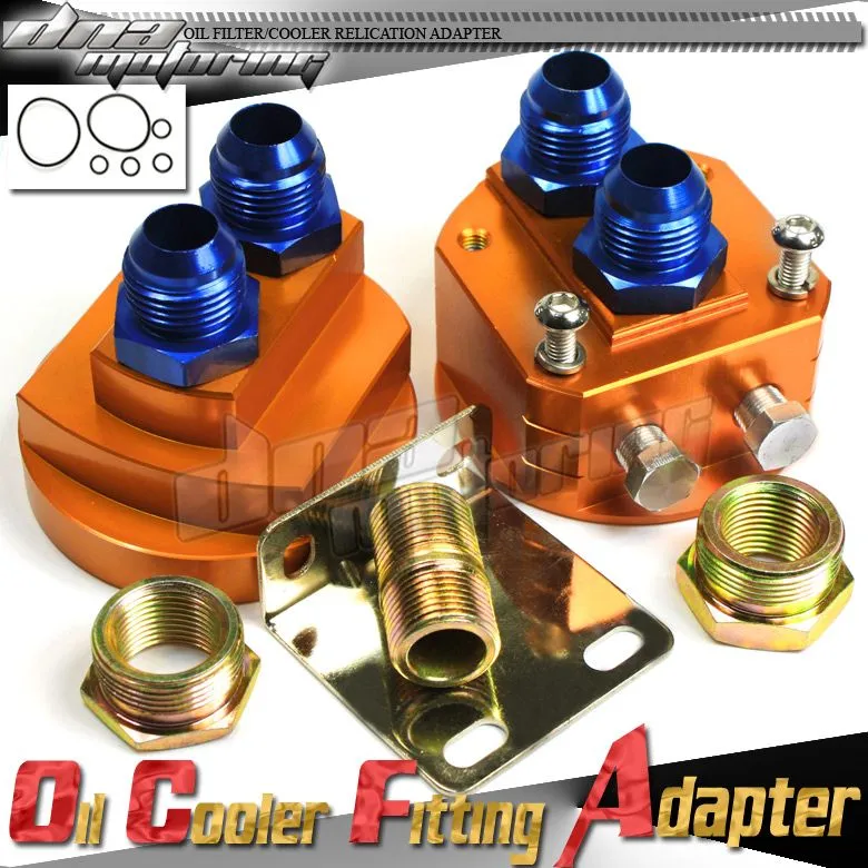

Sorry I cant speak from experience, but I personally would not recommend it. Think about the size of the fittings on the sandwich plate. They are made for sensors... WAY too small. The pump is able to kick out enough pressure to make my AN-12 lines flow with no problems and much more room to go. Thats 3/4" lines versus the what? 1/8" or 1/4" npt? It just wouldnt be worth doing if you went that route. Besides, they could not have picked a worse place for the oil filter on our car. You want to relocate it regardless!
I completely agree with you, was leaning toward the relocation as it was lol.
Any certain brand of relocation kit that is better than others? Or just go with an ebay special?
Heres the one I bought: http://cgi.ebay.com/ebaymotors/OIL-...ptZMotorsQ5fCarQ5fTruckQ5fPartsQ5fAccessories
I modified the hell out of it though. I used my die grinder to eliminate the sharp edges inside and made the passages way bigger for smoother flow. I also bought AN-12 lines and had Tom ship the regulator with AN-12 fittings on it. Drives the price up a bit on the whole install, but to me the added capacity was worth it. Plus I wanted to see if the pump could handle it, and it does VERY well. I have a HUGE Peterson oil filter (washable stainless mesh) and a nice size Setrab oil cooler in the system as well. The pump handles all this so easily! Easily the best upgrade EVER!
