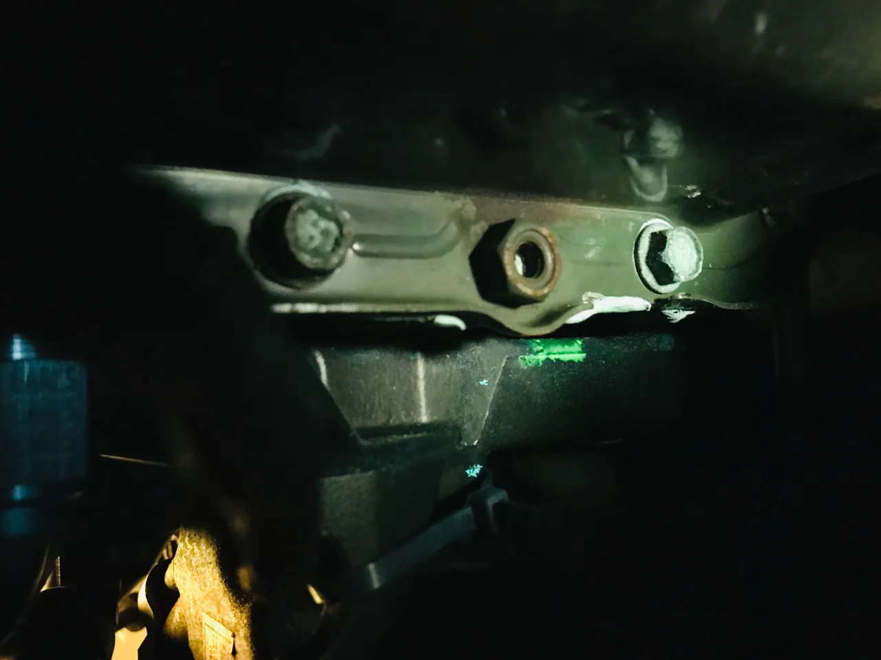

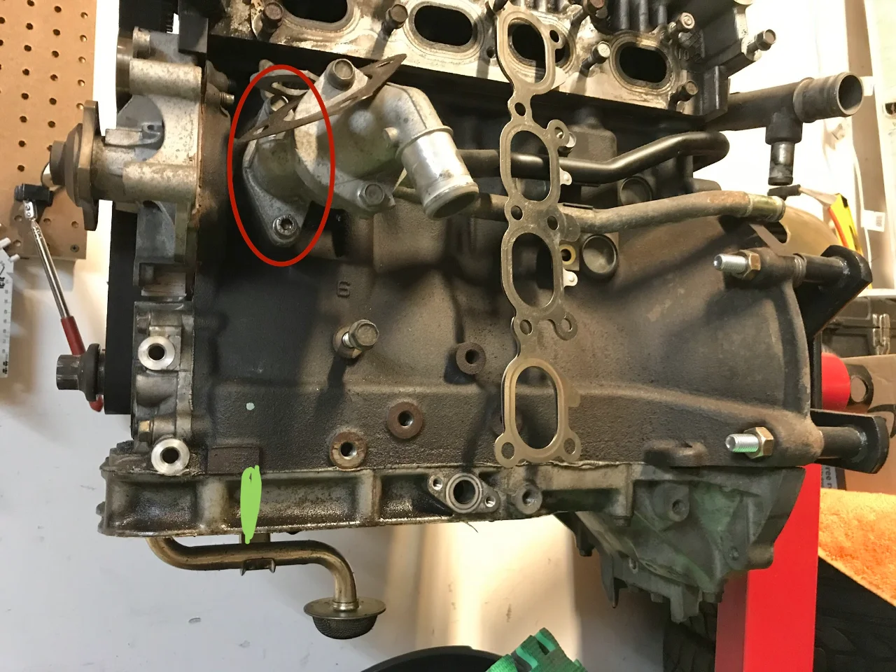

Update on the coolant leak. Car is still on jackstands and I placed cardboard under the car to see if I could catch any leaks. Spotted a leak on the cardboard last night. Picture 1 is where I found the leak on the car. For reference, picture 2 is of my spare block where I found the coolant marked in green and possibly the source of the leak circled in red. Since I'll be in that deep to replace the tstat to block gasket, I'll be replacing the tstat seal as well.

After work, I was cleaning up the garage a bit and remembered I had an inspection mirror. You can see it on the last pic hanging up on the cork board lol. I used it to inspect the tstat housing where it mates to the block and that was where the leak is. Managed to fit my hands and tools in there to tighten both bolts. They were loose but not terribly loose. Probably a product of my solid motor mounts. Hoping that's the problem because simple fixes are the best fixes🤞
Had the same problem a few times. Once it stopped for a year or so, then I had to replace the gasket.

It's been 10 days. Seems tightening up the 2 bolts fixed my coolant leak! Also reinstalled my front strut bar. It's been off since mid May when I was replacing all my AN fittings lol.
