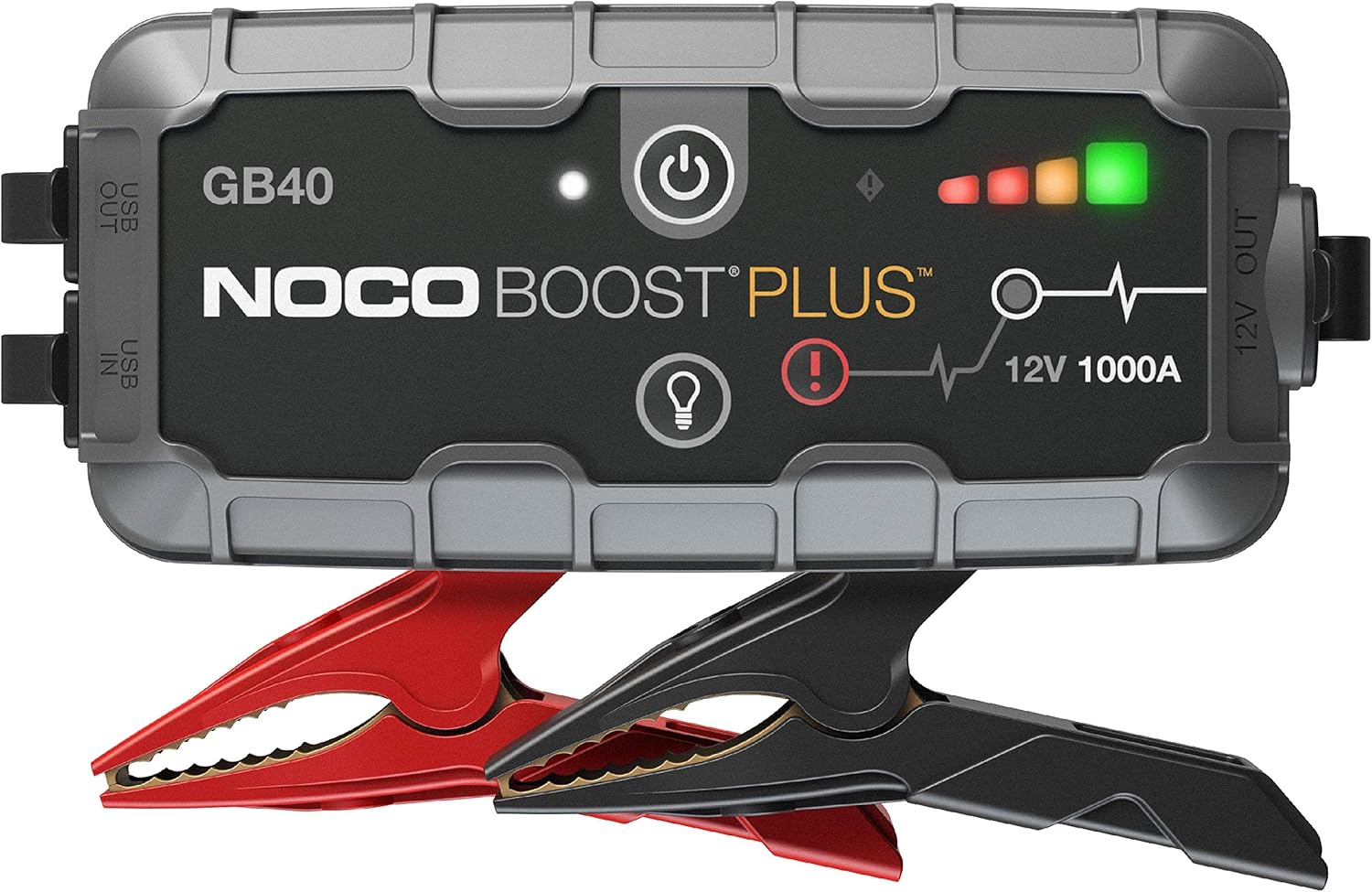

About 2 weeks ago, attempted to drive the msp on a few errands but the battery said nope. I picked up a NOCO GB40 booster pack that same week but it continued rain for the next 2 weeks or so. Finally had some sunshine over the weekend. Before using the booster pack, I measured my battery which read 9.65 volts haha. Hooked up the booster pack and the car started up after about 5 seconds of cranking. What a great and compact device!
Since my OEM positive battery terminal was stretched out, I ended up changing those out too. Nothing fancy, just the ones you can pick up at the store. Been meaning to change it out for a few years now but I'm a slacker. For those wondering, I just shimmed the old loose and stretched out terminal with a bent washer.
RPRP5
2002 Mazda Protege5
NOCO GB150's are commonly used to start lots of cars in a row/without having to recharge the pack, so you've made a good choice!

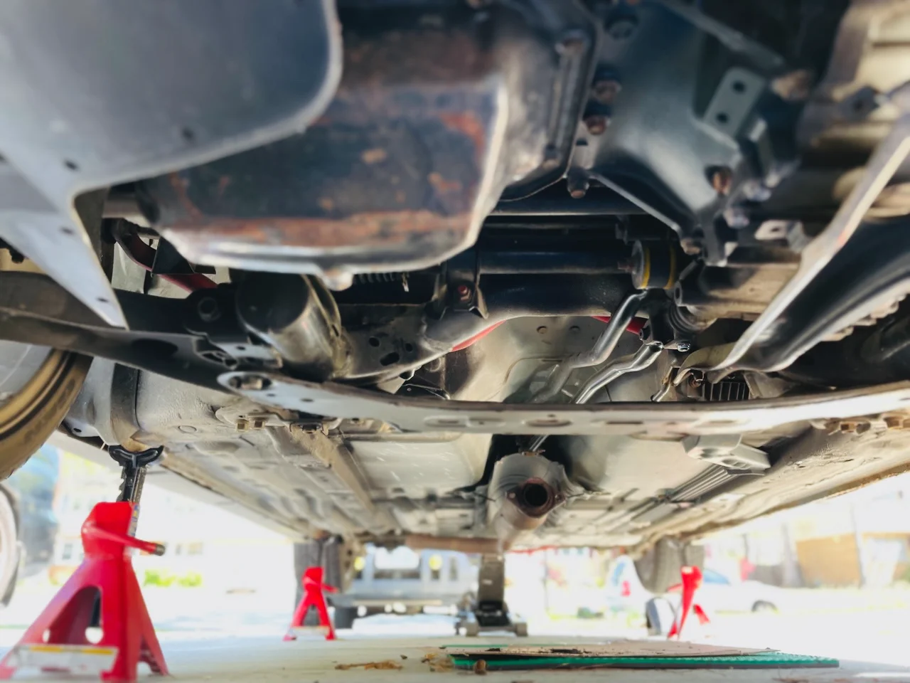

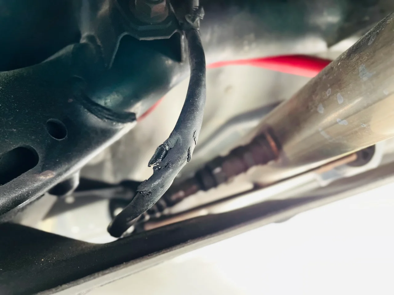

Finally got a chance to finish installing all the shifter bushings. The last one was the one that connects to the trans. Went to remove my midpipe too and found what looks like chew marks on my rear o2 sensor wiring. Have a lot of squirrels running around our hood. I should have a spare from my old protege somewhere unless I donated it to the p5 I previously owned.
323
(u_u) ...zZzZzzz
Moderator
surprisingly, i have no photos for this update. reinstalled midpipe, repaired wire on o2 sensor, and fixed a leaky oil drain fitting. thought I had another O ring laying around for the oil drain but i didn't. i did have a gasket but upon using it found that one of the holes for the bolts to go through was too small. being tight on time, i just reused the O ring this time around and added a little rtv.

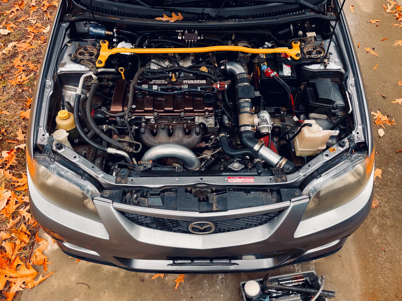

Hey! I'm still alive. Guess I should post an update since it's been forever. Since becoming a father, it's been a challenge to find time to do anything without taking time off from work. Being that young children get sick often, I've been hoarding all my off time. Did switch jobs this year too so that took a lot of prep and adjustment. I always have the idea of doing car things when the boy goes to sleep at 8pm but yeah... I'm tired by then lol. Occasionally I'll hop in the car and run a few errands. Well, for a few months, I've been getting hesitation under boost but couldn't find the time to troubleshoot it. I've been trying to do these things as fast as possible on my lunch/mental breaks. Tried checking and regapping my plugs which didn't work. FINALLY, did a boost leak test and found two stupid clamps were just loose. Anyway...
Here are some recent photos on random grocery runs. Don't let the photos fool you. The paint is 100% horrible.
And one from today where I pinpointed my boost leak. It was the two clamps on the 45 coupler next to the BOV.
