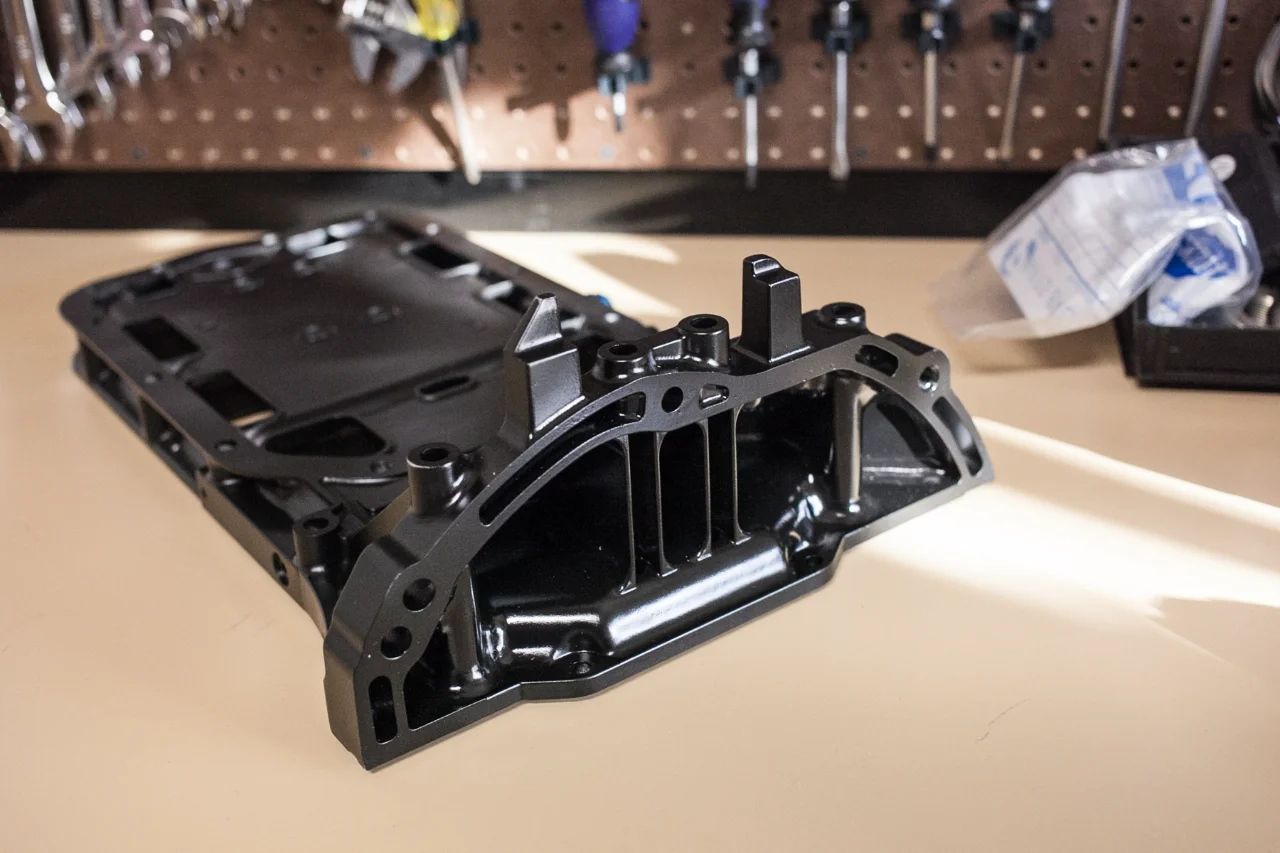

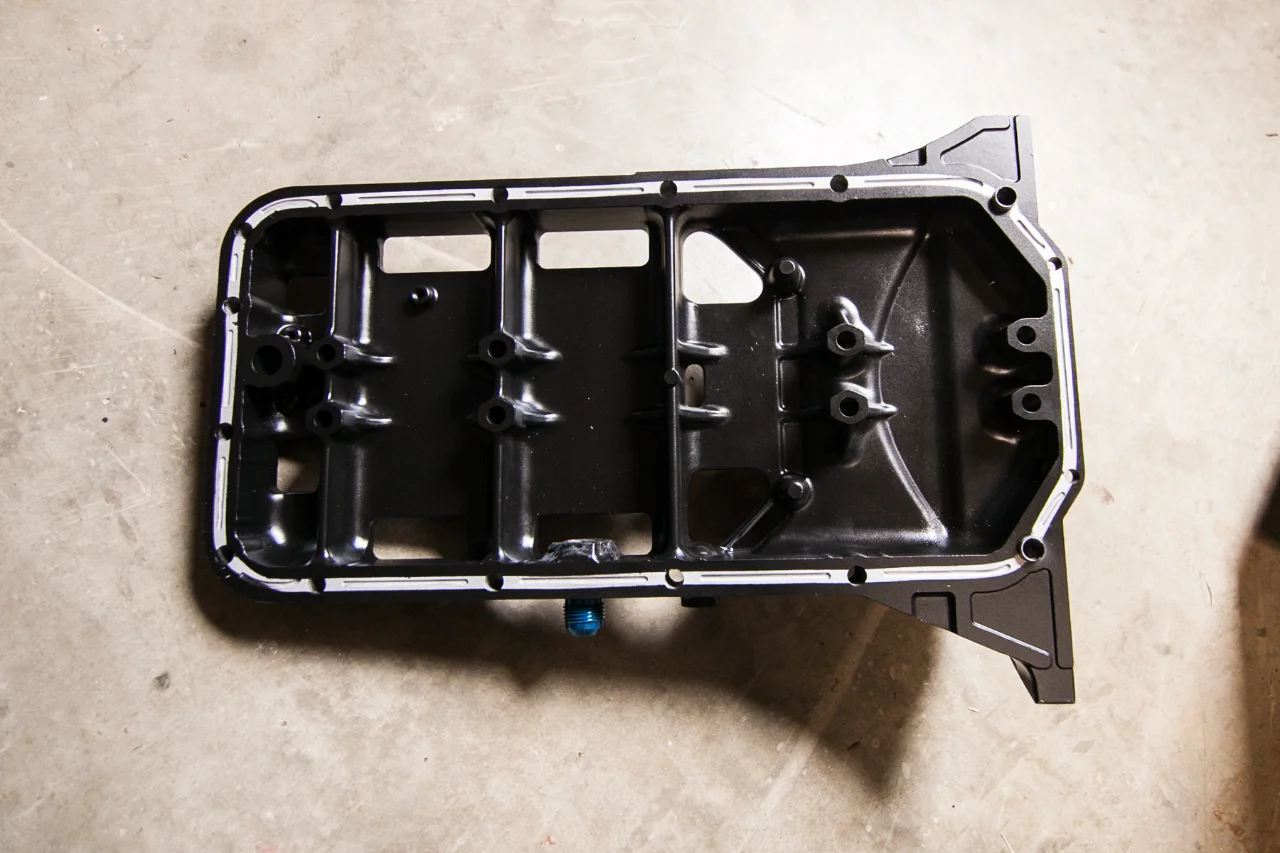

signature sound did an externally bypassed oil pump for me and helped me with a windage tray. welded return fitting and refinished.

Thanks. What should I be swapping to? Only thing that comes to mind is the block doesn't have the MSP one.
The MSP has a longer stud for the oil cooler, just have to get another nut for it and make a jam nut to remove and install the longer stud.
what kind of black coating is that?
Not sure specifically but engine builder loves to paint and coat things. I'd say some sort of high heat semi gloss black paint. Not a rattle can job :)
Thanks. confirms my guess is correct!

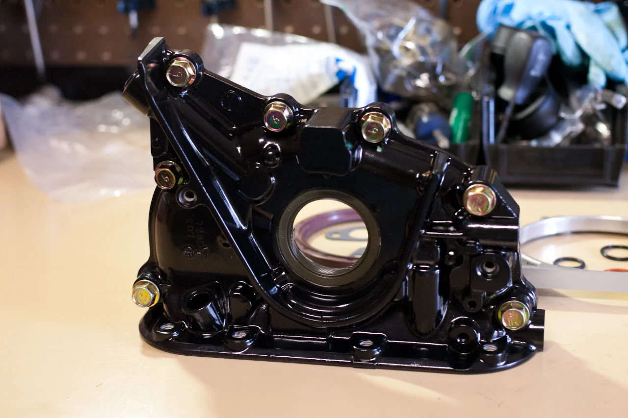

made some progress today. installed the rear main seal retainer, rear main seal, oil pump, and windage tray.
