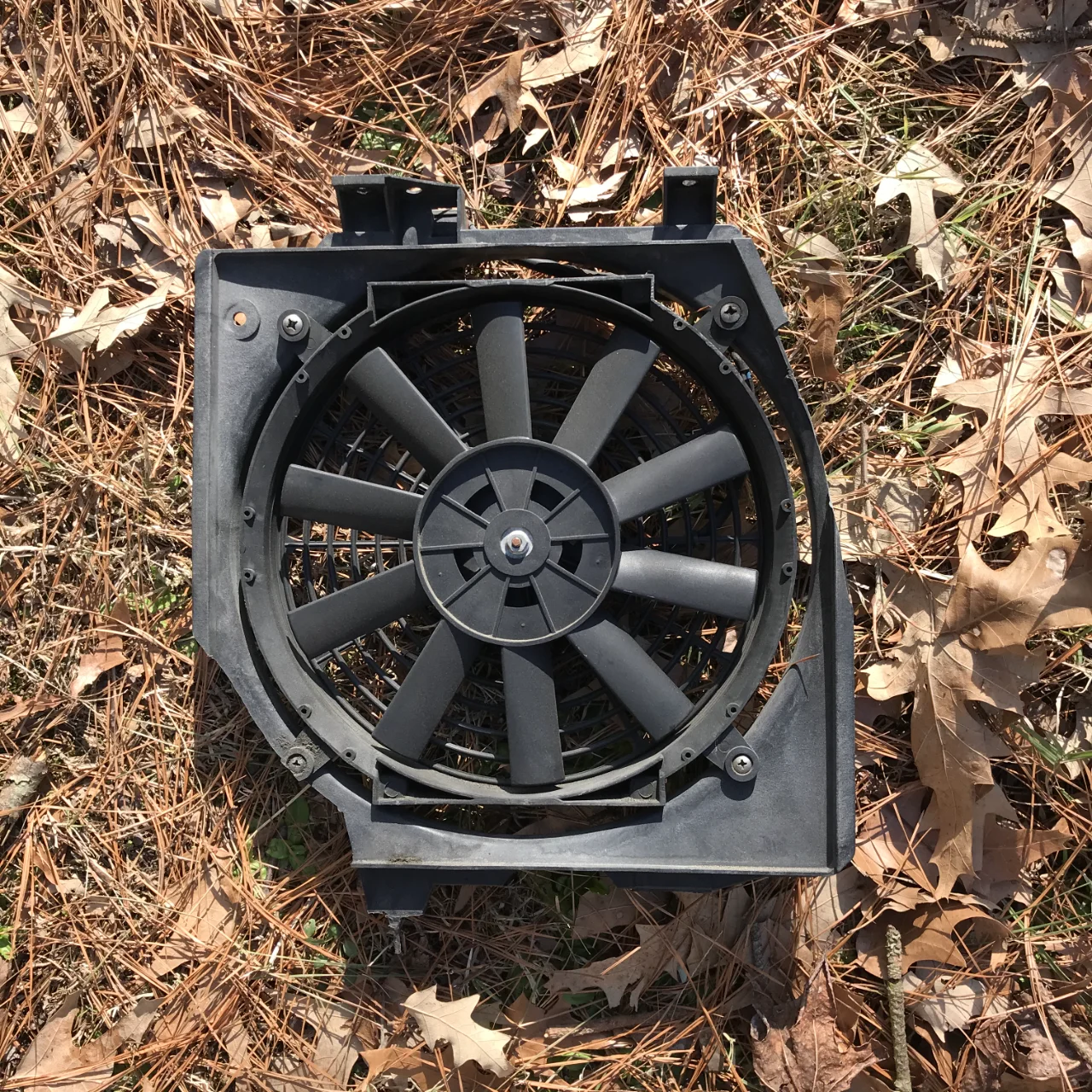

I would also like to share how my friend fitted a slim fan into the OEM fan shroud and shaved down the fan shroud so that my hot pipe would fit properly. This was done over a decade ago. Can't locate a brand on the fan but it's still alive and kicking. To me, it's clean and genius.

Gonna steal that fan shroud idea for mine lol

Thanks! And yeah steal all you want! It's such a good setup. Based on some searching, I found that you just have to heat up and bend the 90 degree part of the oil feed to 45 degrees and it'll fit on a gt28 and I was able to do so with success. My slim fan has arrived too so I'll be tackling fitting it into the stock shroud either Friday or Monday. The good news is after cutting off the stock fan, I'm already able to fit the shroud onto the radiator and fit the intake pipe onto the turbo so not much trimming will need to take place on the shroud. I'm not going to complain about less work.

After installing the new goodies, I then ran into two issues worth highlighting. (1) The stock oil feed line has a 90 degree bend that sits perfect over the stock turbo's housing that wouldn't fit on the bigger 2860's housing. Solution was bending it to a 45 degree bend and it worked. (2) The stock driver side fan stuck out much preventing me from installing the intake piping onto the turbo. I bought a slim fan and fitted it into the stock shroud. This worked out perfect. The fan is a tad small but I imagine it's pretty efficient being inside of the stock shroud. Seems to pull a good amount of air so time will tell.
