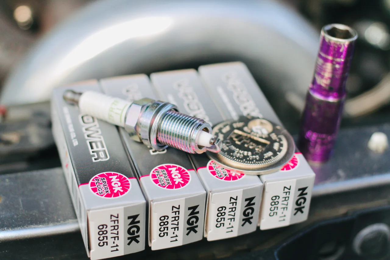

Weather was nice today and the rain held off. Went and replaced the valve cover gasket since it was leaking and letting oil collect near the top of the turbo manifold. Took the opportunity to install one step colder plugs too.

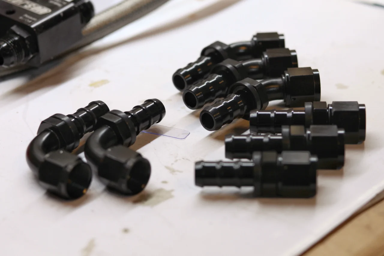

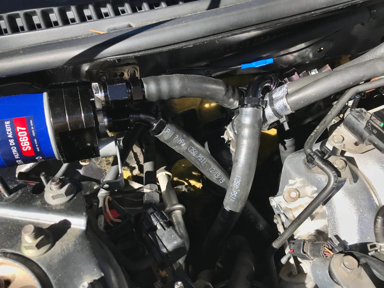

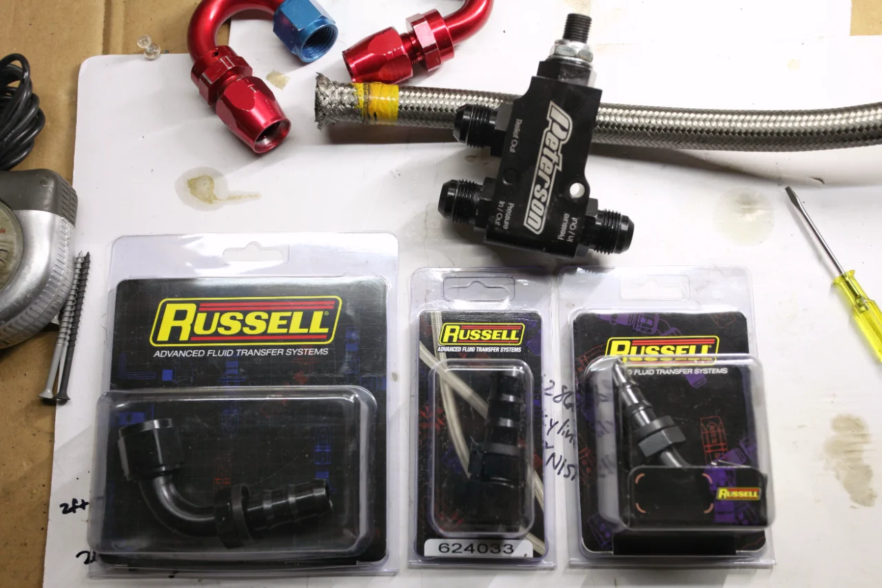

For those of you still with me, yes one of my AN line/hoses failed again. It seems the end closest or on the engine only lasts a good 6-12 months before the heat cycle compromises the hose allowing oil to seep passed hose and out of the fitting. I'm pretty over it and not a fan of working with the braided hoses and chose to change it all out to the push lock fittings and hoses. The brand I chose to run, Russell, calls it Twist Lok as opposed to push lock. All the fittings are here. I'm just waiting on the hose. I've read nothing but good reviews on these setups. The hose is rated for pressures up to 250psi which is way more than the 60-65psi (hot)/75-80psi (cold) my oil sees.
For those considering, I've read that the hose is pretty hard to push onto the fitting and is nearly impossible to remove by hand. The trick is to oil the hose and fitting and heat up the hose a little and it should all go on together easily. I'll report my experiences here when I can.

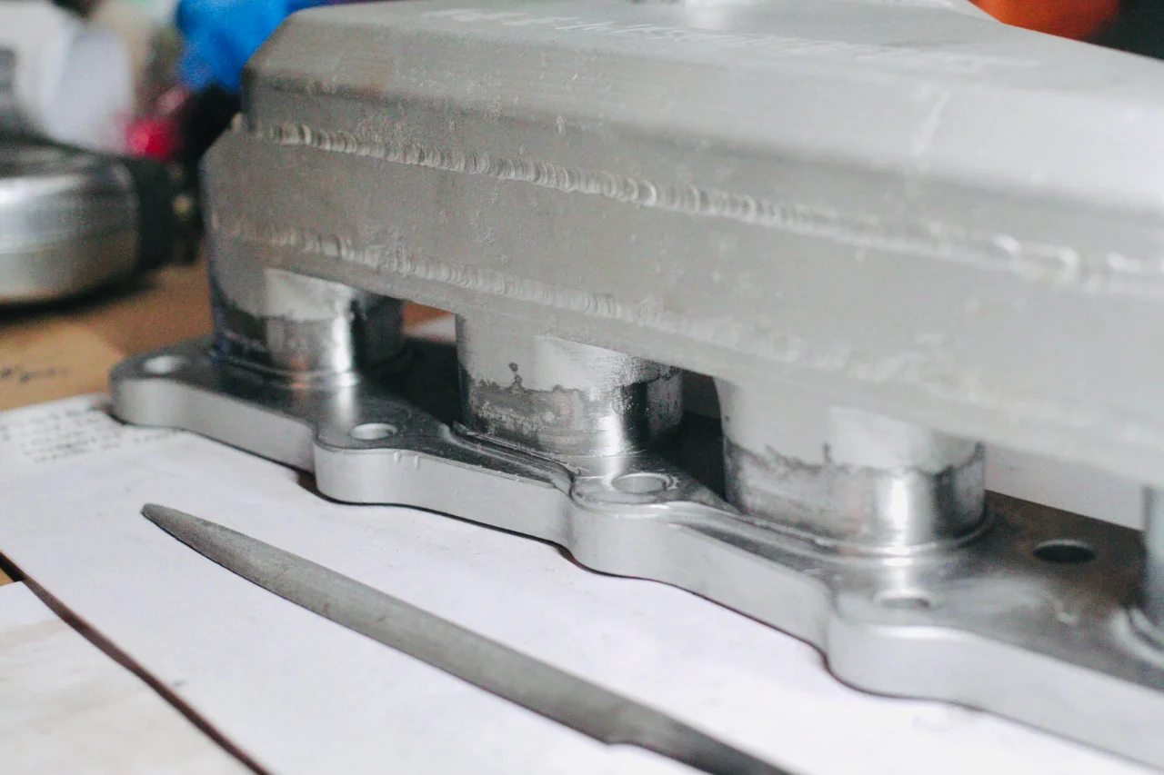

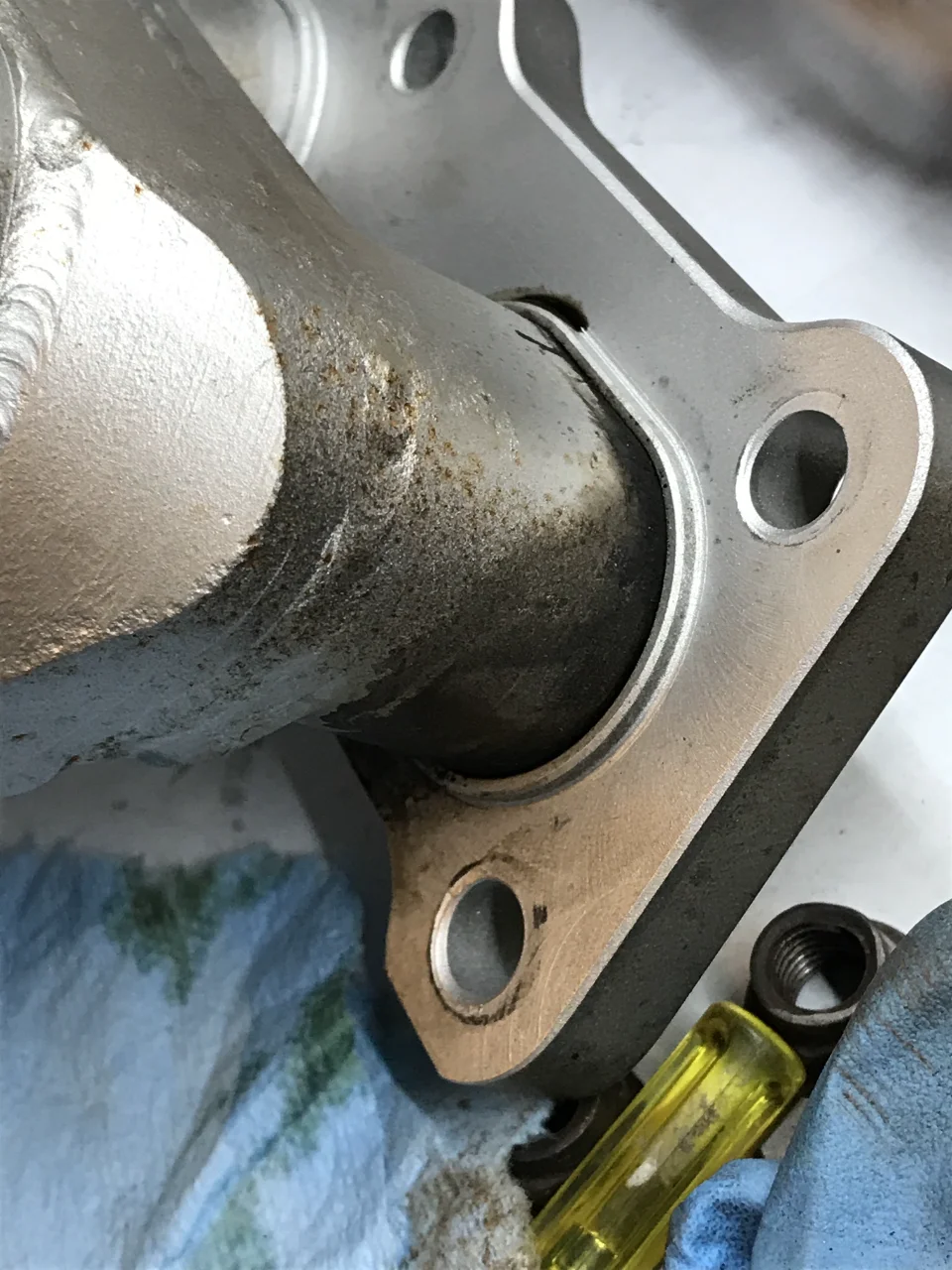

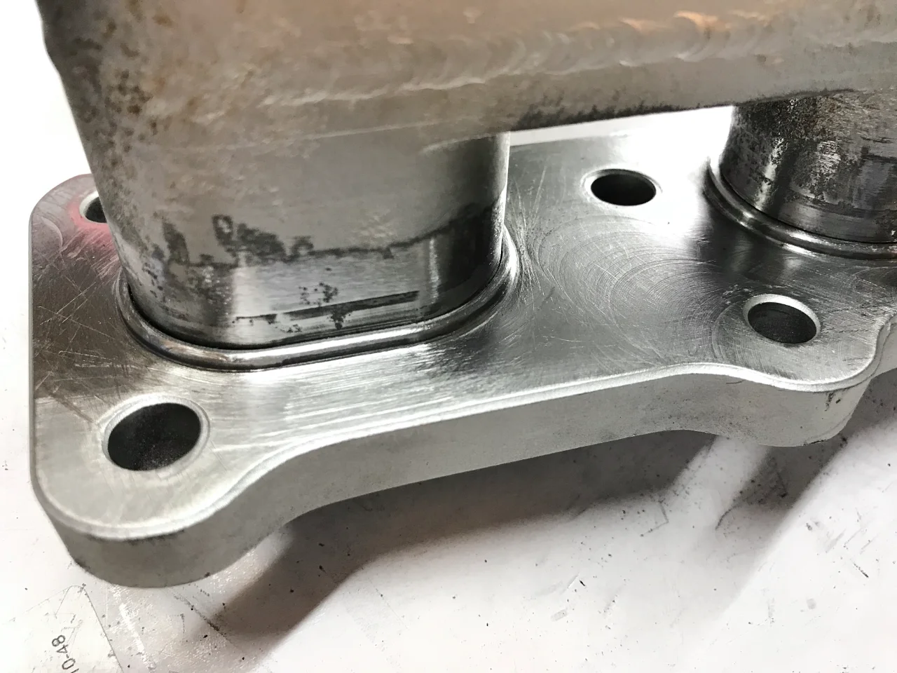

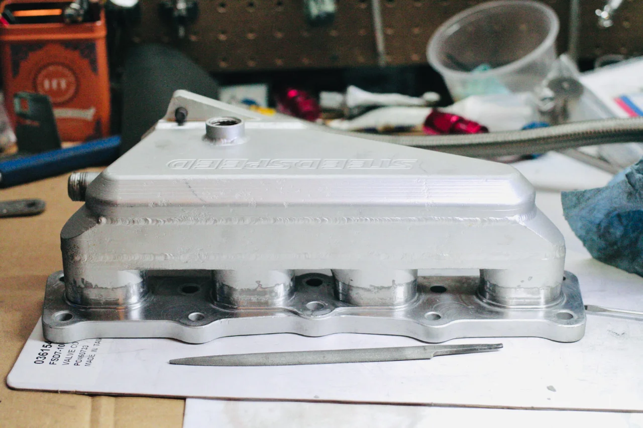

Finally decided to drop off the steedspeed manifold to a friend last week that does welding on the side. He ended up not being able to properly sand down runners #2 and #3. I took it back to tackle that task before returning it which I ended up doing tonight. Filing and sanding off ceramic coating is no easy task. I’d say I’m about 80-90% done. Putting in too much work for this manifold 😒
That manifold is one sweet looking piece, what caused the leak at the runners?
Well I bought it used. To my untrained eyes, I failed to see that there were cracks before ceramic coating it and installing it. Shortly after, the leak revealed itself. I searched around and found that others with this early version of the manifold experienced the same thing and had to get it welded. It’s mainly leaking at runner 1 and 4 and slightly on 2. I’m getting all the runners welded. I will definitely test the manifold before getting it coated this time around lol.

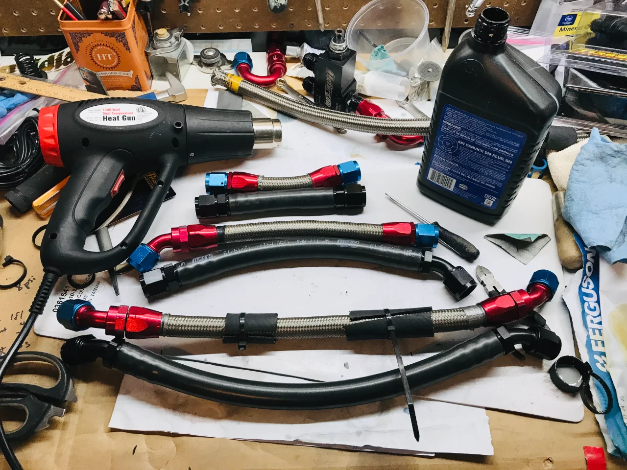

The Twist Lok hose arrived yesterday. The internet is correct when they said the hose is nearly impossible to push onto the fitting without oiling both the fitting and hose then heating up the hose. On my first try, I only heated up the hose for about 20 seconds and it was almost impossible for me to push the hose over the last flare. Luckily I was able to fit the whole thing in a clamp to finish the job. After that, I tried heating up the hose for 1 minute and it worked perfectly. Took a bit of effort but the hose goes on the fitting and seats perfectly. Appears impossible to get the hose off by pulling on it. Videos have shown to use a solder gun to melt/cut the hose to preserve the fitting when you plan on removing it. Everything was nearly effortless except for one line where I changed the setup and used a different fitting so the length of the hose couldn't be determined by the previous hose's length. Had to assemble one fitting, install on car, determine hose length, take it off, cut hose, assemble, and then reinstall.
While letting the garage air out from all the fumes, I went and finished up removing the ceramic coating in small corners and edges on the manifold. I'll be dropping this off next week for welding.
Edit: I wanted to note the mileage of the install which is 131244. As an update, I did encounter a leak but it was my fault for not tightening down 2 fittings enough on the PRV valve which is a pain in the neck to get to btw. Ended up disassembling everything twice to retighten everything properly. Went for a long drive and all appears well.
After a few trips, seems the fittings and hoses are good and dry. On the top side at least. I'll have to get under the car one of these days to double check the 3 fittings on the underside. Decided to put some heat deflection wrap on the lines for the charcoal canister since the oil lines are really close to them and can get really hot. Reinstalled my catch can too. Left it off in case I had to go in here to do work lol.

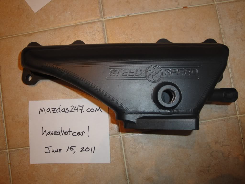

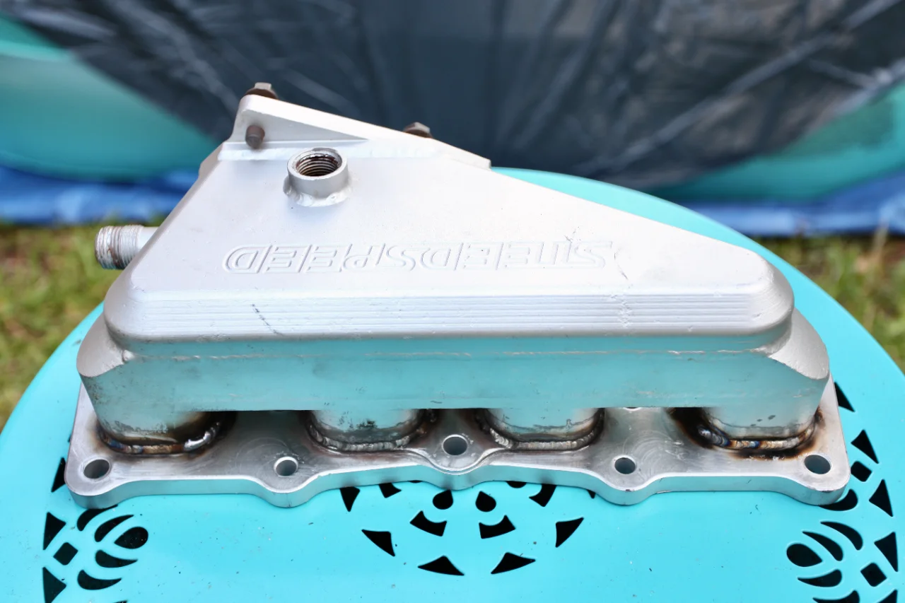

Question, do you know if there are any distinguishing features that you can find to tell apart the early gen steedspeed t2 manifolds from the corrected ones? Also recently purchased and installed a steedspeed t3 from a guy who bought it new early in the group buy. Will have to check for any leaks.
edit: Forgot to mention that I did in fact have a chance to crawl under the car to find the 3 fittings on the bottom side dry so that's some good news for a change :)
I'm positive I have the v1 of the manifold. I haven't done in depth research but from what I noticed, this should be the v2 with welded runners from the start as part of the revision:
And a v3 where the manifold itself looks way less blocky and the new logo:
