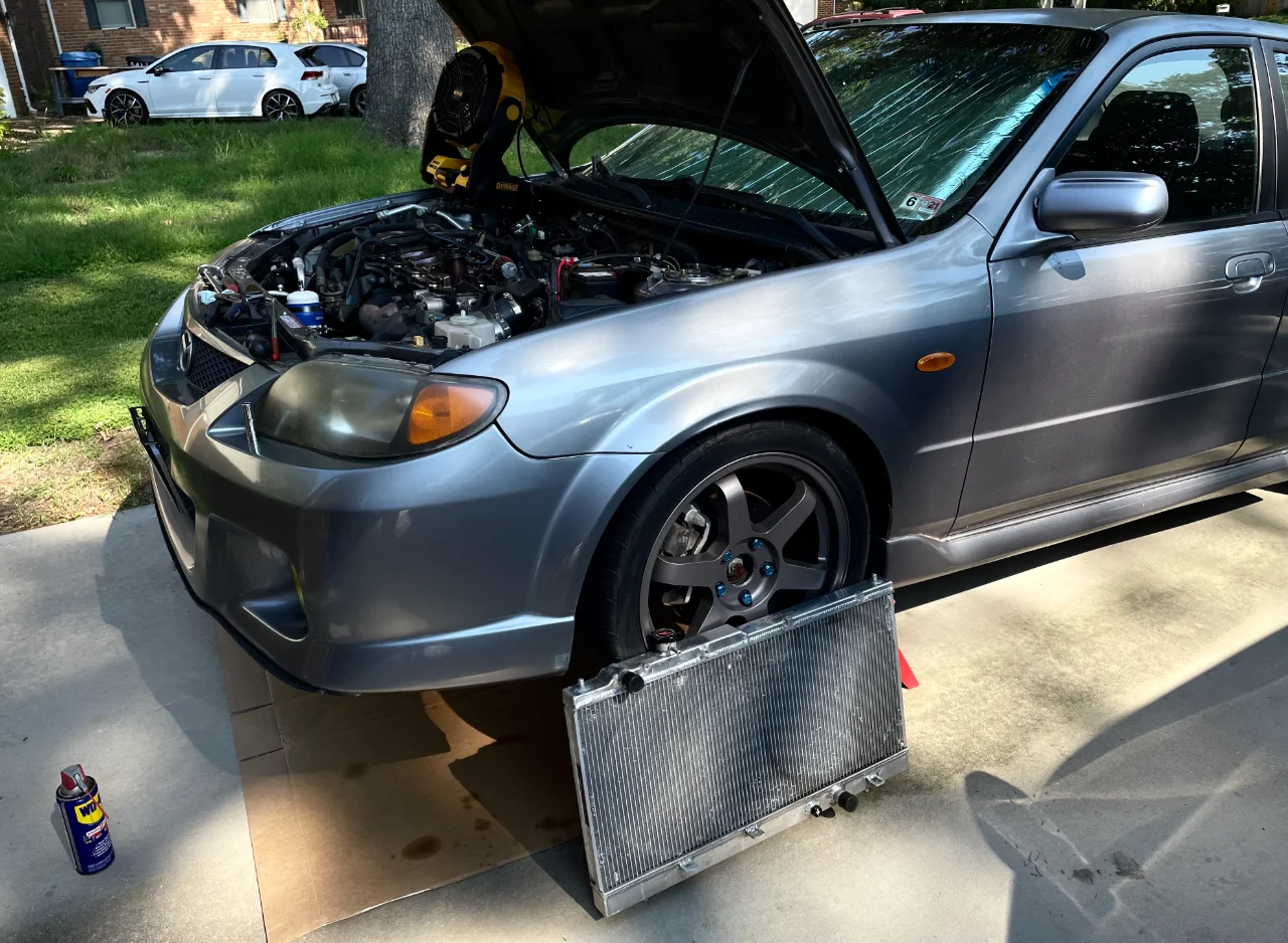

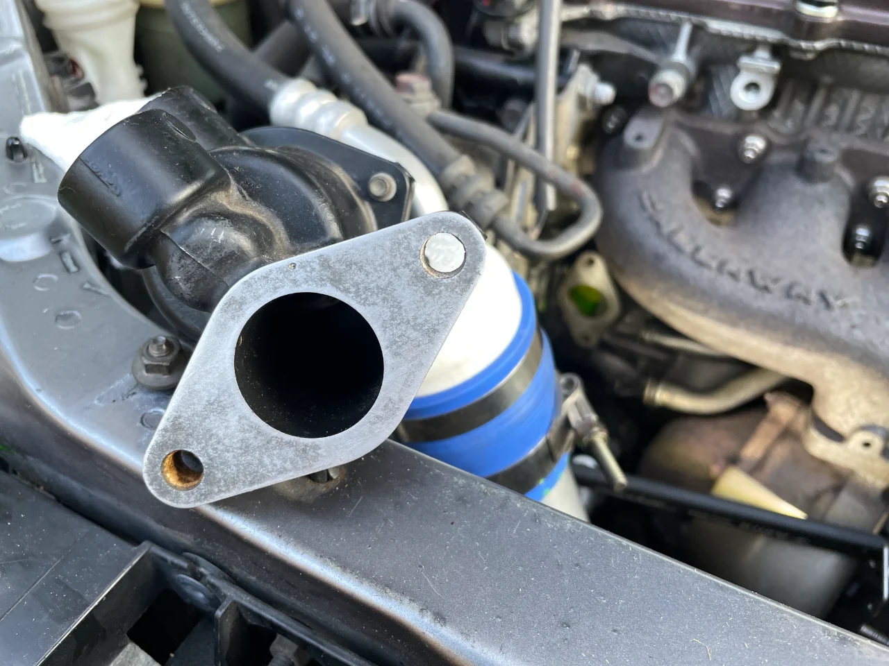

Is anyone still here? Finally replaced my radiator. @Gabe710 gave me his hand me down mishimoto radiator. Had a side quest of replacing the water neck gasket since I found a slow leak there 2-3 years ago. :cool:

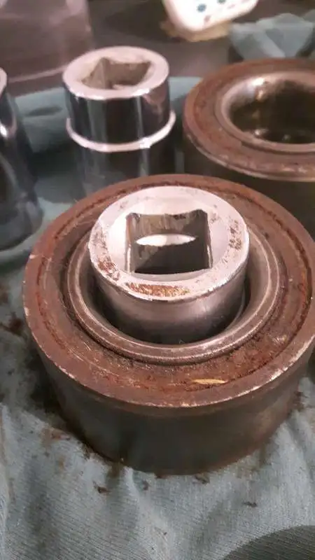

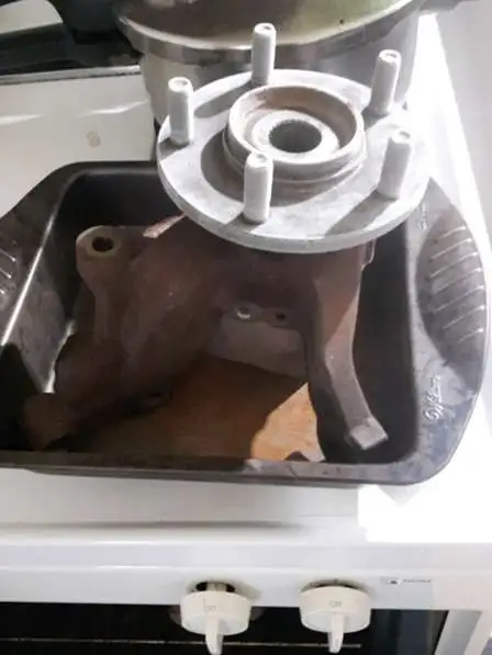

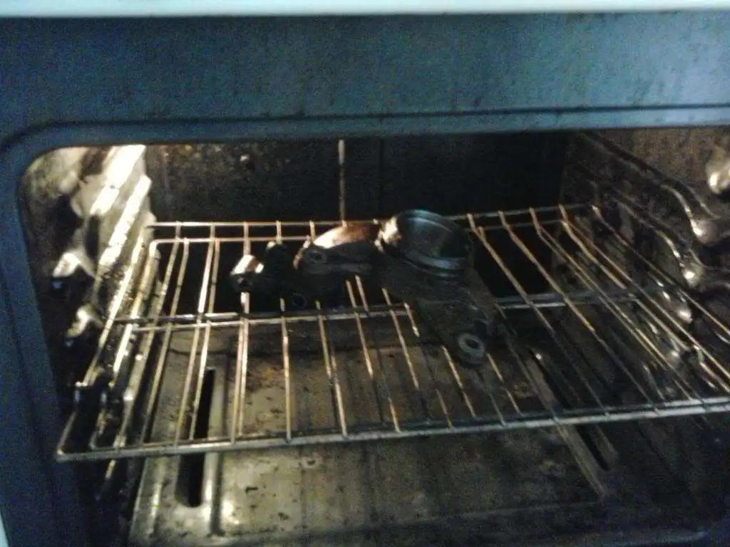

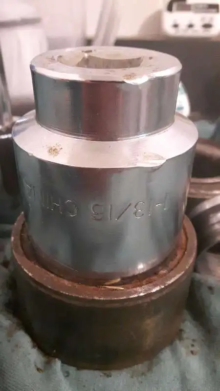

Planned on grabbing a hydraulic press from Harbor Freight to do my wheel bearings but they're fresh out of stock.
You don't need a hydraulic press.
Just a big socket set, a sledge hammer, a freezer, and an oven,..
Notice the dents in my socket,..
I missed a few times with my sledge hammer. 😂

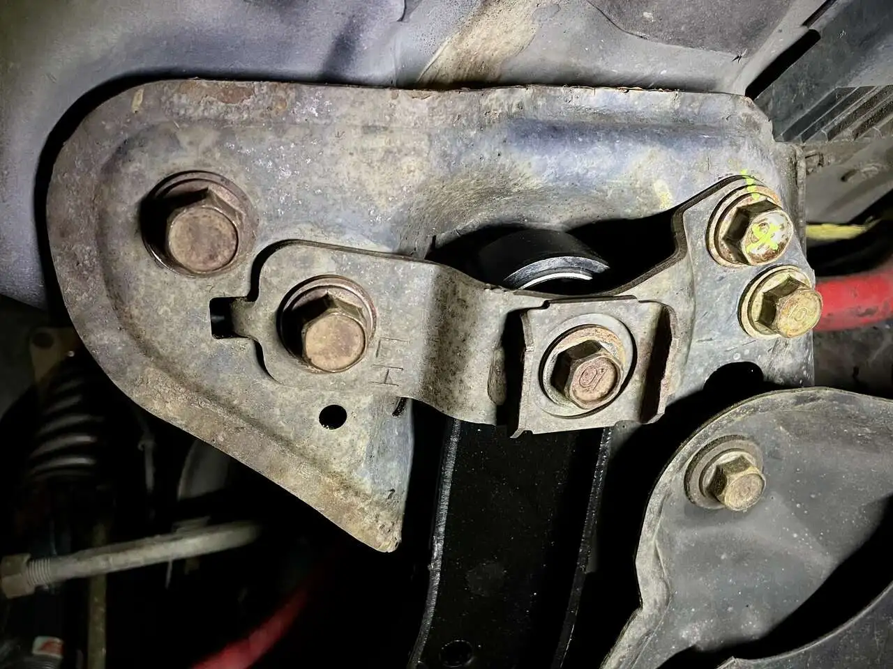

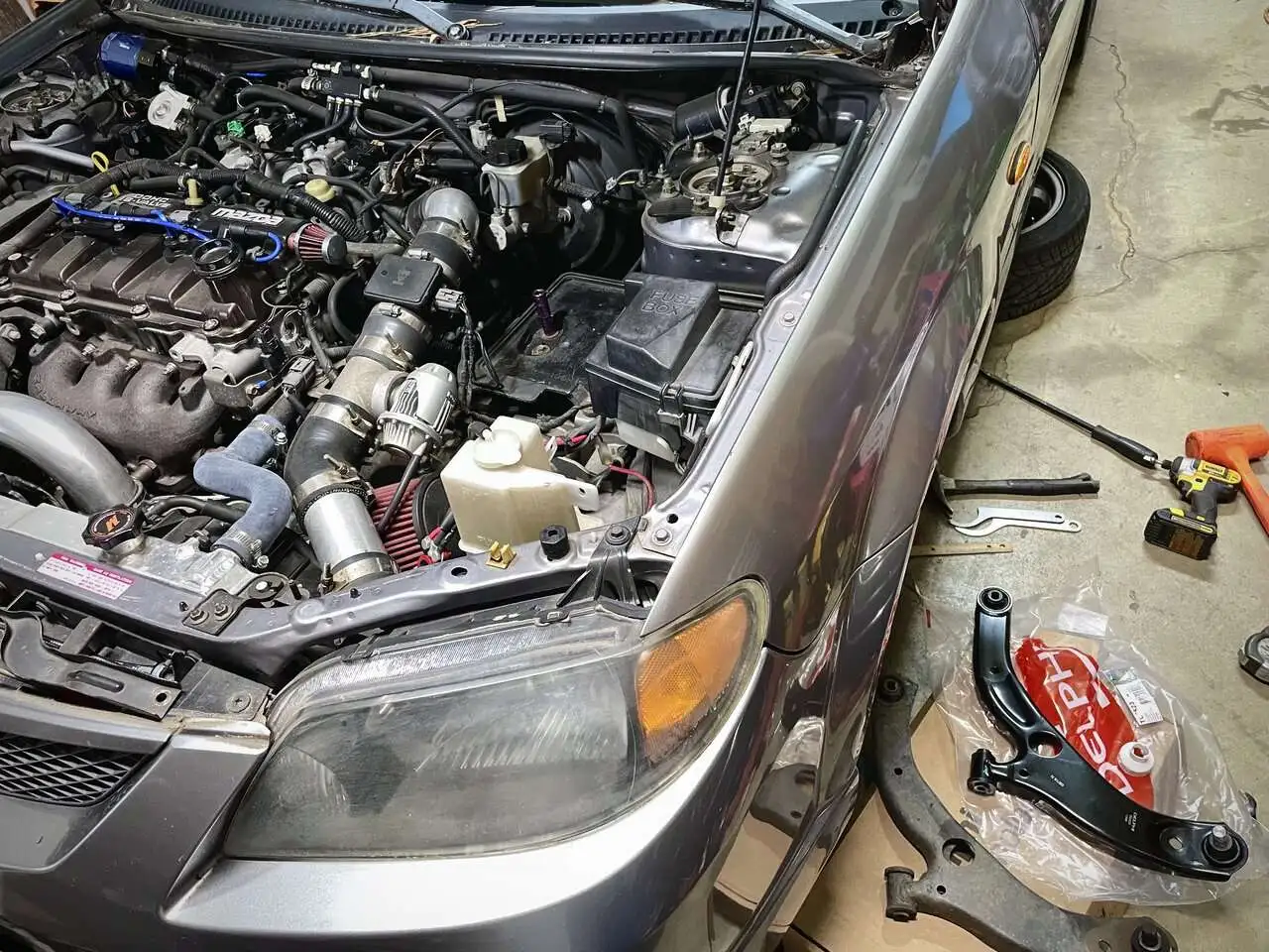

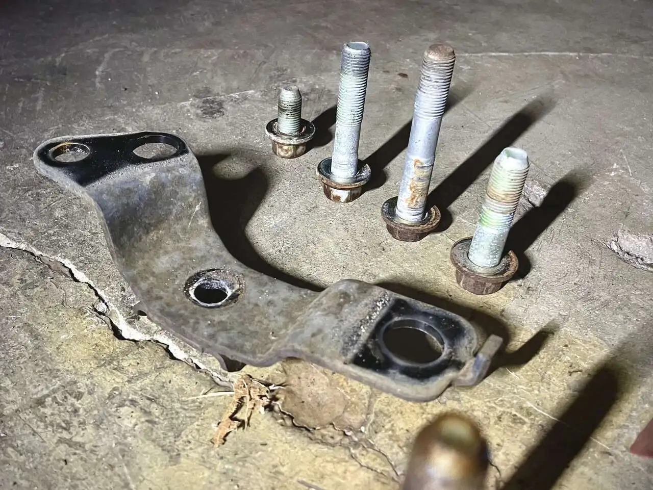

With a very weak battery that only gave a 3-4v reading, I jumped it only to have it cut off on me when I turned on my headlights out of habit. Luckily, jumping it a second time was easy peasy. Currently working on replacing LCAs which came out pretty easy. All hardware was able to be loosened using hand tools unlike some Subarus I know. Anyway, the ball joint boots are torn and very easily movable by hand and the rear bushings have seen better days. Not too bad for 130,000 something miles though I'd say. I've seen worse at lower mileage!
Managed to install the LCAs pretty quickly last night which only took about 30 minutes per side. Did run into a minor prank but I would say it's the best possible prank if that makes sense lol. One of the inaccessible/hidden nuts seems to have stripped or the welding came loose. Doesn't make much sense as everything came out and went back on pretty easily. Marked the affected bolt to see if it ever works itself out. I'm happy it's not spinning freely as I was only able to tighten it snug but not use a torque wrench on it. Luckily there is another bolt right next to it.
Discovered my battery was still under warranty. Nothing beats a free battery. Went for a test drive last night and immediately felt a big difference in steering response with the new LCA's despite my alignment being out of wack. Car hasn't felt like this in a very long time! I'll give it a string alignment and set the car aside for now to handle small repairs on other cars.

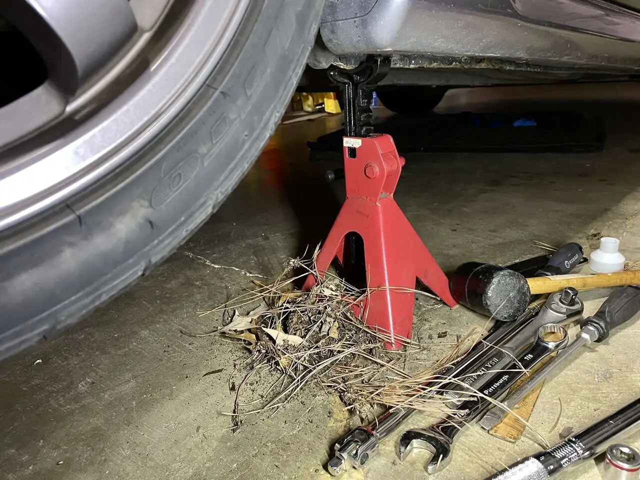

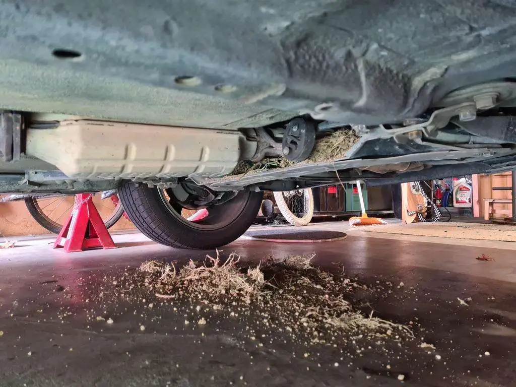

PSA: Clean out your fender liners! Here's about 5 years worth of debris.
Don't forget to clean out the front crossmember :D
